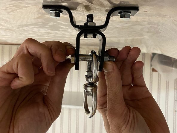

    • This is how the ceiling bag looks without the adjustments. No flexibility and sturdiness are the causes behind the noise.
    • This is an unsafe attachment of the bag to the ceiling mount. Too much pressure on the ceiling mount can lead to it breaking, therefore making the bag dangerous to its surroundings.

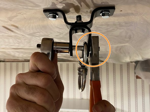

    • Using a wrench or a drive ratchet, remove the hex nut from the hex screw.
    • Hold the hex nut with a plier for better grip (this helps with unscrewing).

    • Reinsert the hex screw back into the ceiling mount. Place the Swivel Hook inside the hex screw.
    • The Swivel Hook should be attached/connected to the hex screw.

    • Tighten back the bolt screw onto the hex screw.
    • Using a plier and a drive ratchet, fully tighten the hex screw onto the hex nut.
