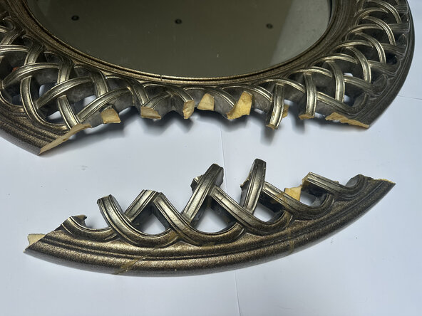

      • Gather all your broken frame pieces and gently clean off any dust or debris. Once the pieces are clean, arrange them to determine how they fit back into the damaged section. This will help you understand the order in which they need to be glued.

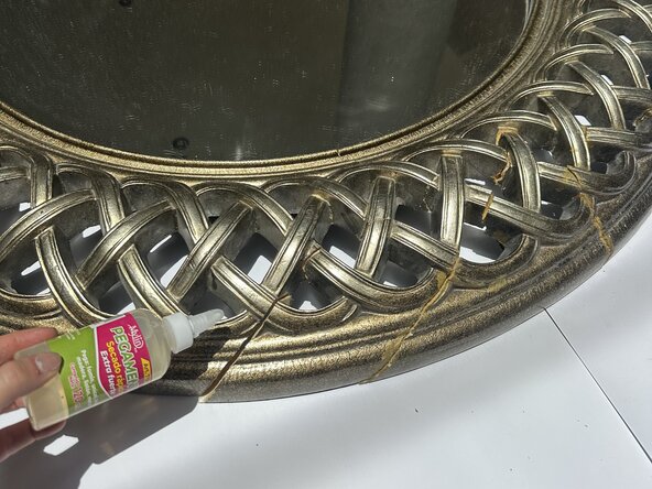

      • Once the pieces are arranged, apply a small amount of Gorilla Glue to the edges that need to be reattached. Press each piece firmly into place. Work slowly to make sure each section aligns with the original shape of the frame.
      • Caution: Gorilla Glue expands as it dries. Use sparingly to prevent overflow onto the visible surface.
    3. How to Fix a Mirror Frame: crwdns2935265:03crwdnd2935265:01crwdnd2935265:01crwdne2935265:0
      • Use tension bands (rubber bands or elastic straps) to hold the pieces tightly together while the glue cures. Place the bands so that they apply gentle, even pressure across the repaired area without pressing against the mirror glass. Let the glue dry according to the instructions on the adhesive bottle.
