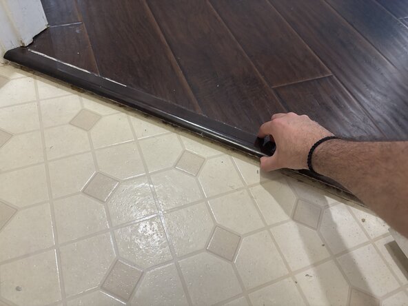

How to Fix a Loose Wooden Door Threshold
  1. How to Fix a Loose Wooden Door Threshold, How to Fix a Loose Wooden Door Threshold: crwdns2935265:01crwdnd2935265:01crwdnd2935265:03crwdne2935265:0 How to Fix a Loose Wooden Door Threshold, How to Fix a Loose Wooden Door Threshold: crwdns2935265:01crwdnd2935265:02crwdnd2935265:03crwdne2935265:0 How to Fix a Loose Wooden Door Threshold, How to Fix a Loose Wooden Door Threshold: crwdns2935265:01crwdnd2935265:03crwdnd2935265:03crwdne2935265:0
    • Use your hands to remove the door threshold.
    • Start lifting it from one of the two ends.

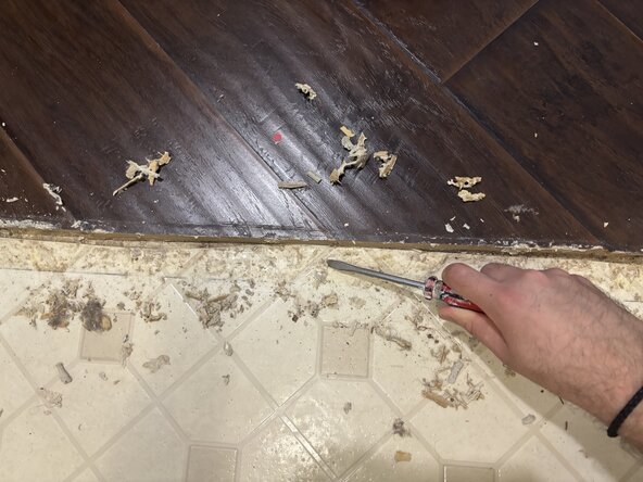

  2. How to Fix a Loose Wooden Door Threshold: crwdns2935265:02crwdnd2935265:01crwdnd2935265:03crwdne2935265:0 How to Fix a Loose Wooden Door Threshold: crwdns2935265:02crwdnd2935265:02crwdnd2935265:03crwdne2935265:0 How to Fix a Loose Wooden Door Threshold: crwdns2935265:02crwdnd2935265:03crwdnd2935265:03crwdne2935265:0
    • Use a paint scraper to remove the old wood glue and dirt that remains under the threshold.
    • Use a cloth to clean the area once you're done scraping off any leftover glue residue.

  4. How to Fix a Loose Wooden Door Threshold: crwdns2935265:04crwdnd2935265:01crwdnd2935265:03crwdne2935265:0 How to Fix a Loose Wooden Door Threshold: crwdns2935265:04crwdnd2935265:02crwdnd2935265:03crwdne2935265:0 How to Fix a Loose Wooden Door Threshold: crwdns2935265:04crwdnd2935265:03crwdnd2935265:03crwdne2935265:0
    • Place the threshold back in its original position.
    • Press down along the threshold for a few minutes to ensure it is secure.
  5. How to Fix a Loose Wooden Door Threshold: crwdns2935265:05crwdnd2935265:01crwdnd2935265:02crwdne2935265:0 How to Fix a Loose Wooden Door Threshold: crwdns2935265:05crwdnd2935265:02crwdnd2935265:02crwdne2935265:0
    • Place heavy books across the length of the threshold to keep the downward pressure while the wood glue dries.
    • Keep the heavy objects on the threshold for at least 6 hours to allow it to dry completely.
  6. How to Fix a Loose Wooden Door Threshold: crwdns2935265:06crwdnd2935265:01crwdnd2935265:01crwdne2935265:0
    • Using a paper towel or a cloth, clean the excess glue around the threshold.
    • You can lift the books one at a time to check for any excess glue and clean it.
After a few hours, remove the heavy books or other objects covering the threshold and check its stability. If it still feels wobbly, reapply or add glue to the loose area.
