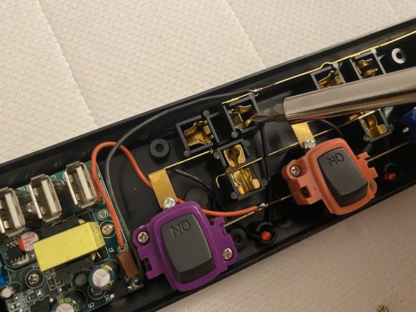

    • Locate two pairs of copper sheets for each socket.
  5. How to Fix a Loose Connection on a Power Strip: crwdns2935265:05crwdnd2935265:01crwdnd2935265:03crwdne2935265:0 How to Fix a Loose Connection on a Power Strip: crwdns2935265:05crwdnd2935265:02crwdnd2935265:03crwdne2935265:0 How to Fix a Loose Connection on a Power Strip: crwdns2935265:05crwdnd2935265:03crwdnd2935265:03crwdne2935265:0
    • Use a screwdriver to push the two copper sheets closer to each other. Do this on all the pairs of copper sheets without a solid connection.
