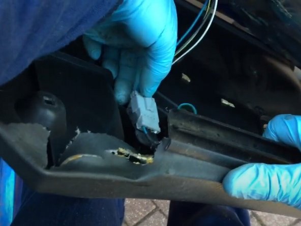

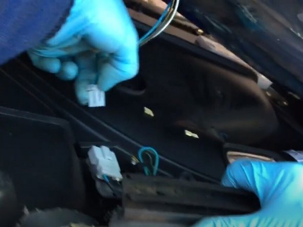

    • Use your fingers to disconnect any cables connecting the panel and the inside of the door.
    • Remove the panel from the door.

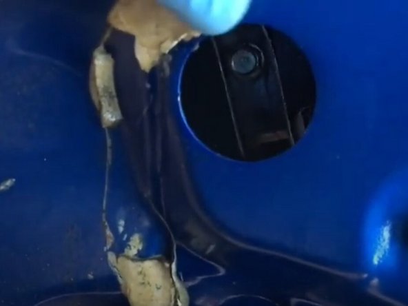

    • Remove the plastic cover from the inside of the door to access the interior mechanisms.

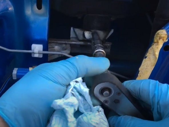

    • Use a socket wrench to loosen the bolt on the window mechanism.
    • Wipe any grease or debris from the window mechanism using a cloth.

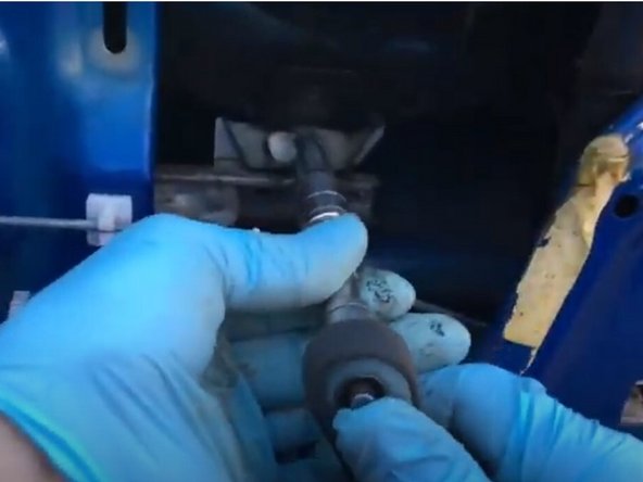

    • Use your hands to replace the window in the window clamp.
    • The window pane should fit between the two sides of the clamp.
    • Re-tighten the window clamp using a socket wrench.
    • If the window clamp does not hold the window tight enough, use polymer sealant to stick the window clamp and the glass together. Be sure to allow the sealant to set completely before trying to use the mechanism.

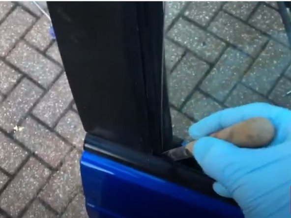

    • Slide a putty knife between the glass window panel and the rubber door seal.
    • Pry the rubber door seal outwards and position the window in the door channel.
