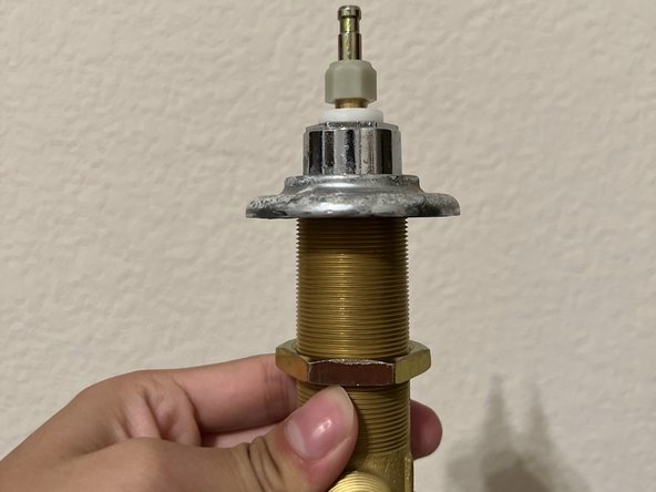

    • Turn off the central water valve. It is typically located outside.
    • Use a spudger or your fingers to remove the rubber plug, near the center of the faucet handle.
  2. How to Fix a Loose Bath Tub Faucet Handle: crwdns2935265:02crwdnd2935265:01crwdnd2935265:02crwdne2935265:0 How to Fix a Loose Bath Tub Faucet Handle: crwdns2935265:02crwdnd2935265:02crwdnd2935265:02crwdne2935265:0
    • Use a screwdriver to remove the screw inside the handle.
  3. How to Fix a Loose Bath Tub Faucet Handle: crwdns2935265:03crwdnd2935265:01crwdnd2935265:02crwdne2935265:0 How to Fix a Loose Bath Tub Faucet Handle: crwdns2935265:03crwdnd2935265:02crwdnd2935265:02crwdne2935265:0
    • Remove the faucet handle.
  4. How to Fix a Loose Bath Tub Faucet Handle: crwdns2935265:04crwdnd2935265:01crwdnd2935265:02crwdne2935265:0 How to Fix a Loose Bath Tub Faucet Handle: crwdns2935265:04crwdnd2935265:02crwdnd2935265:02crwdne2935265:0
    • Use a screwdriver to tighten the screw at the top of the internals of the handle.
    • When finished reassembling, turn on the water to check if the faucet handle still feels loose. If so, the faucet may need to be replaced.
