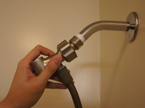

  3. How to Fix a Leaking Shower Head: crwdns2935265:03crwdnd2935265:01crwdnd2935265:03crwdne2935265:0 How to Fix a Leaking Shower Head: crwdns2935265:03crwdnd2935265:02crwdnd2935265:03crwdne2935265:0 How to Fix a Leaking Shower Head: crwdns2935265:03crwdnd2935265:03crwdnd2935265:03crwdne2935265:0
    • Place and hold one end of the tape on the threads at the end of the shower arm (the pipe coming out of the wall).
    • Teflon tape likes to stick to itself, so be careful not to let it fold over itself, or you'll be unfolding it all day.
    • While taking care to keep the tape flat, wrap it clockwise around the threads, completely covering them and wrapping back over itself to stick.
    • Be sure to wrap the tape clockwise, so that as you tighten the showerhead it won't unravel the tape.
  4. How to Fix a Leaking Shower Head: crwdns2935265:04crwdnd2935265:01crwdnd2935265:03crwdne2935265:0 How to Fix a Leaking Shower Head: crwdns2935265:04crwdnd2935265:02crwdnd2935265:03crwdne2935265:0 How to Fix a Leaking Shower Head: crwdns2935265:04crwdnd2935265:03crwdnd2935265:03crwdne2935265:0
    • Thread the showerhead back onto the shower arm.
    • Spin it on a few times to get it hand tight.

  6. How to Fix a Leaking Shower Head: crwdns2935265:06crwdnd2935265:01crwdnd2935265:01crwdne2935265:0
    • The tape is replaced! However this may not have solved your problem. If the showerhead still leaks from the joint with the shower arm, there may be dirt or debris in the joint, or damaged threads on the shower arm.
    • Try tightening the showerhead a little more with your wrench, or reapplying teflon tape to ensure a good layer.
