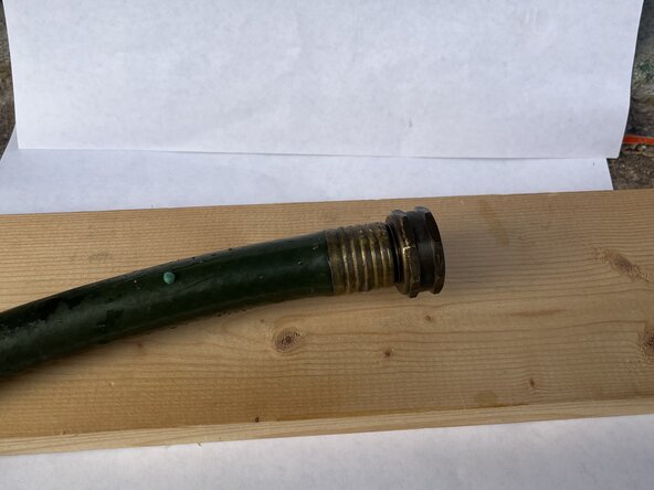

    • Disconnect the hose and place the end on a stable surface.

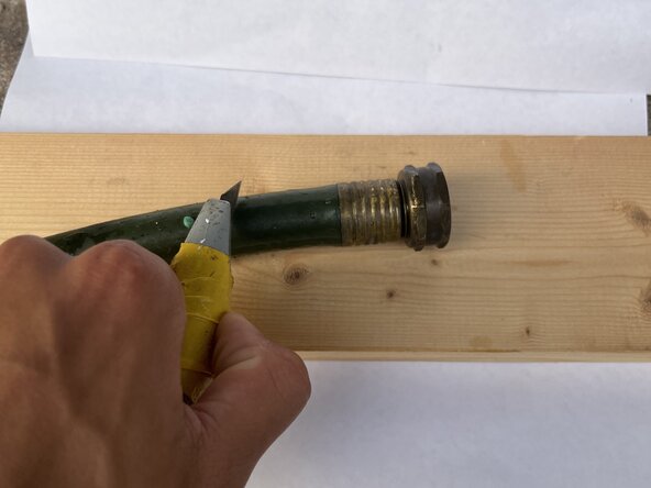

  2. How to Fix a Leaking Garden Hose Connector: crwdns2935265:02crwdnd2935265:01crwdnd2935265:02crwdne2935265:0 How to Fix a Leaking Garden Hose Connector: crwdns2935265:02crwdnd2935265:02crwdnd2935265:02crwdne2935265:0
    • Hold the hose down against the surface and use the utility knife to cut the hose about two to three inches away from the old connector.
    • Be careful cutting through the hose as the utility knife is very sharp and the hose is thick.
