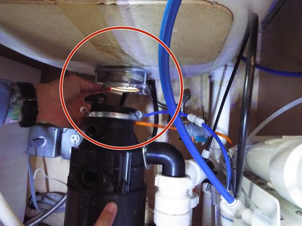

    • Remove the three screws from the flange at the top of the garbage disposal unit. These screws are at the top right above the black disposal box.
    • Disconnect the lock-nut at the flange.
    • Adequate lighting is imperative for this step.
  4. How to Fix a Leaking Garbage Disposal at Flange: crwdns2935265:04crwdnd2935265:01crwdnd2935265:02crwdne2935265:0 How to Fix a Leaking Garbage Disposal at Flange: crwdns2935265:04crwdnd2935265:02crwdnd2935265:02crwdne2935265:0
    • Use the screwdriver to turn the locking ring counter clock-wise, disengaging the drain hose and disposal.
    • You will be able to hear the locking ring come undone after pushing it forcefully to the left.
    • The disposal will drop down—be sure to catch the disposal and place on the bottom of the sink.

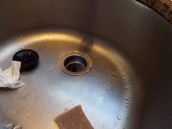

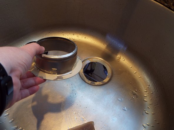

    • To remove the flange, push from underneath the sink with one hand and pull it out through the top of the sink with your other hand.
    • Scrape off ALL excess putty from the flange and the sink.

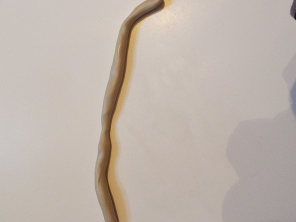

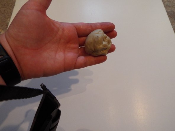

    • Remove a small ball of putty and roll into a golf ball shape.
    • Roll the putty flat into a snakelike shape, approximately 3/4 inch diameter.
    • Be sure that the putty is long enough to wrap completely around the flange.

    • Wrap the putty around the flange and place the flange back into the sink.
    • Press down hard into the sink and remove any excess Plumber's Putty.
