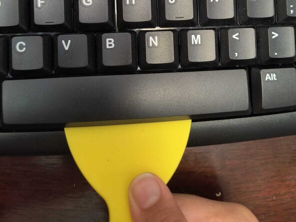

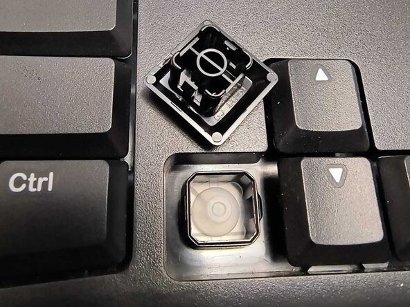

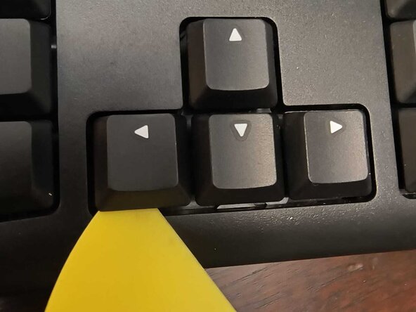

    • Gently remove the keycap using a keycap puller/screwdriver/nylon spudger, or a plastic opening tool. Inspect for dirt, dust, or misalignment.
    • Avoid using excessive force to prevent damage.
  3. How to Fix a Jammed Key on a Logitech K120: crwdns2935265:03crwdnd2935265:01crwdnd2935265:01crwdne2935265:0
    • Clean the area under the key using compressed air, a microfiber cloth, or a cotton swab for detailed cleaning.

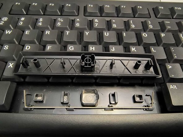

  4. How to Fix a Jammed Key on a Logitech K120: crwdns2935265:04crwdnd2935265:01crwdnd2935265:03crwdne2935265:0 How to Fix a Jammed Key on a Logitech K120: crwdns2935265:04crwdnd2935265:02crwdnd2935265:03crwdne2935265:0 How to Fix a Jammed Key on a Logitech K120: crwdns2935265:04crwdnd2935265:03crwdnd2935265:03crwdne2935265:0
    • Examine the stabilizer and ensure it is properly attached.

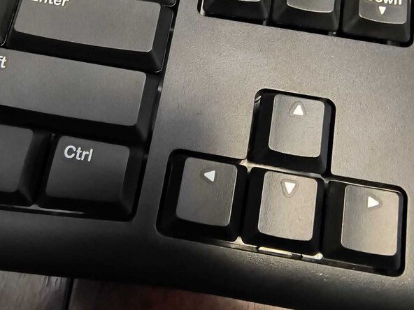

    • Reattach the keycap by aligning it properly and pressing it down firmly but gently to avoid damaging the switch.

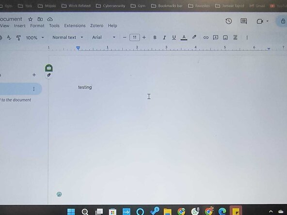

  7. How to Fix a Jammed Key on a Logitech K120: crwdns2935265:07crwdnd2935265:01crwdnd2935265:02crwdne2935265:0 How to Fix a Jammed Key on a Logitech K120: crwdns2935265:07crwdnd2935265:02crwdnd2935265:02crwdne2935265:0
    • Test the key’s functionality by typing in a text editor or keyboard tester to ensure proper response. If the issue persists, repeat cleaning steps.
