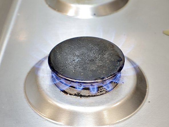

How to Fix a Gas Stove With Uneven Firing

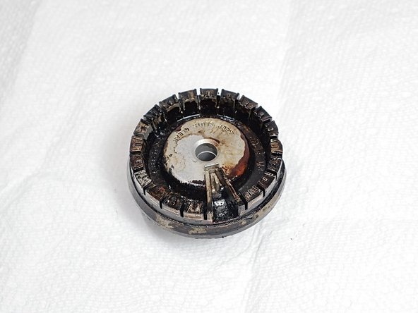

    • Remember to wear gloves.
    • Remove the burner cap from the stove.
    • Remove the burner head from the stove.
    • Place both components on a paper towel to prevent staining the surface.

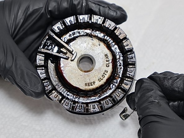

  2. How to Fix a Gas Stove With Uneven Firing: crwdns2935265:02crwdnd2935265:01crwdnd2935265:02crwdne2935265:0 How to Fix a Gas Stove With Uneven Firing: crwdns2935265:02crwdnd2935265:02crwdnd2935265:02crwdne2935265:0
    • Use a safety pin or toothpick to clean oily residue from the gaps between the separators.

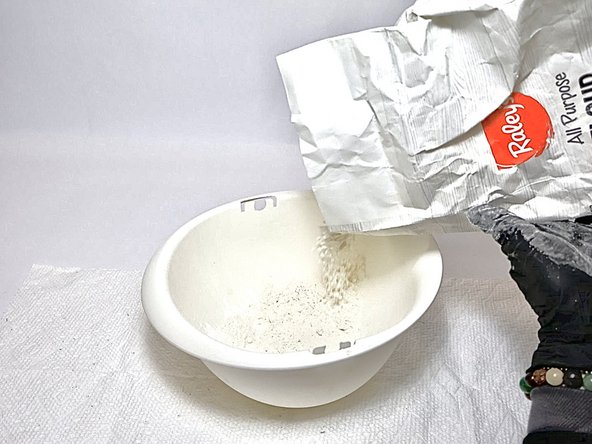

  3. How to Fix a Gas Stove With Uneven Firing: crwdns2935265:03crwdnd2935265:01crwdnd2935265:02crwdne2935265:0 How to Fix a Gas Stove With Uneven Firing: crwdns2935265:03crwdnd2935265:02crwdnd2935265:02crwdne2935265:0
    • Pour the flour, white vinegar, and baking soda into a bowl.
    • Make sure the bowl is not used for eating because the next steps may stain the bowl.
    • Wear a mask to avoid getting smoked by the odor from the chemical reaction.

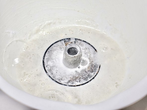

  4. How to Fix a Gas Stove With Uneven Firing: crwdns2935265:04crwdnd2935265:01crwdnd2935265:01crwdne2935265:0
    • Pour hot water into the bowl and let the chemical reaction occur.
  5. How to Fix a Gas Stove With Uneven Firing: crwdns2935265:05crwdnd2935265:01crwdnd2935265:02crwdne2935265:0 How to Fix a Gas Stove With Uneven Firing: crwdns2935265:05crwdnd2935265:02crwdnd2935265:02crwdne2935265:0
    • Put the gas stove burner into the bowl.
    • Soak the gas stove burner for 5 minutes.

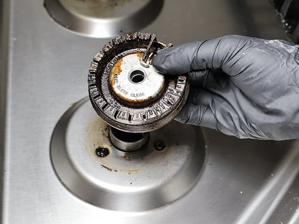

  7. How to Fix a Gas Stove With Uneven Firing: crwdns2935265:07crwdnd2935265:01crwdnd2935265:02crwdne2935265:0 How to Fix a Gas Stove With Uneven Firing: crwdns2935265:07crwdnd2935265:02crwdnd2935265:02crwdne2935265:0
    • Put the gas stove burner back on the stove.
If the residue on the separator has not been removed, you can repeat the process. You can increase the concentration of the liquid, reduce the volume of hot water, or soak it for a longer time to achieve better decontamination results.
