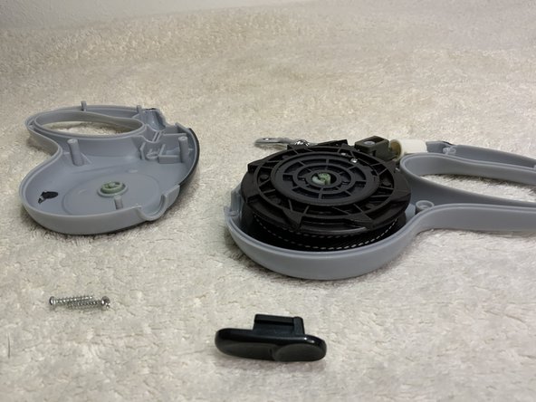

    • Start by removing all the 5.0 mm screws from the leash with the Phillips #0 screwdriver.
  3. How to Fix a Flexi Leash: crwdns2935265:03crwdnd2935265:01crwdnd2935265:03crwdne2935265:0 How to Fix a Flexi Leash: crwdns2935265:03crwdnd2935265:02crwdnd2935265:03crwdne2935265:0 How to Fix a Flexi Leash: crwdns2935265:03crwdnd2935265:03crwdnd2935265:03crwdne2935265:0

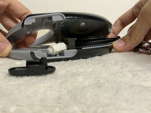

    • Using a plastic opening tool, begin to separate the top and bottom of the leash.
    • Make sure to press lightly to prevent unwanted marks.
    • It is most likely that the brake button will fall out. Place small items to the side to prevent it from being lost or undetected.

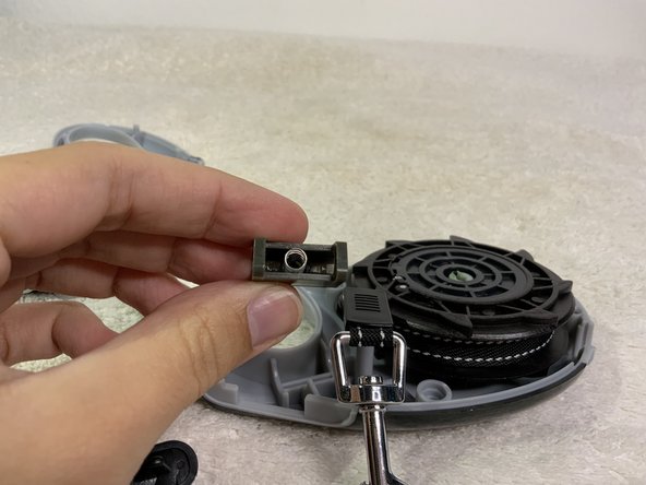

    • Carefully remove the brake mechanism. Inside should be a small spring.
    • Remove and replace the spring with a new one.
    • When placing the break mechanism back into its place, make sure the spring is positioned right in the middle.
