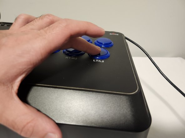

This guide will walk you through how you can fix a faulty button on a Mayflash F300 arcade stick.
Oftentimes, buttons on arcade sticks can get finicky and unresponsive after months or years of use. This is because of things like dust and dirt, which slowly gather underneath the buttons as time goes on. That is why it is important to clean them every once in a while, so that the buttons can function without any issues.
Make sure to have the Mayflash F300 unplugged before beginning this guide.
  1. How to Fix a Faulty Button on a Mayflash F300, How to Fix a Faulty Button on a Mayflash F300: crwdns2935265:01crwdnd2935265:01crwdnd2935265:02crwdne2935265:0 How to Fix a Faulty Button on a Mayflash F300, How to Fix a Faulty Button on a Mayflash F300: crwdns2935265:01crwdnd2935265:02crwdnd2935265:02crwdne2935265:0
    • Flip around the Mayflash F300, so that the metal panel is facing you.
    • It may be helpful to place the device on a box if you cannot hold it, as the joystick would otherwise be under pressure.

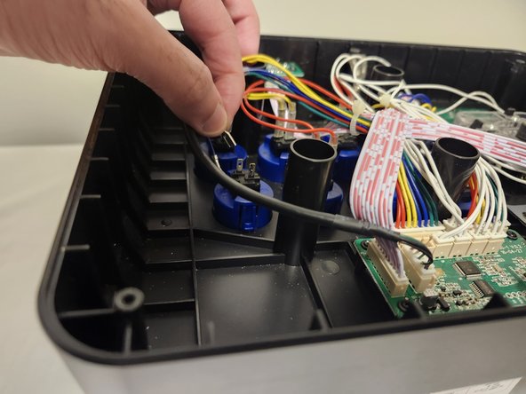

  2. How to Fix a Faulty Button on a Mayflash F300: crwdns2935265:02crwdnd2935265:01crwdnd2935265:03crwdne2935265:0 How to Fix a Faulty Button on a Mayflash F300: crwdns2935265:02crwdnd2935265:02crwdnd2935265:03crwdne2935265:0 How to Fix a Faulty Button on a Mayflash F300: crwdns2935265:02crwdnd2935265:03crwdnd2935265:03crwdne2935265:0
    • Unscrew the six 9 mm Phillips #00 screws that hold together the metal panel.
    • Gently pry the panel away once it is unscrewed.
  3. How to Fix a Faulty Button on a Mayflash F300: crwdns2935265:03crwdnd2935265:01crwdnd2935265:02crwdne2935265:0 How to Fix a Faulty Button on a Mayflash F300: crwdns2935265:03crwdnd2935265:02crwdnd2935265:02crwdne2935265:0
    • Unplug the two cables going into the button you wish to clean or replace.
    • These two cables can be quite stubborn to remove, so gently wiggling them as you pull will make it easier.
  4. How to Fix a Faulty Button on a Mayflash F300: crwdns2935265:04crwdnd2935265:01crwdnd2935265:01crwdne2935265:0
    • Squeeze the two tabs that are on either side of the button and push it out.
  5. How to Fix a Faulty Button on a Mayflash F300: crwdns2935265:05crwdnd2935265:01crwdnd2935265:01crwdne2935265:0
    • Grab your toothbrush and clean out all the dirt you may find inside and around the button.
    • Alternatively, if you wish to install an entirely new button, you can simply set aside the old one.
  6. How to Fix a Faulty Button on a Mayflash F300: crwdns2935265:06crwdnd2935265:01crwdnd2935265:02crwdne2935265:0 How to Fix a Faulty Button on a Mayflash F300: crwdns2935265:06crwdnd2935265:02crwdnd2935265:02crwdne2935265:0
    • With your button now clean and ready to go, place it in the empty slot and push it back down. Make sure it snaps in place.
  7. How to Fix a Faulty Button on a Mayflash F300: crwdns2935265:07crwdnd2935265:01crwdnd2935265:01crwdne2935265:0
    • Reconnect the two cables to the button.
  8. How to Fix a Faulty Button on a Mayflash F300: crwdns2935265:08crwdnd2935265:01crwdnd2935265:01crwdne2935265:0
    • Take the back panel of the arcade stick and screw it back in place.
