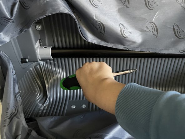

    • Before you begin, determine which tool is best to use for tapping out the dent, as this depends on the size of the dent. For this guide, the handle of a screwdriver was used, but a soft mallet would work well too.
  2. How to Fix a Dent in a Hardside Suitcase: crwdns2935265:02crwdnd2935265:01crwdnd2935265:01crwdne2935265:0
    • Use the hair dryer on the dented area for a duration of 3 minutes.
    • Move the hair dryer around the dented area to avoid heat damage to your suitcase. Wear heat-resistant gloves and check the area periodically to ensure it is not overheating.
  3. How to Fix a Dent in a Hardside Suitcase: crwdns2935265:03crwdnd2935265:01crwdnd2935265:02crwdne2935265:0 How to Fix a Dent in a Hardside Suitcase: crwdns2935265:03crwdnd2935265:02crwdnd2935265:02crwdne2935265:0
    • Open the suitcase and use a screwdriver handle or soft mallet to tap out the dent about 3-5 times.
    • The screwdriver is being used to shape the dent back to its original shape towards the outside of the luggage.
  4. How to Fix a Dent in a Hardside Suitcase: crwdns2935265:04crwdnd2935265:01crwdnd2935265:01crwdne2935265:0
    • Use a hair dryer to apply heat to the dented area for 1-3 minutes, moving the heat over the area in a circular motion.
    • This will soften the suitcase material so it's easier to tap out the dent.
  5. How to Fix a Dent in a Hardside Suitcase: crwdns2935265:05crwdnd2935265:01crwdnd2935265:01crwdne2935265:0
    • Use a screwdriver handle or soft mallet to tap the dent back to the original shape or as close to it as possible. Hit the dent using your tool about 4-6 times.
  6. How to Fix a Dent in a Hardside Suitcase: crwdns2935265:06crwdnd2935265:01crwdnd2935265:01crwdne2935265:0
    • The process is complete and the suitcase is back to its normal shape and can be used!
