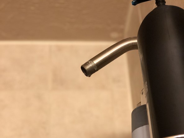

      • Unscrew the head of the shower from the pipe with a pipe wrench.
      • While using the pipe wrench, make sure not to clamp it too tight because it will crack the plastic.
    2. How to Fix a Delta 5-Function Showerhead Model 75554: crwdns2935265:02crwdnd2935265:01crwdnd2935265:02crwdne2935265:0 How to Fix a Delta 5-Function Showerhead Model 75554: crwdns2935265:02crwdnd2935265:02crwdnd2935265:02crwdne2935265:0
      • Fill a large bowl with equal parts hot water and white distilled vinegar to get rid of hard water build up.
    3. How to Fix a Delta 5-Function Showerhead Model 75554: crwdns2935265:03crwdnd2935265:01crwdnd2935265:02crwdne2935265:0 How to Fix a Delta 5-Function Showerhead Model 75554: crwdns2935265:03crwdnd2935265:02crwdnd2935265:02crwdne2935265:0
      • With the tip of a pocketknife, pick out the rubber, black washer in the attachment.
      • Using your fingertips press a new 1" black rubber washer into the head attachment. The new washer will allow water to flow correctly with more pressure.
      • Pocketknives can be very very sharp!
    4. How to Fix a Delta 5-Function Showerhead Model 75554: crwdns2935265:04crwdnd2935265:01crwdnd2935265:02crwdne2935265:0 How to Fix a Delta 5-Function Showerhead Model 75554: crwdns2935265:04crwdnd2935265:02crwdnd2935265:02crwdne2935265:0
      • Wipe down with shower pipe with a hot water and vinegar soaked scrub brush.
    5. How to Fix a Delta 5-Function Showerhead Model 75554: crwdns2935265:05crwdnd2935265:01crwdnd2935265:02crwdne2935265:0 How to Fix a Delta 5-Function Showerhead Model 75554: crwdns2935265:05crwdnd2935265:02crwdnd2935265:02crwdne2935265:0
      • Wrap Teflon tape around the legs of the spout about 3 times to ensure that it will screw on tight when the head is put back on.
      • Now is the time to take the shower head out of the vinegar water.
    6. How to Fix a Delta 5-Function Showerhead Model 75554: crwdns2935265:06crwdnd2935265:01crwdnd2935265:03crwdne2935265:0 How to Fix a Delta 5-Function Showerhead Model 75554: crwdns2935265:06crwdnd2935265:02crwdnd2935265:03crwdne2935265:0 How to Fix a Delta 5-Function Showerhead Model 75554: crwdns2935265:06crwdnd2935265:03crwdnd2935265:03crwdne2935265:0
      • Twist the shower head back onto the pipe and tighten it with the pipe wrench.
