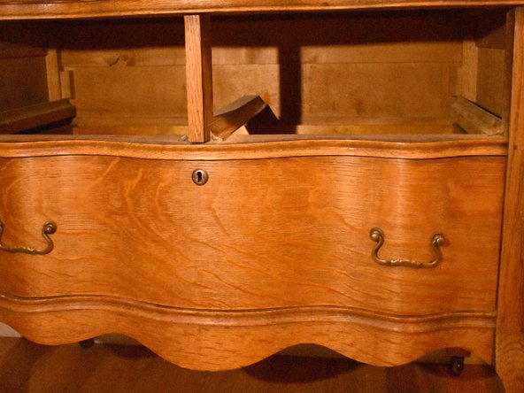

    • Empty out your drawer and pull it completely out of the dresser.
  2. How to Fix a Broken Wood Dresser Track: crwdns2935265:02crwdnd2935265:01crwdnd2935265:01crwdne2935265:0
    • Clean the runner with a damp cloth to remove debris.

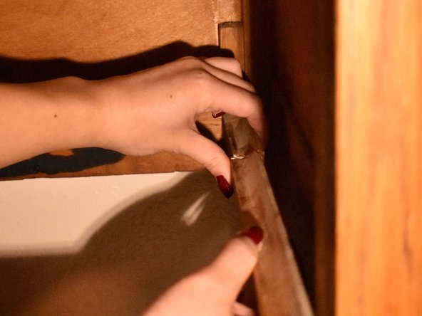

    • Apply the wood glue to both of the broken ends and join them together.

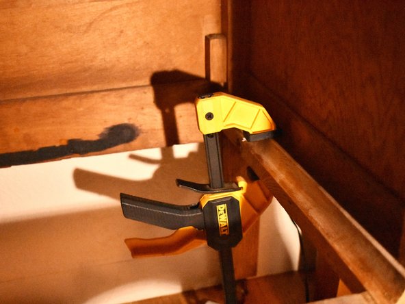

    • Secure the pieces with a clamp until the glue dries completely.

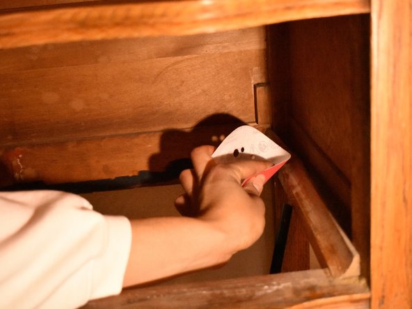

    • Use sandpaper to sand off any excess glue.

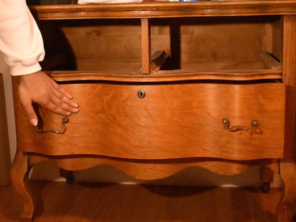

    • Place your drawer back into the dresser to ensure that the drawer slides smoothly.
