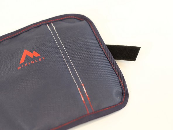

  1. How to Fix a Broken Seam in a Camping Chair, Identify the repair area: crwdns2935265:01crwdnd2935265:01crwdnd2935265:03crwdne2935265:0 How to Fix a Broken Seam in a Camping Chair, Identify the repair area: crwdns2935265:01crwdnd2935265:02crwdnd2935265:03crwdne2935265:0 How to Fix a Broken Seam in a Camping Chair, Identify the repair area: crwdns2935265:01crwdnd2935265:03crwdnd2935265:03crwdne2935265:0
    • Locate the broken seam that needs to be fixed.

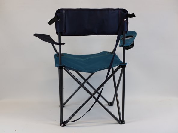

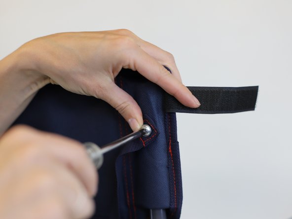

  2. How to Fix a Broken Seam in a Camping Chair, Unscrew the back of the chair: crwdns2935265:02crwdnd2935265:01crwdnd2935265:03crwdne2935265:0 How to Fix a Broken Seam in a Camping Chair, Unscrew the back of the chair: crwdns2935265:02crwdnd2935265:02crwdnd2935265:03crwdne2935265:0 How to Fix a Broken Seam in a Camping Chair, Unscrew the back of the chair: crwdns2935265:02crwdnd2935265:03crwdnd2935265:03crwdne2935265:0
    • Use a screwdriver to disassemble the back support and set aside the screws and remaining parts.

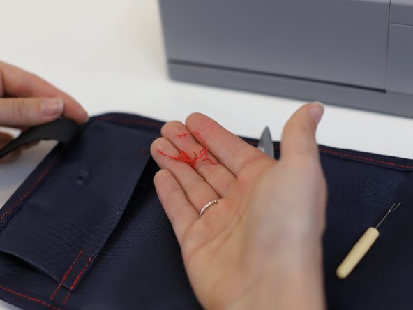

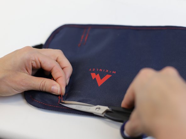

  3. How to Fix a Broken Seam in a Camping Chair, Clean the area: crwdns2935265:03crwdnd2935265:01crwdnd2935265:03crwdne2935265:0 How to Fix a Broken Seam in a Camping Chair, Clean the area: crwdns2935265:03crwdnd2935265:02crwdnd2935265:03crwdne2935265:0 How to Fix a Broken Seam in a Camping Chair, Clean the area: crwdns2935265:03crwdnd2935265:03crwdnd2935265:03crwdne2935265:0
    • Using a pair of scissors and a "seam ripper" remove the loose threads.

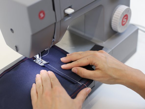

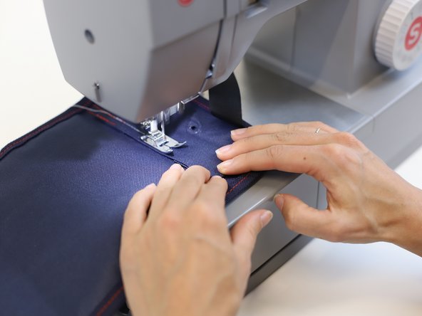

  4. How to Fix a Broken Seam in a Camping Chair, Start sewing: crwdns2935265:04crwdnd2935265:01crwdnd2935265:03crwdne2935265:0 How to Fix a Broken Seam in a Camping Chair, Start sewing: crwdns2935265:04crwdnd2935265:02crwdnd2935265:03crwdne2935265:0 How to Fix a Broken Seam in a Camping Chair, Start sewing: crwdns2935265:04crwdnd2935265:03crwdnd2935265:03crwdne2935265:0
    • Sew along the "dotted line" following the direction of the red arrow. This is the path where the previous stitch used to be.
    • Note: in this example, the original seam used to have 2 lines of stitches, this is why a second line of stitches is needed to reinforce the area.

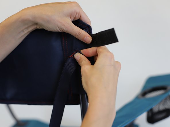

  6. How to Fix a Broken Seam in a Camping Chair, Reassemble the chair: crwdns2935265:06crwdnd2935265:01crwdnd2935265:03crwdne2935265:0 How to Fix a Broken Seam in a Camping Chair, Reassemble the chair: crwdns2935265:06crwdnd2935265:02crwdnd2935265:03crwdne2935265:0 How to Fix a Broken Seam in a Camping Chair, Reassemble the chair: crwdns2935265:06crwdnd2935265:03crwdnd2935265:03crwdne2935265:0
    • Start by putting the components back, first the repaired fabric and then the rest of the parts.
    • Tip: make sure the holes in the metal part of the chair match the holes of the fabric (orange circles).
    • Screw back the pieces that were taken on the previous steps.
