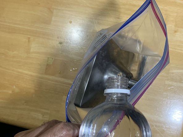

    • Add water to a plastic freezer bag, then add the shower head to the bag.
    • Add about one cup of distilled white vinegar to the plastic bag. Seal the plastic bag, and let the shower head rest for about two hours.
    • Depending on the severity of the mineral deposits, you can let the showerhead rest in the solution for up to 8 hours.
    • Be careful when using distilled white vinegar as it can leave stains; also, be careful when pouring it, as it can cause damage if the solution gets into your eye.

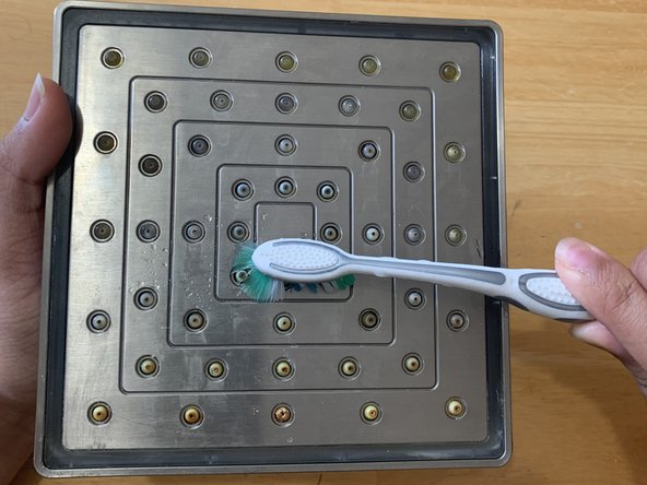

    • Use a soft bristle brush to clear mineral deposits stuck to cones or on the shower head.

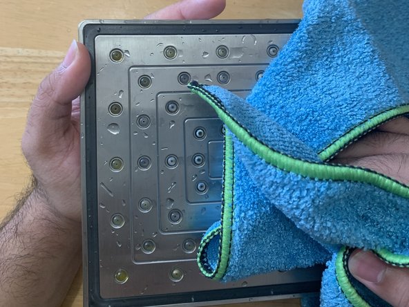

    • Use a microfiber cloth to brush and dry without streaking on the steel.

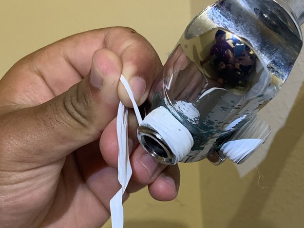

    • Use a 1/2 inch piece of thread seal tape to wrap around the bracket nozzle; go clockwise when wrapping to follow the circular indents in the nozzle.
    • The sealing tape is necessary to keep water pressure tight and prevent leakage.

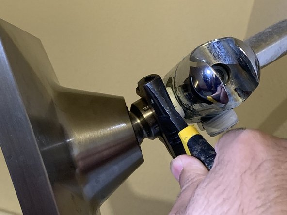

    • Using the 6-inch Wrench, get a grip on the showerhead bracket.
    • Using counter-clockwise motion with the wrench, tighten the bracket onto the nozzle.
    • When the shower head is back on the nozzle, turn on the hot water to remove any leftover vinegar and any other minerals from the inside.
