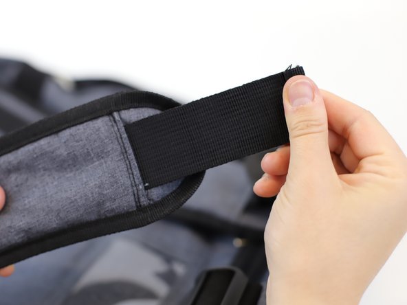

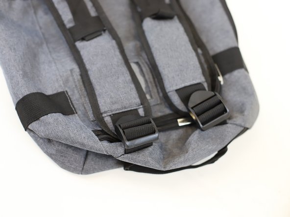

  2. How to Fix a Broken Backpack strap, Assess the damage: crwdns2935265:02crwdnd2935265:01crwdnd2935265:02crwdne2935265:0 How to Fix a Broken Backpack strap, Assess the damage: crwdns2935265:02crwdnd2935265:02crwdnd2935265:02crwdne2935265:0
    • Check if the current broken strap can be fixed or if it needs to be replaced.
    • Note: In this repair we will use the existing strap, without replacing it with a new one.

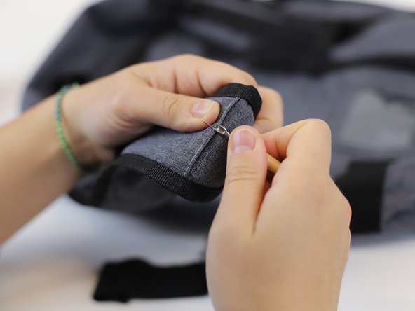

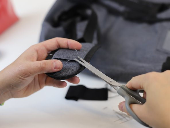

  3. How to Fix a Broken Backpack strap, Clean the area: crwdns2935265:03crwdnd2935265:01crwdnd2935265:03crwdne2935265:0 How to Fix a Broken Backpack strap, Clean the area: crwdns2935265:03crwdnd2935265:02crwdnd2935265:03crwdne2935265:0 How to Fix a Broken Backpack strap, Clean the area: crwdns2935265:03crwdnd2935265:03crwdnd2935265:03crwdne2935265:0
    • Use a pair of scissors and seam ripper to clean the strap of any loose threads.
    • Note: After cleaning the area, use the seam ripper to open the seam of the thick padding, leaving a hole for the strap piece to be reinserted later.

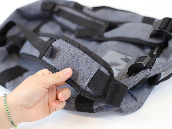

  4. How to Fix a Broken Backpack strap, Fix the strap in place: crwdns2935265:04crwdnd2935265:01crwdnd2935265:03crwdne2935265:0 How to Fix a Broken Backpack strap, Fix the strap in place: crwdns2935265:04crwdnd2935265:02crwdnd2935265:03crwdne2935265:0 How to Fix a Broken Backpack strap, Fix the strap in place: crwdns2935265:04crwdnd2935265:03crwdnd2935265:03crwdne2935265:0
    • Once you have finished cleaning the area, introduce the thin part of the strap into the thick strap padding.
    • Use a sewing pin to fix the part in place.

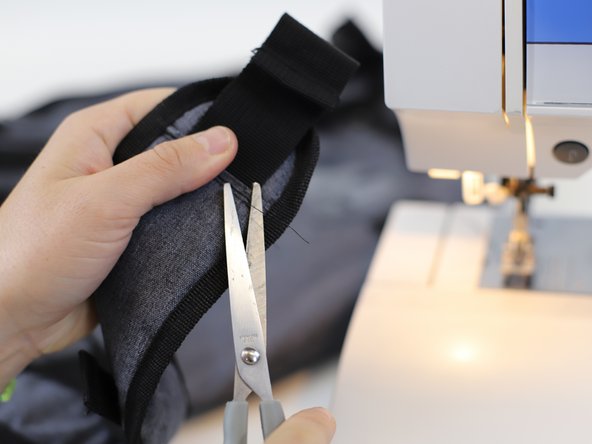

  5. How to Fix a Broken Backpack strap, Start sewing: crwdns2935265:05crwdnd2935265:01crwdnd2935265:03crwdne2935265:0 How to Fix a Broken Backpack strap, Start sewing: crwdns2935265:05crwdnd2935265:02crwdnd2935265:03crwdne2935265:0 How to Fix a Broken Backpack strap, Start sewing: crwdns2935265:05crwdnd2935265:03crwdnd2935265:03crwdne2935265:0
    • Use a sewing machine to stitch the strap in place.
    • Clean the area of any loose threads using a pair of scissors.

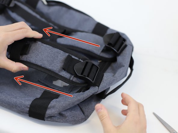

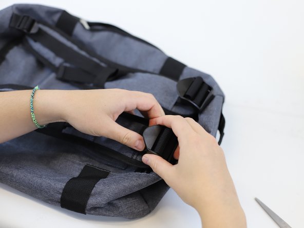

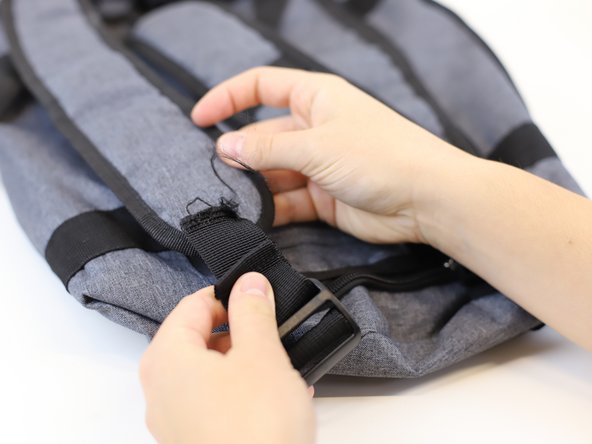

  6. How to Fix a Broken Backpack strap, Test the repair: crwdns2935265:06crwdnd2935265:01crwdnd2935265:03crwdne2935265:0 How to Fix a Broken Backpack strap, Test the repair: crwdns2935265:06crwdnd2935265:02crwdnd2935265:03crwdne2935265:0 How to Fix a Broken Backpack strap, Test the repair: crwdns2935265:06crwdnd2935265:03crwdnd2935265:03crwdne2935265:0
    • Check if the fix works by introducing the strap in the existing buckle.
    • Following the direction of the red arrows, pull the strap to test if the stitched part is strong enough to hold.
    • Tip: If you think it does not feel firm enough, you can add a second row of stitches to reinforce the area.

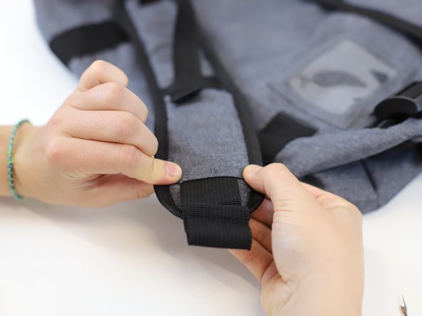

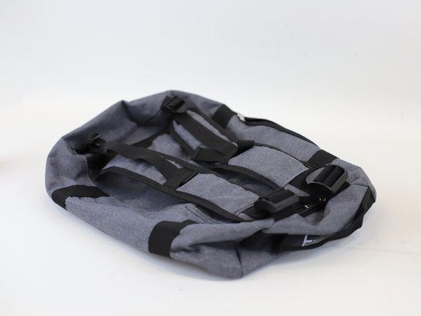

  7. How to Fix a Broken Backpack strap, Finished and ready!: crwdns2935265:07crwdnd2935265:01crwdnd2935265:03crwdne2935265:0 How to Fix a Broken Backpack strap, Finished and ready!: crwdns2935265:07crwdnd2935265:02crwdnd2935265:03crwdne2935265:0 How to Fix a Broken Backpack strap, Finished and ready!: crwdns2935265:07crwdnd2935265:03crwdnd2935265:03crwdne2935265:0
    • 🛠️🏆👏 Congratulations! The repair is complete, and you're ready to go!
