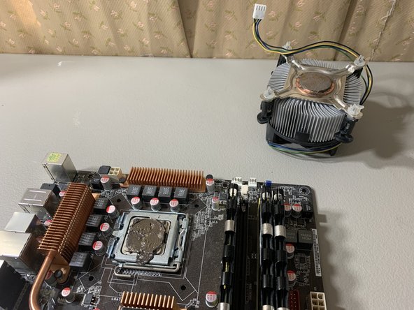

    • Now, if you have an Intel Cooling Fan, turn the four pins on the CPU cooler counterclockwise.
    • Then pull all four pins to remove the CPU cooler off the motherboard.
    • If you have a different cooler, or an aftermarket cooler, read your manual for your other cooler to see how to properly remove the cooler.
  4. How to Fix a Bent Intel CPU Socket Pin: crwdns2935265:04crwdnd2935265:01crwdnd2935265:02crwdne2935265:0 How to Fix a Bent Intel CPU Socket Pin: crwdns2935265:04crwdnd2935265:02crwdnd2935265:02crwdne2935265:0
    • Now remove the CPU cooler off your motherboard, and place the cooler aside.
  5. How to Fix a Bent Intel CPU Socket Pin: crwdns2935265:05crwdnd2935265:01crwdnd2935265:03crwdne2935265:0 How to Fix a Bent Intel CPU Socket Pin: crwdns2935265:05crwdnd2935265:02crwdnd2935265:03crwdne2935265:0 How to Fix a Bent Intel CPU Socket Pin: crwdns2935265:05crwdnd2935265:03crwdnd2935265:03crwdne2935265:0

    • As you can see, there are a few bent pins in the CPU socket. It it a bit hard to see the pins since they are very tiny. So, you'll need a needle or any tool to fix the pins in the right directions.
    • Use a needle and gently bend the CPU pins in the right direction where the other CPU pins are facing.
    • Carefully move the pins direction where they are meant to face, because the pins are very fragile.
