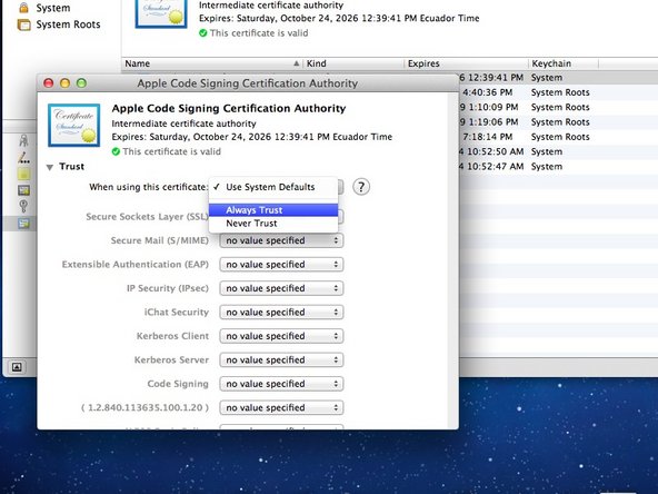

  3. How to Fix Year and Model in About this Mac, Fixing Issue With Keychain: crwdns2935265:03crwdnd2935265:01crwdnd2935265:01crwdne2935265:0
    • In order to fix this issue, we have to use Keychain.
    • Open Keychain by searching for it using Spotlight.
    • This will NOT make Apple's Website load, some versions of OS X are still too old to even load Apple's Website. This only allows the Mac to connect to Apple's Server, even if it can't load the webpage.
  4. How to Fix Year and Model in About this Mac: crwdns2935265:04crwdnd2935265:01crwdnd2935265:02crwdne2935265:0 How to Fix Year and Model in About this Mac: crwdns2935265:04crwdnd2935265:02crwdnd2935265:02crwdne2935265:0

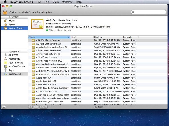

    • In the sidebar, you will see "Certificates." Click that.
    • You will also see "System Roots." Click that as well.
    • A lot of certificates will show up.
  5. How to Fix Year and Model in About this Mac: crwdns2935265:05crwdnd2935265:01crwdnd2935265:01crwdne2935265:0

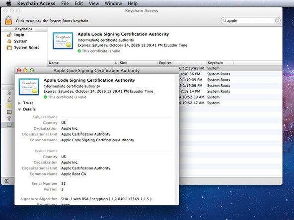

    • Type "apple" in the search bar.
  6. How to Fix Year and Model in About this Mac: crwdns2935265:06crwdnd2935265:01crwdnd2935265:02crwdne2935265:0 How to Fix Year and Model in About this Mac: crwdns2935265:06crwdnd2935265:02crwdnd2935265:02crwdne2935265:0
    • Now click on the first Certificate, and then click the "i" button in the bottom of the window.
    • Another window will appear.
  7. How to Fix Year and Model in About this Mac: crwdns2935265:07crwdnd2935265:01crwdnd2935265:03crwdne2935265:0 How to Fix Year and Model in About this Mac: crwdns2935265:07crwdnd2935265:02crwdnd2935265:03crwdne2935265:0 How to Fix Year and Model in About this Mac: crwdns2935265:07crwdnd2935265:03crwdnd2935265:03crwdne2935265:0

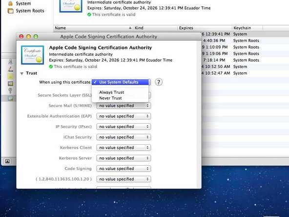

    • In the window that pops up, click the "Trust" tab.
    • Then click the box "When using this certificate." It will say "Use System Defaults" by default.
    • Now choose "Always Trust" instead.

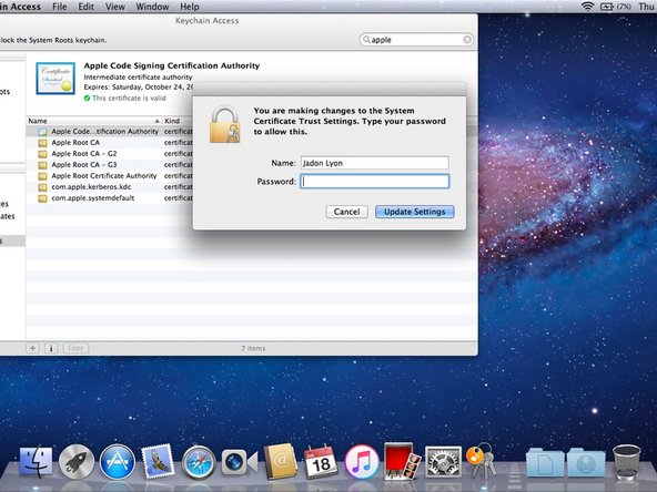

  8. How to Fix Year and Model in About this Mac: crwdns2935265:08crwdnd2935265:01crwdnd2935265:02crwdne2935265:0 How to Fix Year and Model in About this Mac: crwdns2935265:08crwdnd2935265:02crwdnd2935265:02crwdne2935265:0
    • Close the window and enter your username and password to allow.
  9. How to Fix Year and Model in About this Mac: crwdns2935265:09crwdnd2935265:01crwdnd2935265:01crwdne2935265:0
    • Now repeat steps 5-7 for the rest of Apple's Certificates.
    • Your Mac may have more or less certificates than in the picture. This is fine.
    • Make sure you are only modifying Apple's Certificates. Modifying Third Party Certificates can lead to issues.

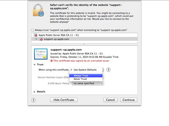

  11. How to Fix Year and Model in About this Mac, Forcing a New Certificate: crwdns2935265:011crwdnd2935265:01crwdnd2935265:01crwdne2935265:0
    • If for some reason About this Mac still does not show the year, do not worry. There is one other thing you can do. You can force the Mac to make a new certificate.
    • To do this, click the "Support" tab in About this Mac.
    • Then choose "User Manual."
  12. How to Fix Year and Model in About this Mac: crwdns2935265:012crwdnd2935265:01crwdnd2935265:02crwdne2935265:0 How to Fix Year and Model in About this Mac: crwdns2935265:012crwdnd2935265:02crwdnd2935265:02crwdne2935265:0

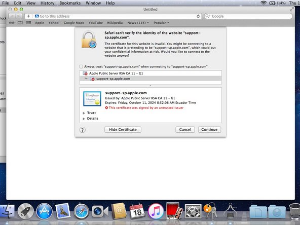

    • A Safari window will open with a new error.
    • Click the "Show Certificate" button.
  13. How to Fix Year and Model in About this Mac: crwdns2935265:013crwdnd2935265:01crwdnd2935265:02crwdne2935265:0 How to Fix Year and Model in About this Mac: crwdns2935265:013crwdnd2935265:02crwdnd2935265:02crwdne2935265:0
    • Similar to before, choose "Trust,"
    • "When using this certificate,"
    • "Always Trust."

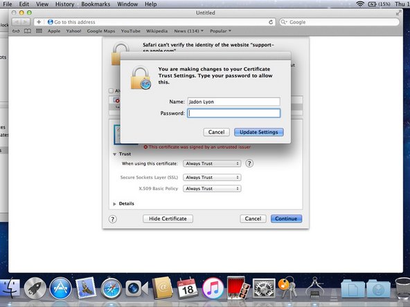

  14. How to Fix Year and Model in About this Mac: crwdns2935265:014crwdnd2935265:01crwdnd2935265:02crwdne2935265:0 How to Fix Year and Model in About this Mac: crwdns2935265:014crwdnd2935265:02crwdnd2935265:02crwdne2935265:0
    • Click Continue,
    • and enter your username and password to allow.
  15. How to Fix Year and Model in About this Mac: crwdns2935265:015crwdnd2935265:01crwdnd2935265:01crwdne2935265:0
    • Like I mentioned earlier, the webpage will not load even after forcing a new certificate.
  16. How to Fix Year and Model in About this Mac, Check Your Work Again: crwdns2935265:016crwdnd2935265:01crwdnd2935265:01crwdne2935265:0
    • Close all of the windows (including About this Mac).
    • Now open About this Mac again, and it should show you your Mac's year and model.
    • My Mac is a MacBook Air Early 2008 (Original)
