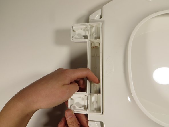

  2. How to Fix Wobbly Toilet Seat Hinges: crwdns2935265:02crwdnd2935265:01crwdnd2935265:03crwdne2935265:0 How to Fix Wobbly Toilet Seat Hinges: crwdns2935265:02crwdnd2935265:02crwdnd2935265:03crwdne2935265:0 How to Fix Wobbly Toilet Seat Hinges: crwdns2935265:02crwdnd2935265:03crwdnd2935265:03crwdne2935265:0
    • Place your toilet seat upside-down on a flat surface.
    • Locate the hinge assembly towards the back of the toilet seat.
    • Your toilet seat might have a plastic covering over the hinge assembly. If so, simply pry it off with your fingers and set it aside for re-installation later.

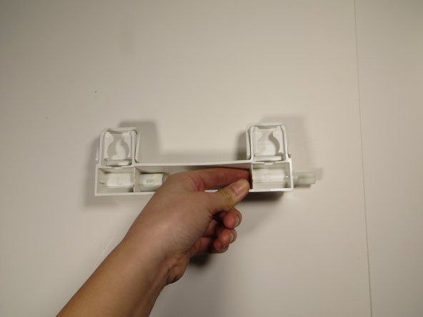

  3. How to Fix Wobbly Toilet Seat Hinges: crwdns2935265:03crwdnd2935265:01crwdnd2935265:02crwdne2935265:0 How to Fix Wobbly Toilet Seat Hinges: crwdns2935265:03crwdnd2935265:02crwdnd2935265:02crwdne2935265:0
    • Locate the cylindrical dampers on either side of the hinge assembly.

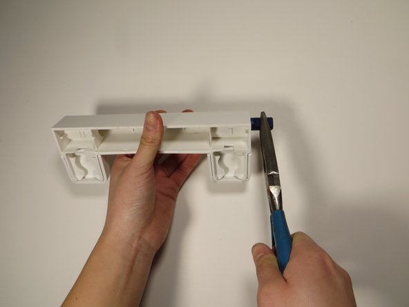

    • Using your needle-nose pliers, pinch one of the dampers and pull it halfway out of its compartment, or until the damper no longer connects the hinge assembly to the toilet seat.
    • Do the same to the other damper.
    • With both dampers still in their compartments, remove the hinge assembly from the toilet seat.

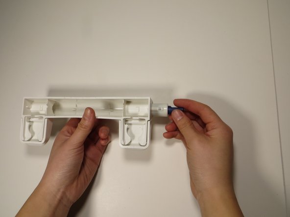

  4. How to Fix Wobbly Toilet Seat Hinges: crwdns2935265:04crwdnd2935265:01crwdnd2935265:03crwdne2935265:0 How to Fix Wobbly Toilet Seat Hinges: crwdns2935265:04crwdnd2935265:02crwdnd2935265:03crwdne2935265:0 How to Fix Wobbly Toilet Seat Hinges: crwdns2935265:04crwdnd2935265:03crwdnd2935265:03crwdne2935265:0

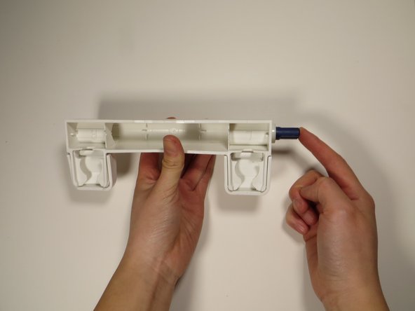

    • Place the hinge assembly upside-down on a flat surface.
    • Remove one of the dampers by pushing it out of its compartment with your finger.
    • Do the same for the other damper.
  5. How to Fix Wobbly Toilet Seat Hinges: crwdns2935265:05crwdnd2935265:01crwdnd2935265:03crwdne2935265:0 How to Fix Wobbly Toilet Seat Hinges: crwdns2935265:05crwdnd2935265:02crwdnd2935265:03crwdne2935265:0 How to Fix Wobbly Toilet Seat Hinges: crwdns2935265:05crwdnd2935265:03crwdnd2935265:03crwdne2935265:0
    • Hold one of the dampers by the smaller end.
    • Examine the damper for notches or markings. Some dampers have a set of notches, or arrows, that indicate "Slow/fast". If your dampers have markers like this, use them to determine how far back you want to rotate your dampers.
    • Some dampers have no notches or markings; if this is the case, you will have to guess at how far back to rotate them. You may need to repeat this step a few times to perfect the tightness of your dampers.
    • If there is only one set of notches on the damper, it can not be adjusted.
    • Once you have determined how far back to rotate your damper, insert the large end of the damper back into the hinge assembly, leaving the small end sticking out. This will make it easier to rotate the small end of the damper.

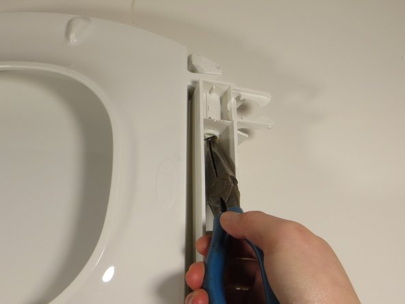

  6. How to Fix Wobbly Toilet Seat Hinges: crwdns2935265:06crwdnd2935265:01crwdnd2935265:02crwdne2935265:0 How to Fix Wobbly Toilet Seat Hinges: crwdns2935265:06crwdnd2935265:02crwdnd2935265:02crwdne2935265:0
    • Grip your needle-nose pliers in one hand and the hinge assembly in the other.
    • Pinch the protruding end of the damper with the needle-nose pliers and twist, rotating it in the direction of the plastic hinge covers. Rotate the dampers until they reach the level of tension you determined in Step 5.
    • Repeat steps 5-6 with the other damper.

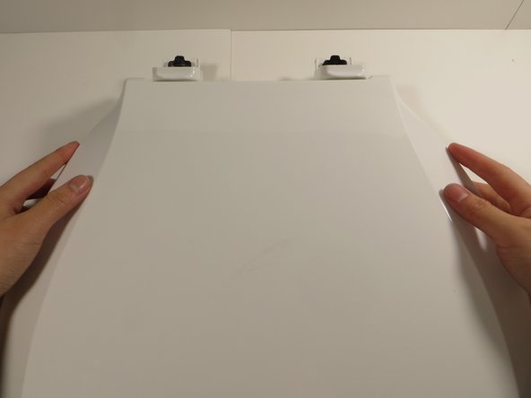

  7. How to Fix Wobbly Toilet Seat Hinges: crwdns2935265:07crwdnd2935265:01crwdnd2935265:03crwdne2935265:0 How to Fix Wobbly Toilet Seat Hinges: crwdns2935265:07crwdnd2935265:02crwdnd2935265:03crwdne2935265:0 How to Fix Wobbly Toilet Seat Hinges: crwdns2935265:07crwdnd2935265:03crwdnd2935265:03crwdne2935265:0
    • Place the hinge assembly back into the toilet seat with the holes aligned.
    • Re-insert the damper, small-end first, with your fingers. You should be able to feel the damper sliding into the hinge hole in the toilet seat.
    • If you removed a plastic cover from the hinge assembly, snap it back into place.
    • With the hinge assembly and toilet seat re-assembled, pick the entire toilet seat back up and align it with the bolts on your toilet bowl.
    • Push straight forward, until the hinges audibly click back into place.
    • Finally, close the plastic hinge covers.
