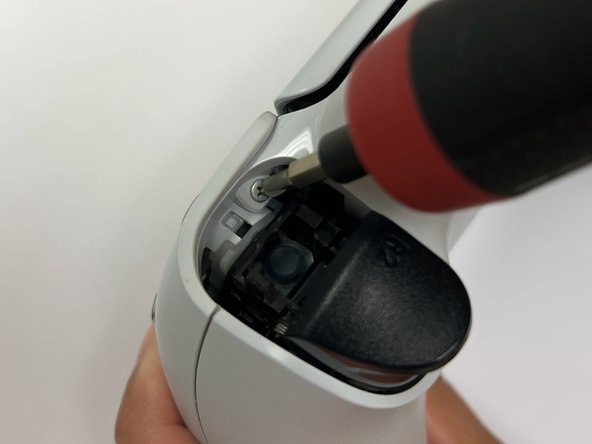

    • Remove the top right and left 6.4 mm screws using a Phillips #00 screwdriver.

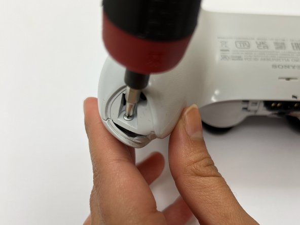

    • Remove the bottom right and left 6.4 mm screws using a Phillips #00 screwdriver.

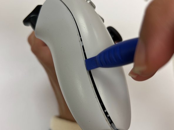

    • Insert the opening tool in between the sides to open the case.

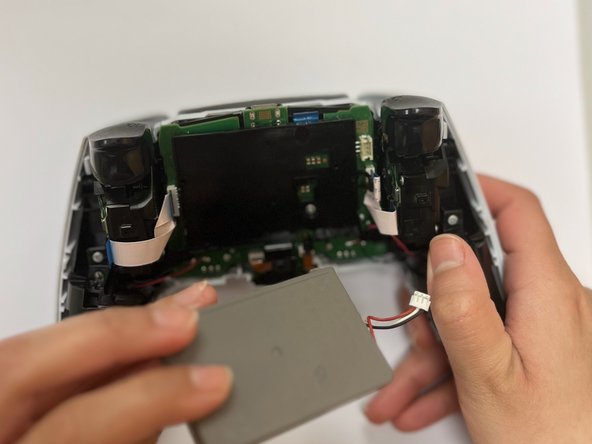

  10. How to Fix Stick Drift for a PlayStation Dualsense Controller V1: crwdns2935265:010crwdnd2935265:01crwdnd2935265:03crwdne2935265:0 How to Fix Stick Drift for a PlayStation Dualsense Controller V1: crwdns2935265:010crwdnd2935265:02crwdnd2935265:03crwdne2935265:0 How to Fix Stick Drift for a PlayStation Dualsense Controller V1: crwdns2935265:010crwdnd2935265:03crwdnd2935265:03crwdne2935265:0

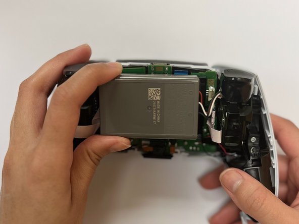

    • Using a pair of tweezers or your fingers, disconnect the battery from the motherboard.
  11. How to Fix Stick Drift for a PlayStation Dualsense Controller V1: crwdns2935265:011crwdnd2935265:01crwdnd2935265:03crwdne2935265:0 How to Fix Stick Drift for a PlayStation Dualsense Controller V1: crwdns2935265:011crwdnd2935265:02crwdnd2935265:03crwdne2935265:0 How to Fix Stick Drift for a PlayStation Dualsense Controller V1: crwdns2935265:011crwdnd2935265:03crwdnd2935265:03crwdne2935265:0

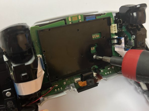

    • Use tweezers or your fingers to pull the orange ribbon.
    • Remove the 6.4 mm screw using a Phillips #00 screwdriver.
    • Lift the battery bracket.

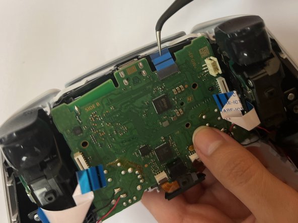

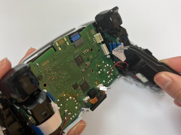

  12. How to Fix Stick Drift for a PlayStation Dualsense Controller V1: crwdns2935265:012crwdnd2935265:01crwdnd2935265:03crwdne2935265:0 How to Fix Stick Drift for a PlayStation Dualsense Controller V1: crwdns2935265:012crwdnd2935265:02crwdnd2935265:03crwdne2935265:0 How to Fix Stick Drift for a PlayStation Dualsense Controller V1: crwdns2935265:012crwdnd2935265:03crwdnd2935265:03crwdne2935265:0

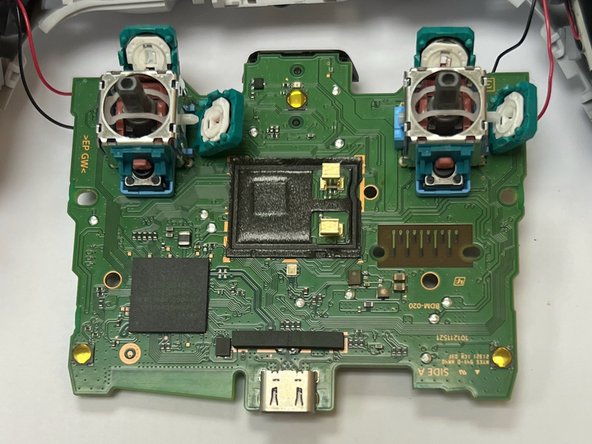

    • Use tweezers or your fingers to detach the four ribbons from the motherboard.
  13. How to Fix Stick Drift for a PlayStation Dualsense Controller V1: crwdns2935265:013crwdnd2935265:01crwdnd2935265:02crwdne2935265:0 How to Fix Stick Drift for a PlayStation Dualsense Controller V1: crwdns2935265:013crwdnd2935265:02crwdnd2935265:02crwdne2935265:0
    • Guide the joysticks through the front case and lift the motherboard.
  14. How to Fix Stick Drift for a PlayStation Dualsense Controller V1: crwdns2935265:014crwdnd2935265:01crwdnd2935265:03crwdne2935265:0 How to Fix Stick Drift for a PlayStation Dualsense Controller V1: crwdns2935265:014crwdnd2935265:02crwdnd2935265:03crwdne2935265:0 How to Fix Stick Drift for a PlayStation Dualsense Controller V1: crwdns2935265:014crwdnd2935265:03crwdnd2935265:03crwdne2935265:0

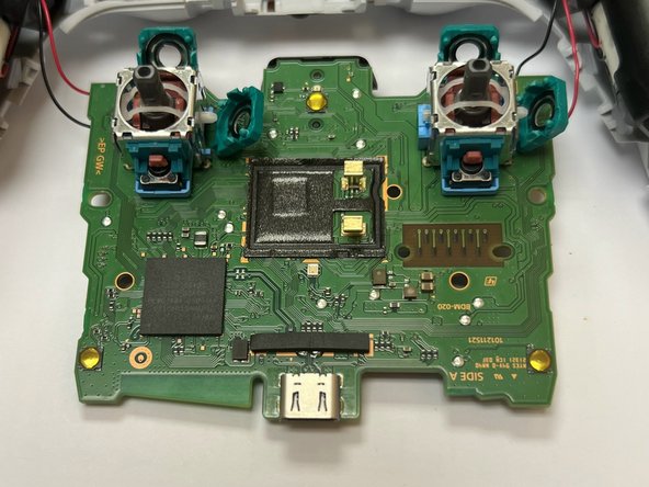

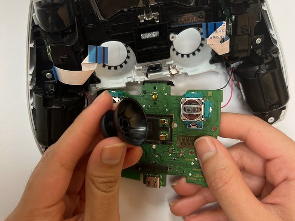

    • Remove the joystick covers by pulling straight off.

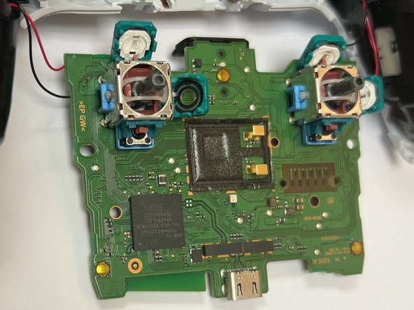

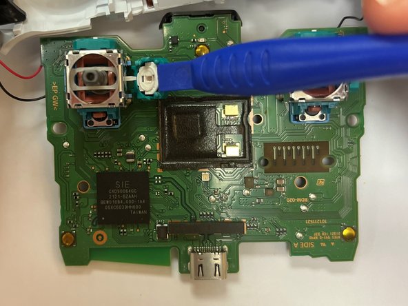

  15. How to Fix Stick Drift for a PlayStation Dualsense Controller V1: crwdns2935265:015crwdnd2935265:01crwdnd2935265:03crwdne2935265:0 How to Fix Stick Drift for a PlayStation Dualsense Controller V1: crwdns2935265:015crwdnd2935265:02crwdnd2935265:03crwdne2935265:0 How to Fix Stick Drift for a PlayStation Dualsense Controller V1: crwdns2935265:015crwdnd2935265:03crwdnd2935265:03crwdne2935265:0
    • Use the opening tool to snap open the green tabs.
  16. How to Fix Stick Drift for a PlayStation Dualsense Controller V1: crwdns2935265:016crwdnd2935265:01crwdnd2935265:03crwdne2935265:0 How to Fix Stick Drift for a PlayStation Dualsense Controller V1: crwdns2935265:016crwdnd2935265:02crwdnd2935265:03crwdne2935265:0 How to Fix Stick Drift for a PlayStation Dualsense Controller V1: crwdns2935265:016crwdnd2935265:03crwdnd2935265:03crwdne2935265:0

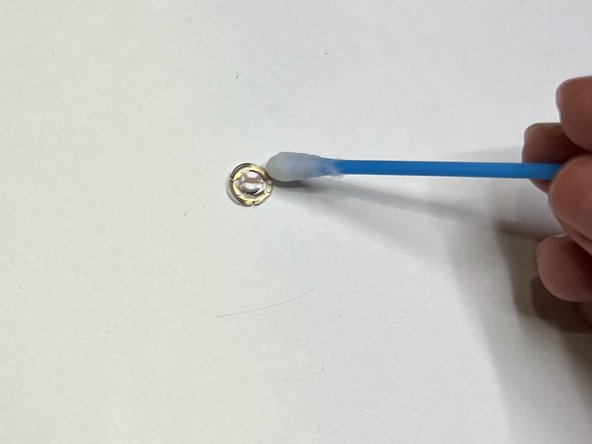

    • Use tweezers to remove the wiper disks.
  17. How to Fix Stick Drift for a PlayStation Dualsense Controller V1: crwdns2935265:017crwdnd2935265:01crwdnd2935265:02crwdne2935265:0 How to Fix Stick Drift for a PlayStation Dualsense Controller V1: crwdns2935265:017crwdnd2935265:02crwdnd2935265:02crwdne2935265:0
    • Using a cotton tip with 99.8% isopropyl alcohol, clean around the black rims of the green tabs and the wiper disks.

Just cleaning the carbon track on the potentiometer is not really a long term fix for stick drift. Better fixes would be to either replace the photometers or to replace the complete stick with a hall-effect joy stick.
David Fear - crwdns2934203:0crwdne2934203:0
Do you have a link?
Nora -
I did it, sadly cleaning wasn't enough. So I guess I'll have to replace something.
Riedweg Guillaume - crwdns2934203:0crwdne2934203:0
There is now a real fix for this, hall effect mod by Jun Zheng. About $25 per pair of mods. Check out the guys YouTube, link to his AliExpress store in his video description. Just use the guide here for disassembly. https://youtube.com/@junZeng-520?si=UYbf...
Alex Lao - crwdns2934203:0crwdne2934203:0
Upon reassembly I get the three orange blinks error. Research says there’s a ribbon connection error, is that right? I went through steps again and checked all connections, but no change. Have I short circuited something? Would replacing the potentiometer even fix it at this point? Have I damaged a ribbon? (There is no visible damage).
