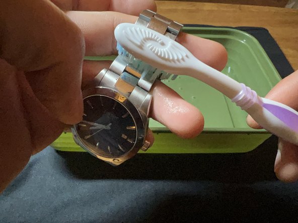

    • Fill any container up with water.
  2. How to Fix Scratches on a Steel Watch: crwdns2935265:02crwdnd2935265:01crwdnd2935265:01crwdne2935265:0
    • Grab any soft-bristled brush around for your convenience.
  3. How to Fix Scratches on a Steel Watch: crwdns2935265:03crwdnd2935265:01crwdnd2935265:03crwdne2935265:0 How to Fix Scratches on a Steel Watch: crwdns2935265:03crwdnd2935265:02crwdnd2935265:03crwdne2935265:0 How to Fix Scratches on a Steel Watch: crwdns2935265:03crwdnd2935265:03crwdnd2935265:03crwdne2935265:0
    • Dip the toothbrush in the water.
    • Brush along the crystal, bezel, and case in a circular motion.
    • Brush the bracelet in a linear motion back-and-forth.
    • Make sure to brush over the crevices of the bracelet for an optimal clean.
  4. How to Fix Scratches on a Steel Watch: crwdns2935265:04crwdnd2935265:01crwdnd2935265:01crwdne2935265:0
    Microfiber Cleaning Cloths
    $3.99
    • Dry the watch with a microfiber towel by pinching your fingers together in a back-and-forth motion.
  5. How to Fix Scratches on a Steel Watch: crwdns2935265:05crwdnd2935265:01crwdnd2935265:01crwdne2935265:0
    • Use the abrasive side of a sponge to brush the watch, following the same steps mentioned in Step 3.
    • Do not brush over the crystal with the sponge.
    • Apply minimal pressure to the sponge when brushing the watch.
  6. How to Fix Scratches on a Steel Watch: crwdns2935265:06crwdnd2935265:01crwdnd2935265:01crwdne2935265:0
    • Fold the metal polishing cloth in half.
    • Hold the corner of the cloth along your index finger.
  7. How to Fix Scratches on a Steel Watch: crwdns2935265:07crwdnd2935265:01crwdnd2935265:01crwdne2935265:0
    • Brush off all the scratches on the watch using a back-and-forth motion with great pressure to ensure effectiveness.
    • Perform the process as many times as needed.
    • Do not brush over the crystal.
