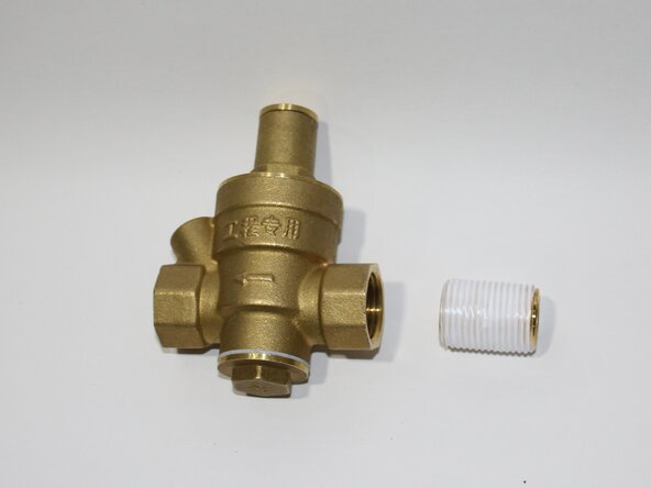

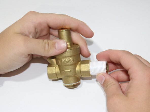

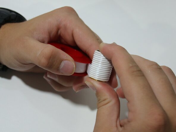

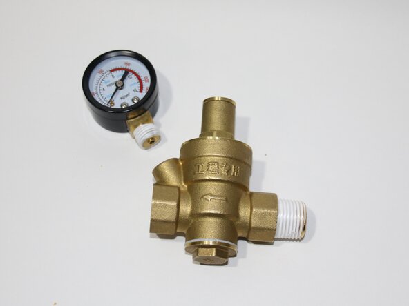

    • Wrap the thread tape around the 1/2" nipple, 2-3 times in a counter-clockwise motion.
    • Make sure the nipple is fully covered, but the ends are open.

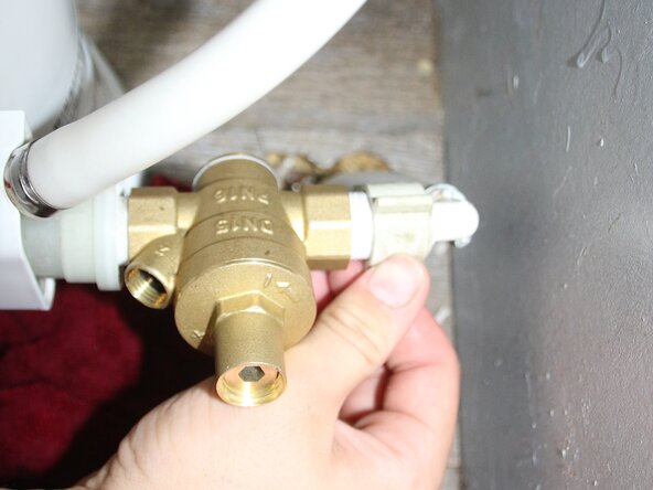

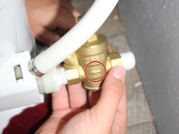

  2. How to Fix RV Toilet Water Pressure: crwdns2935265:02crwdnd2935265:01crwdnd2935265:02crwdne2935265:0 How to Fix RV Toilet Water Pressure: crwdns2935265:02crwdnd2935265:02crwdnd2935265:02crwdne2935265:0
    • Screw the nipple onto the regulator, making sure the arrow (marked by the red circle) is pointing away from the nipple.
    • Be sure to screw the nipple in as tight as you can with just your fingers.

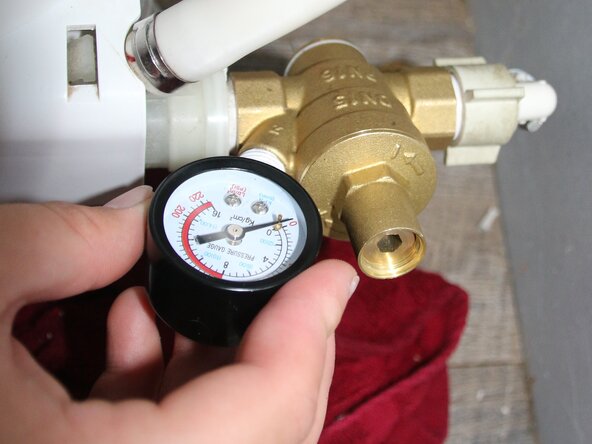

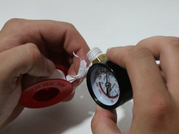

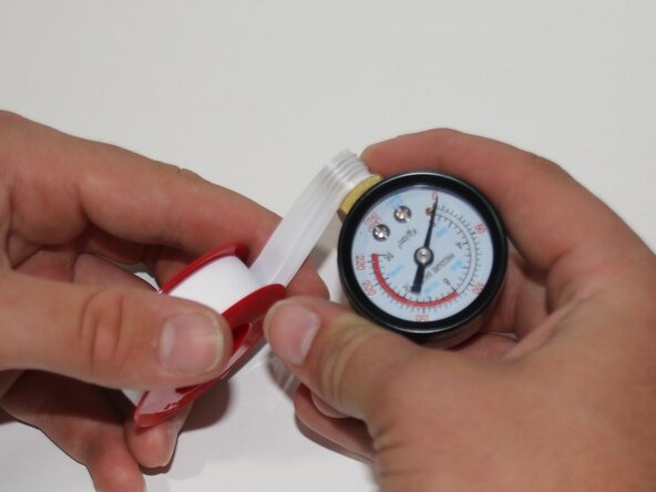

  3. How to Fix RV Toilet Water Pressure: crwdns2935265:03crwdnd2935265:01crwdnd2935265:03crwdne2935265:0 How to Fix RV Toilet Water Pressure: crwdns2935265:03crwdnd2935265:02crwdnd2935265:03crwdne2935265:0 How to Fix RV Toilet Water Pressure: crwdns2935265:03crwdnd2935265:03crwdnd2935265:03crwdne2935265:0
    • Wrap the thread tape around the pressure gauge 2-3 times, in a counter-clockwise motion.
    • Make sure the thread is fully covered, but the end is open.
    • Do not thread the gauge in yet. Instead, note the angled slot where it will be installed in step 10.

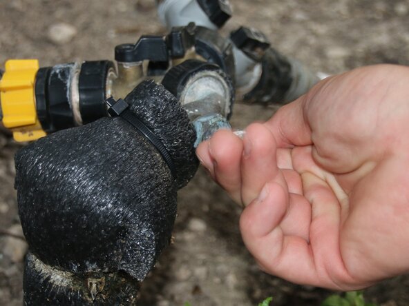

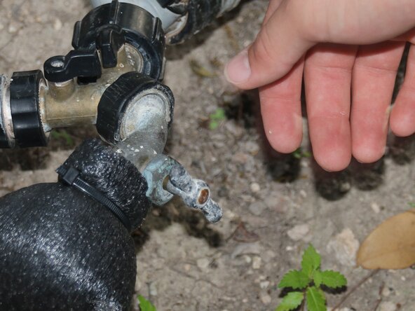

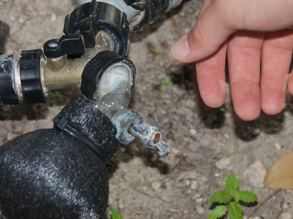

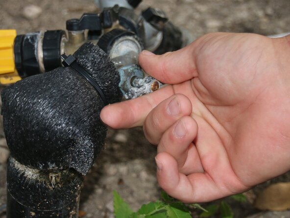

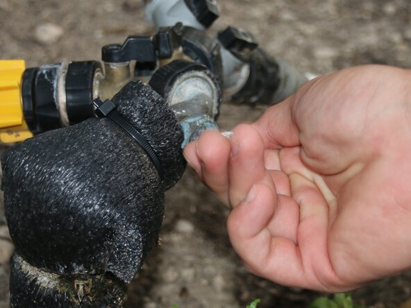

  4. How to Fix RV Toilet Water Pressure: crwdns2935265:04crwdnd2935265:01crwdnd2935265:03crwdne2935265:0 How to Fix RV Toilet Water Pressure: crwdns2935265:04crwdnd2935265:02crwdnd2935265:03crwdne2935265:0 How to Fix RV Toilet Water Pressure: crwdns2935265:04crwdnd2935265:03crwdnd2935265:03crwdne2935265:0
    • Turn the external water source (outside faucet) off.

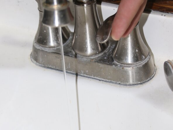

  5. How to Fix RV Toilet Water Pressure: crwdns2935265:05crwdnd2935265:01crwdnd2935265:01crwdne2935265:0
    • Turn on the sink faucet and let it run until no more water comes out to drain the lines.
    • Flush the toilet to drain any remaining water in the lines.

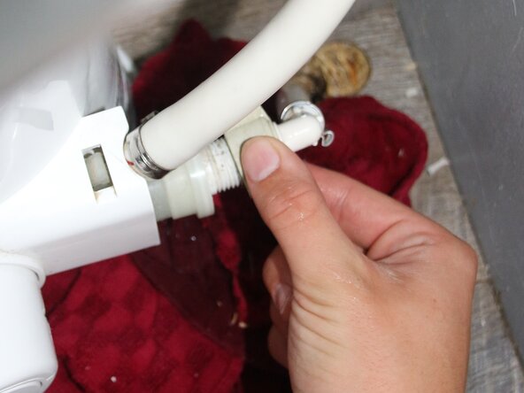

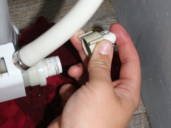

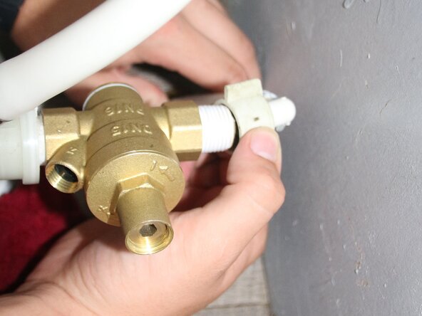

  6. How to Fix RV Toilet Water Pressure: crwdns2935265:06crwdnd2935265:01crwdnd2935265:02crwdne2935265:0 How to Fix RV Toilet Water Pressure: crwdns2935265:06crwdnd2935265:02crwdnd2935265:02crwdne2935265:0
    • Unscrew the water inlet line from the toilet.
    • Lay a towel down as some water may drip out.

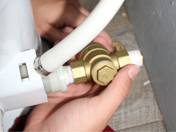

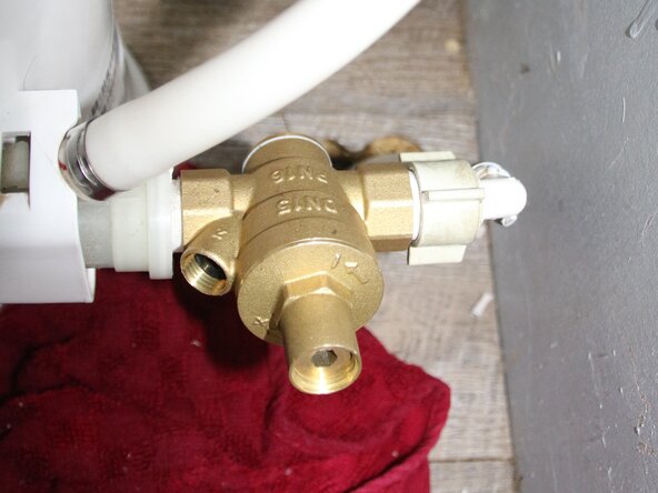

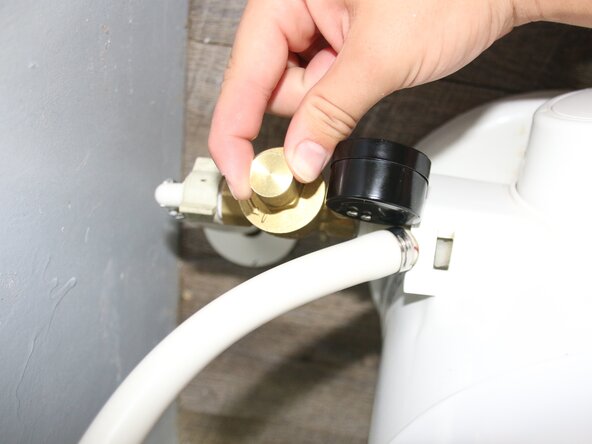

  7. How to Fix RV Toilet Water Pressure: crwdns2935265:07crwdnd2935265:01crwdnd2935265:02crwdne2935265:0 How to Fix RV Toilet Water Pressure: crwdns2935265:07crwdnd2935265:02crwdnd2935265:02crwdne2935265:0

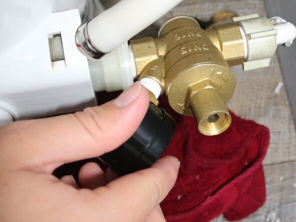

    • Screw the regulator onto the back of the toilet where the water line was screwed in.
    • The arrow should point to the back of the toilet.

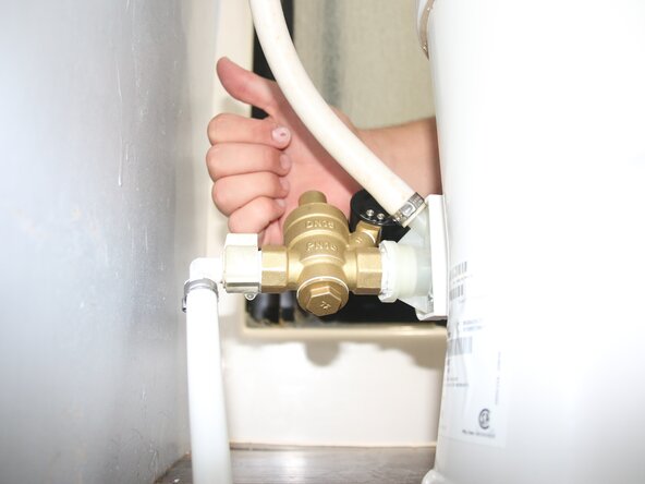

  8. How to Fix RV Toilet Water Pressure: crwdns2935265:08crwdnd2935265:01crwdnd2935265:03crwdne2935265:0 How to Fix RV Toilet Water Pressure: crwdns2935265:08crwdnd2935265:02crwdnd2935265:03crwdne2935265:0 How to Fix RV Toilet Water Pressure: crwdns2935265:08crwdnd2935265:03crwdnd2935265:03crwdne2935265:0
    • Screw the water inlet line onto the nipple attached to the regulator.
    • This may be difficult, but be sure NOT to cross-thread.
    • Make sure to screw it in tight (finger tight), but do not over tighten.

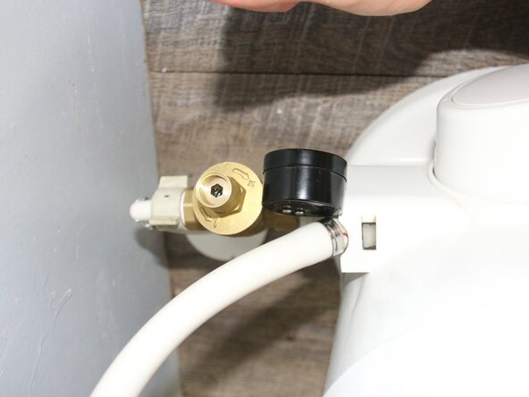

  9. How to Fix RV Toilet Water Pressure: crwdns2935265:09crwdnd2935265:01crwdnd2935265:02crwdne2935265:0 How to Fix RV Toilet Water Pressure: crwdns2935265:09crwdnd2935265:02crwdnd2935265:02crwdne2935265:0
    • Screw the pressure gauge onto the regulator.
    • Tighten it all the way down as far as you can with finger strength.

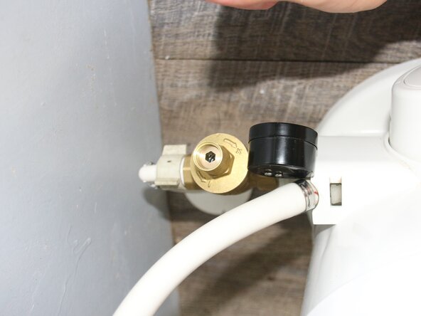

  10. How to Fix RV Toilet Water Pressure: crwdns2935265:010crwdnd2935265:01crwdnd2935265:03crwdne2935265:0 How to Fix RV Toilet Water Pressure: crwdns2935265:010crwdnd2935265:02crwdnd2935265:03crwdne2935265:0 How to Fix RV Toilet Water Pressure: crwdns2935265:010crwdnd2935265:03crwdnd2935265:03crwdne2935265:0
    • Turn the water back on.

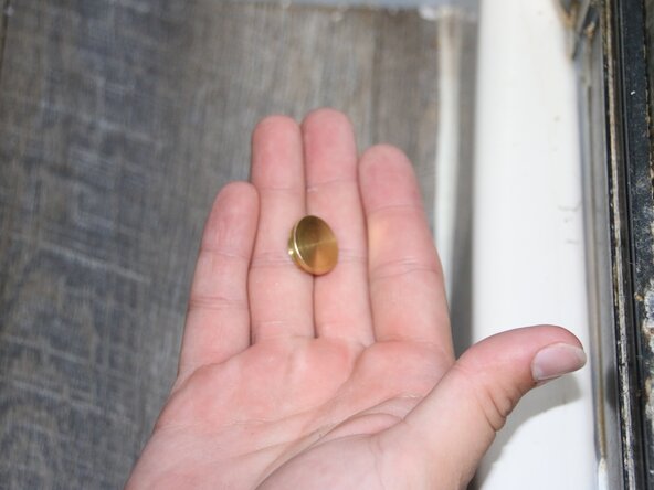

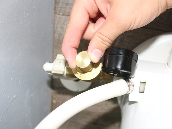

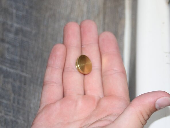

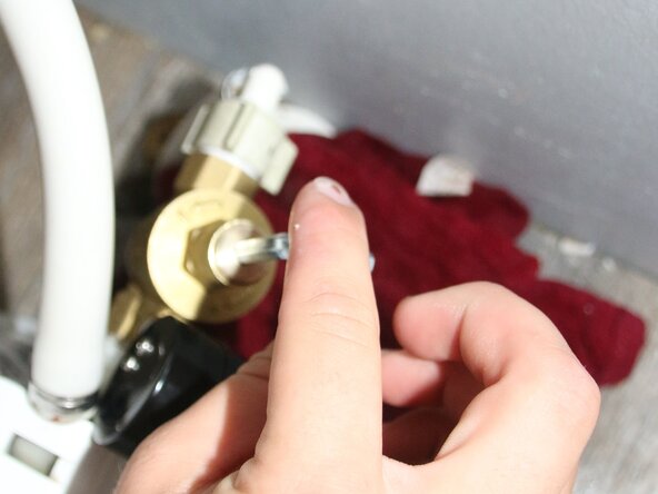

  12. How to Fix RV Toilet Water Pressure: crwdns2935265:012crwdnd2935265:01crwdnd2935265:03crwdne2935265:0 How to Fix RV Toilet Water Pressure: crwdns2935265:012crwdnd2935265:02crwdnd2935265:03crwdne2935265:0 How to Fix RV Toilet Water Pressure: crwdns2935265:012crwdnd2935265:03crwdnd2935265:03crwdne2935265:0

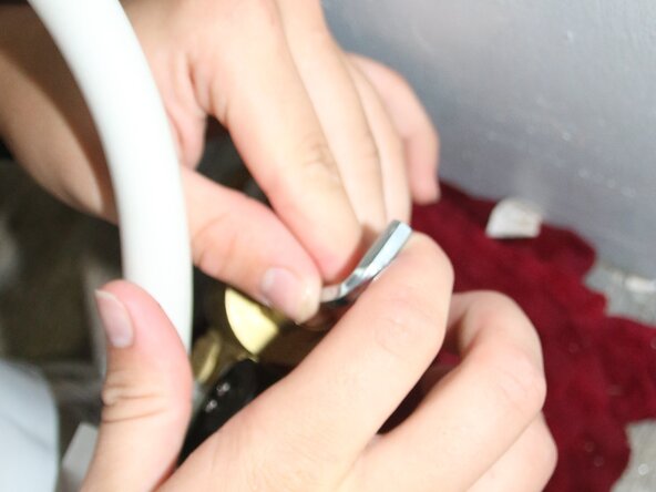

    • Remove the cap from the top of the regulator.

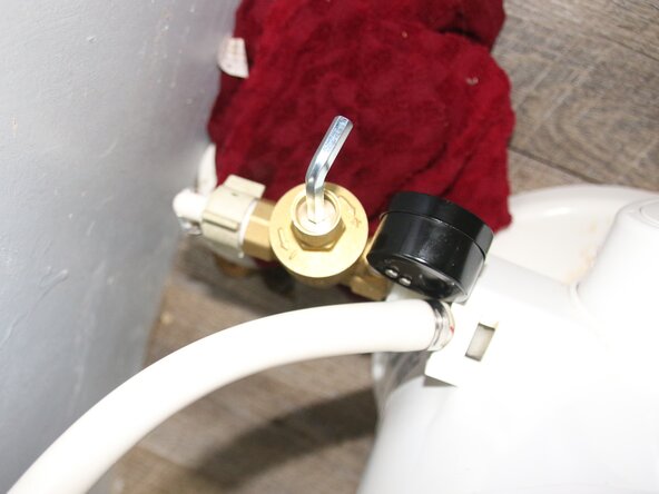

  13. How to Fix RV Toilet Water Pressure: crwdns2935265:013crwdnd2935265:01crwdnd2935265:03crwdne2935265:0 How to Fix RV Toilet Water Pressure: crwdns2935265:013crwdnd2935265:02crwdnd2935265:03crwdne2935265:0 How to Fix RV Toilet Water Pressure: crwdns2935265:013crwdnd2935265:03crwdnd2935265:03crwdne2935265:0
    • Take the Allen Key and insert it in the top of the regulator.
    • Twist the Allen Key while running water into the toilet until the desired water pressure is achieved.
  14. How to Fix RV Toilet Water Pressure: crwdns2935265:014crwdnd2935265:01crwdnd2935265:03crwdne2935265:0 How to Fix RV Toilet Water Pressure: crwdns2935265:014crwdnd2935265:02crwdnd2935265:03crwdne2935265:0 How to Fix RV Toilet Water Pressure: crwdns2935265:014crwdnd2935265:03crwdnd2935265:03crwdne2935265:0
    • Screw the cap back on to the regulator.
