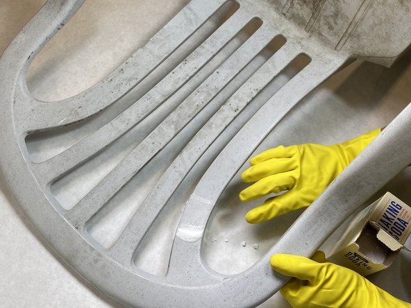

      • Lay the broken chair such that the crack is parallel to the floor.
    2. How to Fix Plastic Chair Cracks: crwdns2935265:02crwdnd2935265:01crwdnd2935265:02crwdne2935265:0 How to Fix Plastic Chair Cracks: crwdns2935265:02crwdnd2935265:02crwdnd2935265:02crwdne2935265:0
      • Wear gloves to minimize chemical contact on skin.
      • Dampen a rag with isopropyl alcohol.
    3. How to Fix Plastic Chair Cracks: crwdns2935265:03crwdnd2935265:01crwdnd2935265:02crwdne2935265:0 How to Fix Plastic Chair Cracks: crwdns2935265:03crwdnd2935265:02crwdnd2935265:02crwdne2935265:0
      • Clean the surface of the crack with the dampened rag to remove all dust and debris.
      • Repeat on all sides of the crack (edges and backside).

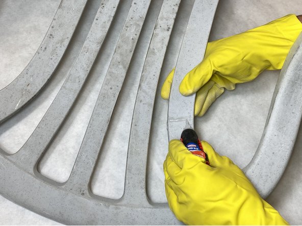

      • Apply glue between the crack.
      • Then apply glue across the surface of the crack.
    5. How to Fix Plastic Chair Cracks: crwdns2935265:05crwdnd2935265:01crwdnd2935265:01crwdne2935265:0
      • Hold the two glued pieces together for 30 seconds to allow the glue to bind to the chair.
      • Do not let the glue dry completely. The wet glue will need to bind with baking soda in the next step.
