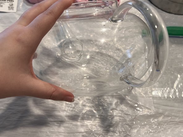

How to Fix Cracked Glassware with Food Safe Resin
  1. How to Fix Cracked Glassware with Food Safe Resin, How to Fix Cracked Glassware with Food Safe Resin: crwdns2935265:01crwdnd2935265:01crwdnd2935265:01crwdne2935265:0

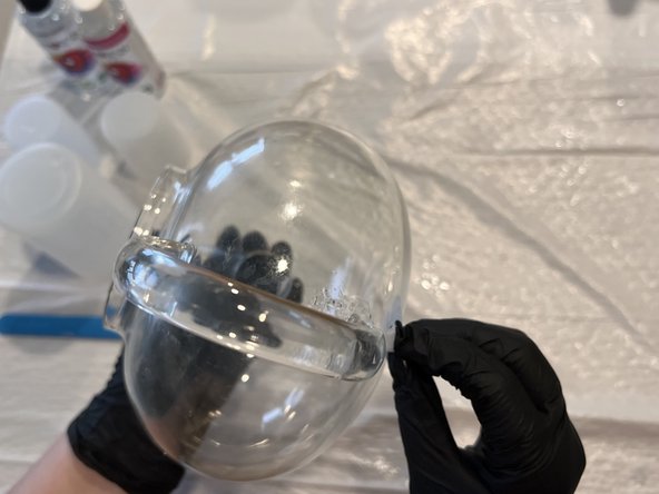

    • Lay a garbage bag out on your workstation and put on disposable gloves.
    • Using separate cups, measure the resin and hardener to an exact 1:1 ratio.
    • Always wear gloves and ensure your work area is well-ventilated while working with resin. You may also want to wear safety glasses to protect your eyes.
  2. How to Fix Cracked Glassware with Food Safe Resin: crwdns2935265:02crwdnd2935265:01crwdnd2935265:02crwdne2935265:0 How to Fix Cracked Glassware with Food Safe Resin: crwdns2935265:02crwdnd2935265:02crwdnd2935265:02crwdne2935265:0
    • Add the resin and hardener to a container or bowl to mix the solution.
    • Scrape the sides of the measuring cups to ensure that both liquids are fully incorporated.

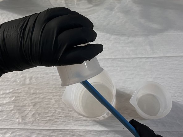

  3. How to Fix Cracked Glassware with Food Safe Resin: crwdns2935265:03crwdnd2935265:01crwdnd2935265:01crwdne2935265:0
    • Use the mixing stick to stir the resin and hardener for at least three minutes.
    • Scrape the sides and bottom while mixing.

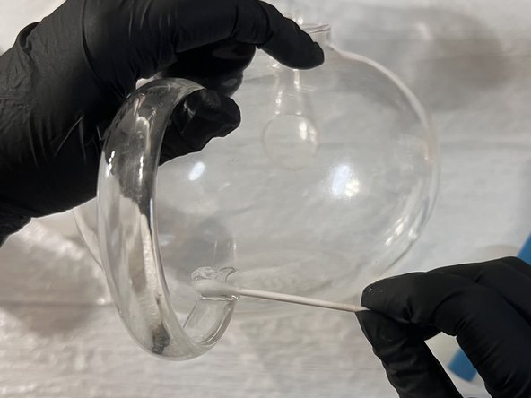

    • Dip one end of the Q-Tip into the resin mixture. Submerging is not necessary; ensure the tip is coated enough to cover the surface of the crack.
    • Apply the resin mixture to the affected area(s), covering the crack completely. Cover both the inside and outside of the crack if necessary.
    • Be careful of loose shards of glass.

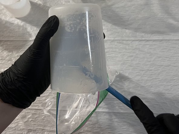

    • Place the Q-tip and leftover resin into a disposable, sealable plastic bag.
    • Allow it to cure for 8+ hours before disposing.
    • Do NOT pour resin down the drain or into the sink.
    • Flip the measuring and mixing cups over the trash bag to remove any excess resin or hardener.
