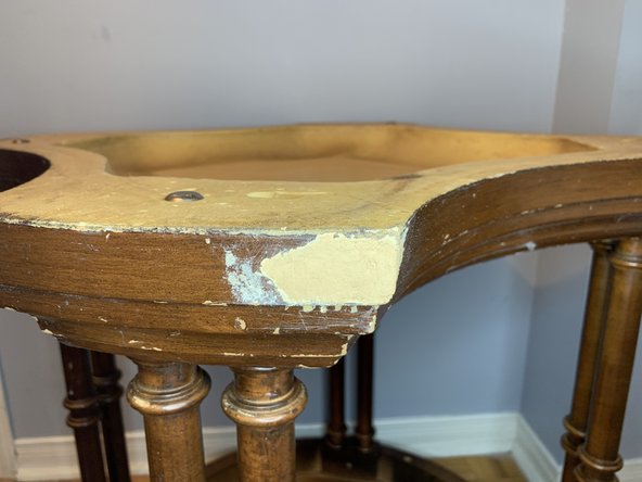

    • Clean the affected/damaged area of the wood and remove any dust or small wood particles using a clean brush or a paper towel.
  2. How to Fix Chipped Wood Furniture: crwdns2935265:02crwdnd2935265:01crwdnd2935265:02crwdne2935265:0 How to Fix Chipped Wood Furniture: crwdns2935265:02crwdnd2935265:02crwdnd2935265:02crwdne2935265:0

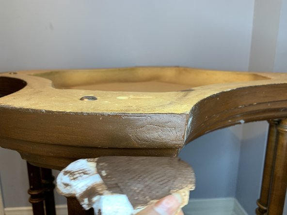

  6. How to Fix Chipped Wood Furniture: crwdns2935265:06crwdnd2935265:01crwdnd2935265:03crwdne2935265:0 How to Fix Chipped Wood Furniture: crwdns2935265:06crwdnd2935265:02crwdnd2935265:03crwdne2935265:0 How to Fix Chipped Wood Furniture: crwdns2935265:06crwdnd2935265:03crwdnd2935265:03crwdne2935265:0
    • Once the wood filler completely dries, once again use the same 150-grit sandpaper to sand down the ragged edges of the now hardened wood filler as close to the original shape of the wood.
    • You may additionally use 220-grit sandpaper for a finer/smoother finish.

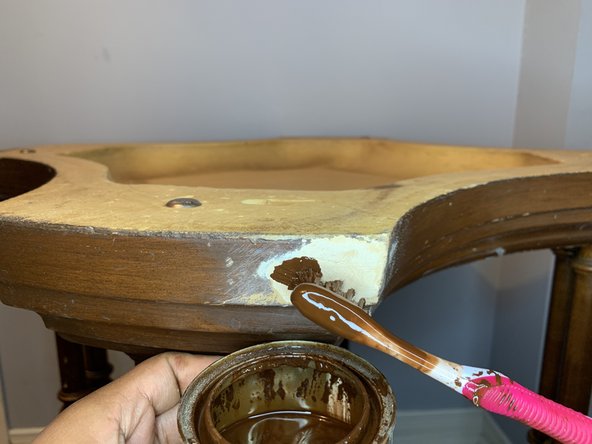

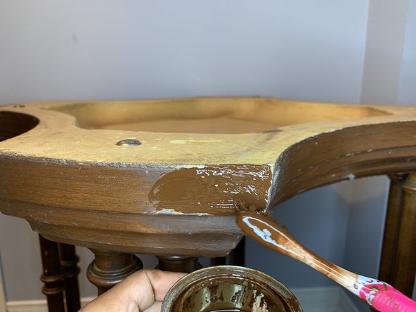

  7. How to Fix Chipped Wood Furniture: crwdns2935265:07crwdnd2935265:01crwdnd2935265:03crwdne2935265:0 How to Fix Chipped Wood Furniture: crwdns2935265:07crwdnd2935265:02crwdnd2935265:03crwdne2935265:0 How to Fix Chipped Wood Furniture: crwdns2935265:07crwdnd2935265:03crwdnd2935265:03crwdne2935265:0
    • Using a toothbrush or regular paint brush, apply a generous amount of wood stain of your preferred shade.
  8. How to Fix Chipped Wood Furniture: crwdns2935265:08crwdnd2935265:01crwdnd2935265:03crwdne2935265:0 How to Fix Chipped Wood Furniture: crwdns2935265:08crwdnd2935265:02crwdnd2935265:03crwdne2935265:0 How to Fix Chipped Wood Furniture: crwdns2935265:08crwdnd2935265:03crwdnd2935265:03crwdne2935265:0
    • Using a paper towel or cloth, carefully smooth out the wood stain from the previous step while removing any excess stain as well.
  9. How to Fix Chipped Wood Furniture: crwdns2935265:09crwdnd2935265:01crwdnd2935265:02crwdne2935265:0 How to Fix Chipped Wood Furniture: crwdns2935265:09crwdnd2935265:02crwdnd2935265:02crwdne2935265:0
    • Let the stain dry for at least six hours.
