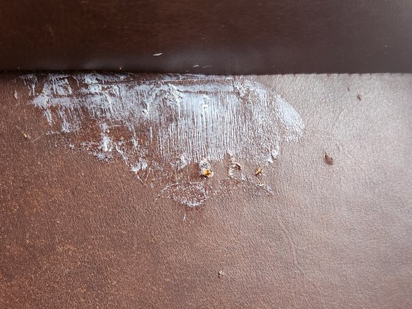

    • Apply a small amount of the 50% isopropyl rubbing alcohol to a paper towel or cloth.
    • Wipe down the damaged area of the leather with the rubbing alcohol.
    • Refrain from rubbing too aggressively as this can further damage the couch.

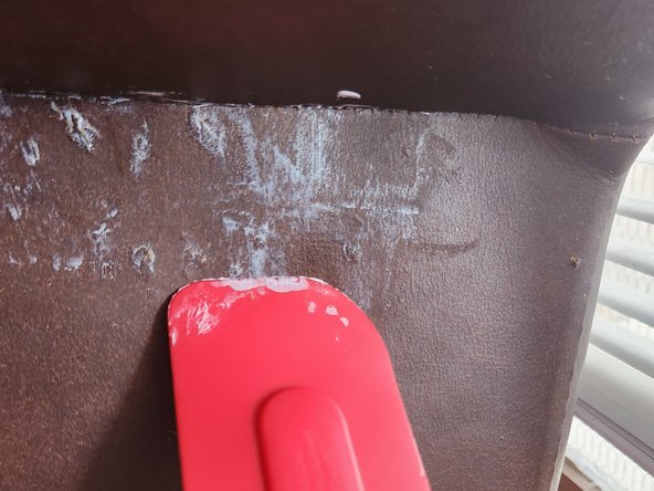

    • Move a spatula/scraper up and down over the scratches to determine the gradient (the way they open).
    • Opt for a plastic or rubber spatula rather than a metal one.
  3. How to Fix Cat Scratches on a Leather Couch: crwdns2935265:03crwdnd2935265:01crwdnd2935265:03crwdne2935265:0 How to Fix Cat Scratches on a Leather Couch: crwdns2935265:03crwdnd2935265:02crwdnd2935265:03crwdne2935265:0 How to Fix Cat Scratches on a Leather Couch: crwdns2935265:03crwdnd2935265:03crwdnd2935265:03crwdne2935265:0
    • Apply glue to the spatula/scraper and spread it over the damaged area on the couch.
    • Ensure the scratches are fully saturated in this step.
    • Refrain from pushing too hard with the tool as this can increase the size of the scratches.
  4. How to Fix Cat Scratches on a Leather Couch: crwdns2935265:04crwdnd2935265:01crwdnd2935265:02crwdne2935265:0 How to Fix Cat Scratches on a Leather Couch: crwdns2935265:04crwdnd2935265:02crwdnd2935265:02crwdne2935265:0
    • Push the spatula/scraper toward the gradient of the scratches, closing them, and removing excess glue.
    • Wait for the glue to fully dry before moving to the next step.
    • A hairdryer may be used in this step to speed up the drying process.
