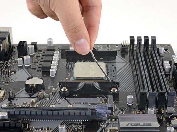

  7. How to Fix Bent CPU Pins, Lift the socket locking arm: crwdns2935265:07crwdnd2935265:01crwdnd2935265:03crwdne2935265:0 How to Fix Bent CPU Pins, Lift the socket locking arm: crwdns2935265:07crwdnd2935265:02crwdnd2935265:03crwdne2935265:0 How to Fix Bent CPU Pins, Lift the socket locking arm: crwdns2935265:07crwdnd2935265:03crwdnd2935265:03crwdne2935265:0
    • On your motherboard, lift the socket locking arm out around the locking clip and up to its vertical position.
  8. How to Fix Bent CPU Pins, Match the small triangles: crwdns2935265:08crwdnd2935265:01crwdnd2935265:03crwdne2935265:0 How to Fix Bent CPU Pins, Match the small triangles: crwdns2935265:08crwdnd2935265:02crwdnd2935265:03crwdne2935265:0 How to Fix Bent CPU Pins, Match the small triangles: crwdns2935265:08crwdnd2935265:03crwdnd2935265:03crwdne2935265:0
    • Match the corner of the CPU with a gold triangle to the corner of the motherboard socket that also has a triangle.
    • Grip the CPU by its edges and align it over the socket.
  9. How to Fix Bent CPU Pins, Lower the CPU into the socket: crwdns2935265:09crwdnd2935265:01crwdnd2935265:03crwdne2935265:0 How to Fix Bent CPU Pins, Lower the CPU into the socket: crwdns2935265:09crwdnd2935265:02crwdnd2935265:03crwdne2935265:0 How to Fix Bent CPU Pins, Lower the CPU into the socket: crwdns2935265:09crwdnd2935265:03crwdnd2935265:03crwdne2935265:0
    • Lower the CPU into the socket, ensuring that all pins fall into their matching holes.
    • The pins do not have to be perfectly straight for this to happen, but they have to be close.
    • The CPU should fall into the socket without any pressure. Do not push the CPU into the socket.
    • If the pins don't find their holes immediately, or if only one side goes in, remove the CPU and check its pins again.
    • When installed correctly, the CPU will sit flush with the edges of the socket. There shouldn't be any gaps.
  10. How to Fix Bent CPU Pins, Close the locking tab: crwdns2935265:010crwdnd2935265:01crwdnd2935265:03crwdne2935265:0 How to Fix Bent CPU Pins, Close the locking tab: crwdns2935265:010crwdnd2935265:02crwdnd2935265:03crwdne2935265:0 How to Fix Bent CPU Pins, Close the locking tab: crwdns2935265:010crwdnd2935265:03crwdnd2935265:03crwdne2935265:0
    • Once the pins on your CPU are straight enough to allow it to be installed into the socket, close the locking arm by pulling it down, around the locking tab.
  11. How to Fix Bent CPU Pins, Open and close the locking tab: crwdns2935265:011crwdnd2935265:01crwdnd2935265:03crwdne2935265:0 How to Fix Bent CPU Pins, Open and close the locking tab: crwdns2935265:011crwdnd2935265:02crwdnd2935265:03crwdne2935265:0 How to Fix Bent CPU Pins, Open and close the locking tab: crwdns2935265:011crwdnd2935265:03crwdnd2935265:03crwdne2935265:0
    • Without touching the CPU, repeat the locking/unlocking process on the socket four to five more times.
    • When the socket is locked into place, it "grips" the pins, further aligning and straightening them.
    • That's it! Close the socket's locking arm and proceed with your PC build.
