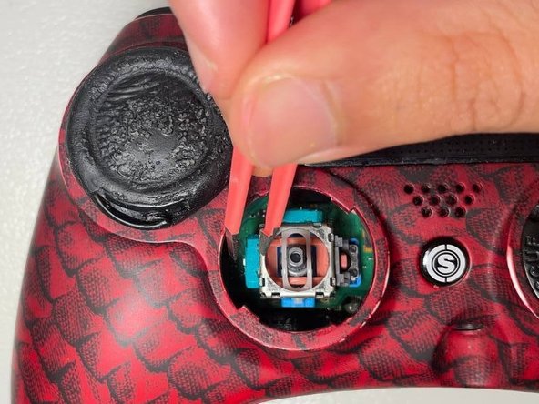

  3. How to Fix Analog Drift for the SCUF IMPACT: crwdns2935265:03crwdnd2935265:01crwdnd2935265:03crwdne2935265:0 How to Fix Analog Drift for the SCUF IMPACT: crwdns2935265:03crwdnd2935265:02crwdnd2935265:03crwdne2935265:0 How to Fix Analog Drift for the SCUF IMPACT: crwdns2935265:03crwdnd2935265:03crwdnd2935265:03crwdne2935265:0
    • Use a tweezer tip to gently open the green box.
  4. How to Fix Analog Drift for the SCUF IMPACT: crwdns2935265:04crwdnd2935265:01crwdnd2935265:03crwdne2935265:0 How to Fix Analog Drift for the SCUF IMPACT: crwdns2935265:04crwdnd2935265:02crwdnd2935265:03crwdne2935265:0 How to Fix Analog Drift for the SCUF IMPACT: crwdns2935265:04crwdnd2935265:03crwdnd2935265:03crwdne2935265:0
    • Locate the sensor in the green box and take it out slowly.

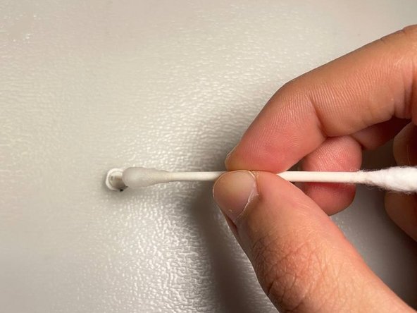

  5. How to Fix Analog Drift for the SCUF IMPACT: crwdns2935265:05crwdnd2935265:01crwdnd2935265:03crwdne2935265:0 How to Fix Analog Drift for the SCUF IMPACT: crwdns2935265:05crwdnd2935265:02crwdnd2935265:03crwdne2935265:0 How to Fix Analog Drift for the SCUF IMPACT: crwdns2935265:05crwdnd2935265:03crwdnd2935265:03crwdne2935265:0
    • Dip the q-tip in rubbing alcohol to clean the sensor and inside the green box for any dust or dirt.

HIGHLY RECOMMENDED! You saved my life. I have a lot of stick drift in my left analog that ruined my gaming experience through running movement in most of my games (Warzone, Apex, Fortnite) and this tutorial fix it ! I had some black crap on the sensor when I take them off and rubbing it with alcohol and a fine needle solve it. Thanks so much!!!
