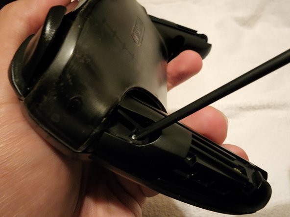

    • Remove the two black screws at the bottom ends of the controller using a JIS #00 screwdriver.
    • You may be able to carefully remove the screws with a different-sized screwdriver or flathead. However, this can easily "strip" or damage the screws and make them a lot more difficult (or even impossible) to remove next time.
    • Pull the hand grips off the bottom edges of the controller.

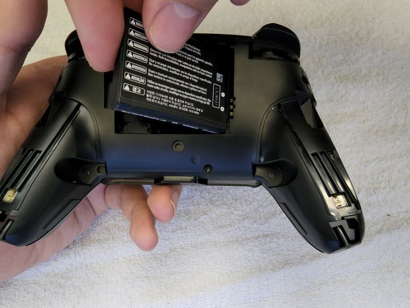

    • Place a finger in the gap to the left of the battery.
    • Use the small tab on the side of the battery to remove the battery from the controller.
