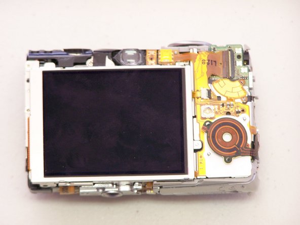

    • Remove the back face by using a spudger to lift the tab highlighted in yellow
    • Pivot the back face clockwise as seen in the second photo.

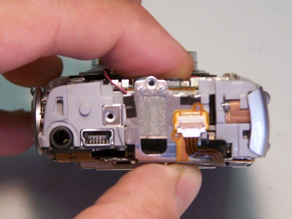

    • Remove the A/V port cover [no tools are necessary]
  7. How to Dry Wet Canon PowerShot SD850 IS Camera Components, How to Dry Wet Canon PowerShot SD850 IS Camera Components: crwdns2935265:07crwdnd2935265:01crwdnd2935265:02crwdne2935265:0 How to Dry Wet Canon PowerShot SD850 IS Camera Components, How to Dry Wet Canon PowerShot SD850 IS Camera Components: crwdns2935265:07crwdnd2935265:02crwdnd2935265:02crwdne2935265:0
    • Use compressed air to dry off camera's internal components.
    • Use caution when performing this step. Compressed air could possibly damage components if sprayed directly at connections or other sensitive areas.
