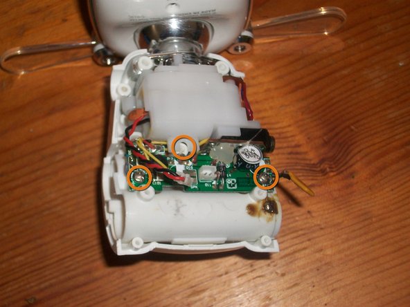

  4. How to Disassemble an iDog MP3 toy: crwdns2935265:04crwdnd2935265:01crwdnd2935265:03crwdne2935265:0 How to Disassemble an iDog MP3 toy: crwdns2935265:04crwdnd2935265:02crwdnd2935265:03crwdne2935265:0 How to Disassemble an iDog MP3 toy: crwdns2935265:04crwdnd2935265:03crwdnd2935265:03crwdne2935265:0
    • desolder battery contacts.
    • remove screws securing motherboard to battery housing.
    • lift motherboard up from housing, you may have to bend fuse (that was soldered to battery contact) slightly to allow movement. Be careful as it is still attached to jack and motor.

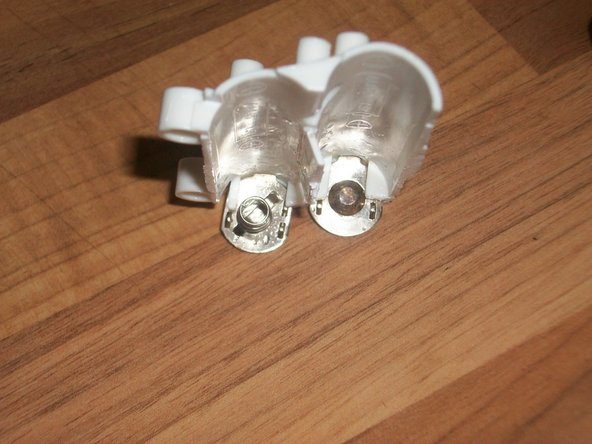

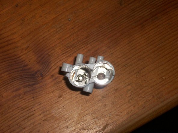

    • remove 2 screws accessed through battery housing. (Jack slides from motor housing and is easily resited it is not secured in place)
  6. How to Disassemble an iDog MP3 toy: crwdns2935265:06crwdnd2935265:01crwdnd2935265:03crwdne2935265:0 How to Disassemble an iDog MP3 toy: crwdns2935265:06crwdnd2935265:02crwdnd2935265:03crwdne2935265:0 How to Disassemble an iDog MP3 toy: crwdns2935265:06crwdnd2935265:03crwdnd2935265:03crwdne2935265:0
    • remove 2 screws holding motor to battery compartment that were hidden beneath jack and wiring near battery opening.
    • Lift motor housing up slightly to allow battery compartment to be removed. You may have to "wiggle" neck joint/silver attachment to allow this.
    • The removed battery compartment. You will need to use a sharp blade to cut along joins to fully access battery contacts for a thorough clean.
