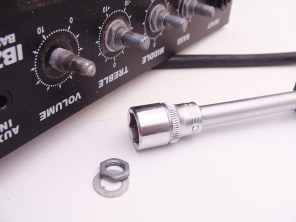

  4. How to Disassemble a Small Guitar Amplifier, Removing volume and tone control knobs: crwdns2935265:04crwdnd2935265:01crwdnd2935265:03crwdne2935265:0 How to Disassemble a Small Guitar Amplifier, Removing volume and tone control knobs: crwdns2935265:04crwdnd2935265:02crwdnd2935265:03crwdne2935265:0 How to Disassemble a Small Guitar Amplifier, Removing volume and tone control knobs: crwdns2935265:04crwdnd2935265:03crwdnd2935265:03crwdne2935265:0
    • To remove the amplifier board from the chassis, you will first need to remove the volume and tone control knobs
    • Use a flat blade screwdriver to gently pry the knobs off the potentiometer shafts
    • After removing the knobs, use a socket wrench with the appropriately sized hex bit to remove the potentiometer nuts
    • Make sure to keep the accompanying washers along with the nuts for reassembly

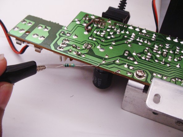

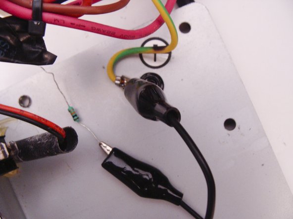

  6. How to Disassemble a Small Guitar Amplifier, Discharging capacitors: crwdns2935265:06crwdnd2935265:01crwdnd2935265:03crwdne2935265:0 How to Disassemble a Small Guitar Amplifier, Discharging capacitors: crwdns2935265:06crwdnd2935265:02crwdnd2935265:03crwdne2935265:0 How to Disassemble a Small Guitar Amplifier, Discharging capacitors: crwdns2935265:06crwdnd2935265:03crwdnd2935265:03crwdne2935265:0
    • Electrolytic capacitors can hold a dangerous charge for months or even years after a device has been powered off, thus, it is always a good safety practice to discharge the capacitors before working on an audio amplifier
    • Connect one end of an alligator lead to the chassis ground, and the other lead to an 10K ohm resistor
    • Identify the power supply capacitors and touch the 10K ohm resistor's open lead to each of it's leads for a few seconds
    • If you are paranoid, you may check with a voltmeter to ensure that the capacitors are safely discharged
    • It should now be safe to work on your amplifier's circuit board
