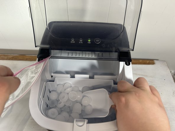

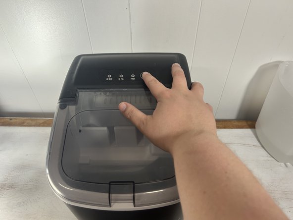

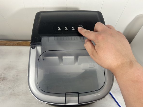

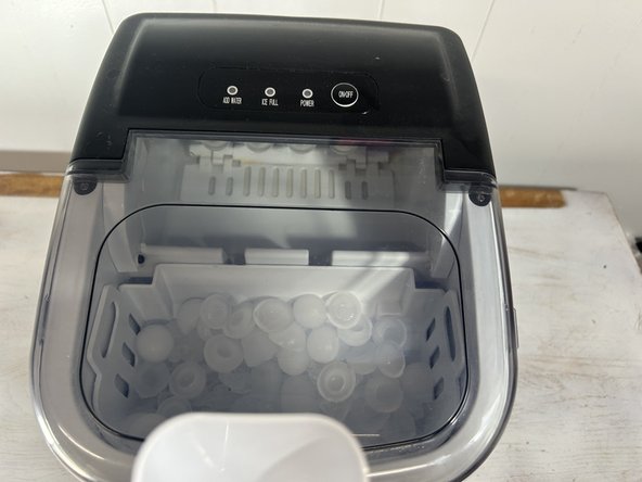

    • Turn off the icemaker by pressing the power button.

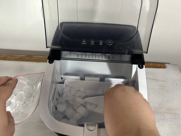

    • Remove the ice from the machine using the provided scoop.
    • Either discard the ice into your sink or put it in a separate container to use later.

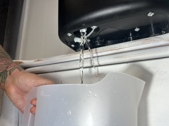

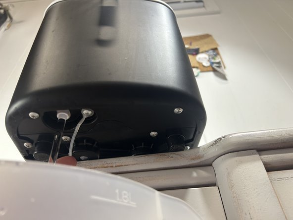

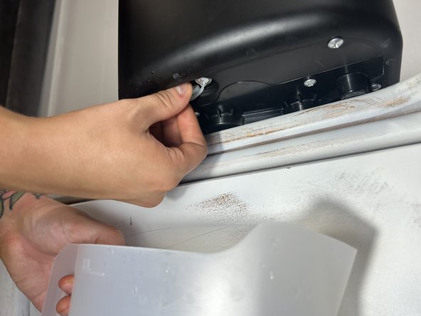

    • Either hold a container below the drain plug or place it over the edge of a sink.
    • Pull the plug quickly and let the machine fully drain.
    • To ensure as little spillage as possible, pull the plug and move your hand out of the way quickly.

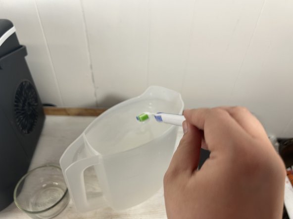

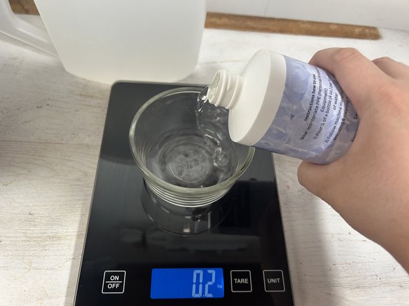

    • Use a kitchen scale to measure your solution in fluid ounces.
    • Take your cleaning solution and pour about two ounces of solution into a container.
    • Make sure to balance your scale to 0 ounces before measuring by pressing the "tare" button while the container is on the scale.
    • If you’re using a different descaling solution than the Tupkee brand that is pictured, read the instructions for your solution to see the ratio of water to solution that is recommended.

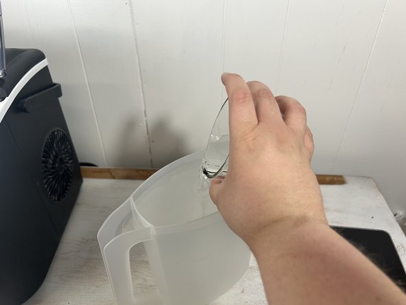

    • Add the solution to one half gallon of filtered or distilled water.
    • Mix the 2 ounces of solution into the water.
    • 1/2 of a gallon of water is also approximately 1.9 liters.

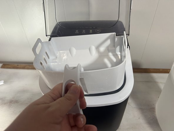

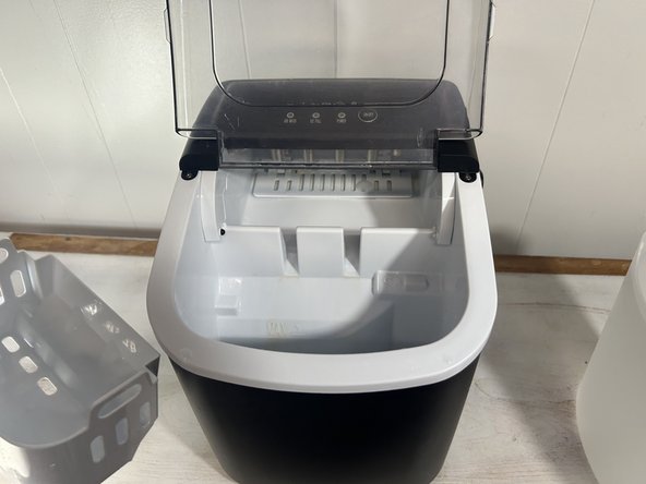

    • Grab the handle of the ice rack and remove it from the machine reservoir.

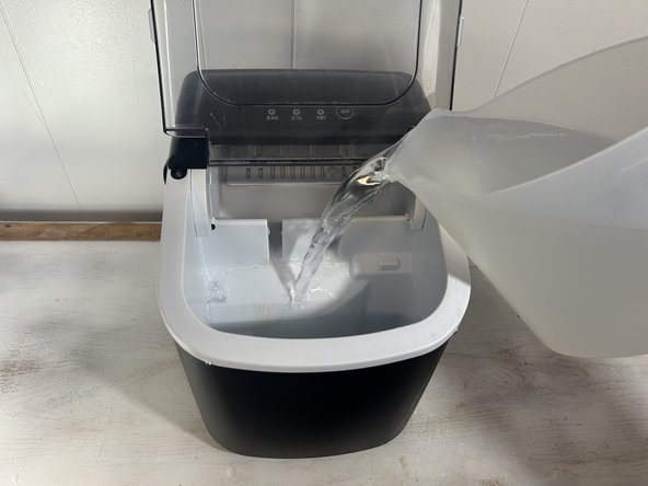

    • Pour the solution and water mixture into the machine reservoir.
    • Press and hold the power button for 3-5 seconds until the indicator lights flash red simultaneously to start the self-cleaning cycle.
    • Only fill the reservoir to the max fill line. There will be a small amount of leftover solution and water mix.

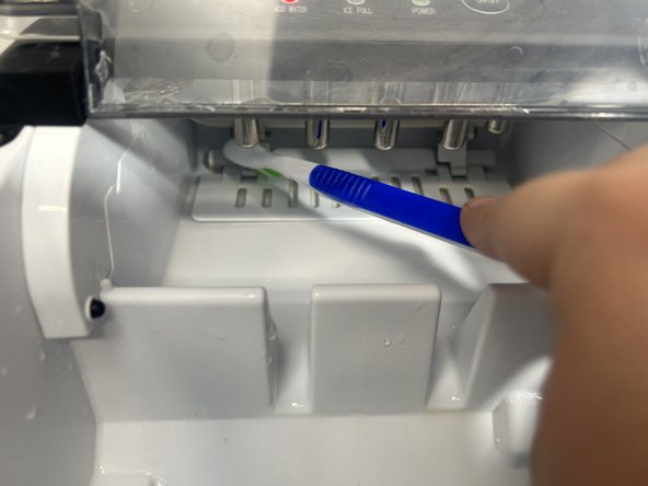

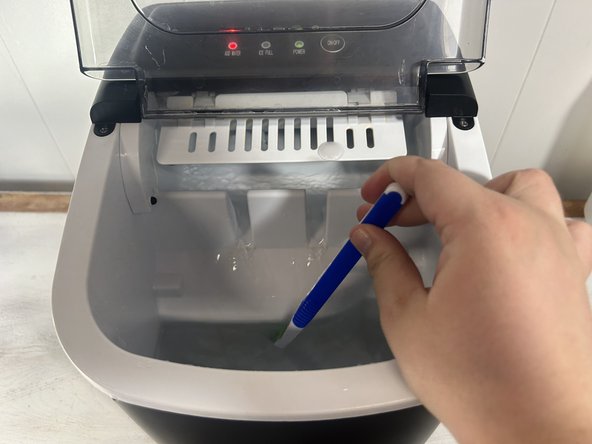

    • As the self-cleaning cycle runs, use a toothbrush dipped in the cleaning mixture to remove any visible buildup in the machine.
    • Make sure to brush carefully and be mindful of the moving parts as to not break any small attachments.

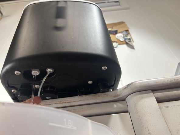

    • Once the self-cleaning cycle is complete, drain the solution from the machine following the same procedure in Step 2.
    • You'll know the self-cleaning cycle has finished once the indicator lights stop flashing red.
