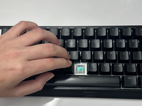

    • Take a picture of the keyboard for future reference.
    • This is to ensure that all keys return to the correct place.

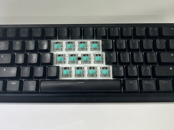

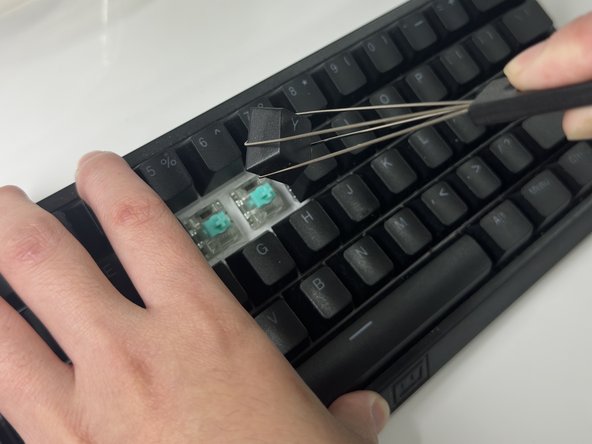

  2. How to Deep Clean a Mechanical Keyboard: crwdns2935265:02crwdnd2935265:01crwdnd2935265:03crwdne2935265:0 How to Deep Clean a Mechanical Keyboard: crwdns2935265:02crwdnd2935265:02crwdnd2935265:03crwdne2935265:0 How to Deep Clean a Mechanical Keyboard: crwdns2935265:02crwdnd2935265:03crwdnd2935265:03crwdne2935265:0
    • Use keycap puller to pull the keys off gently.
    • Some keys are harder to pull so adjust your strength accordingly.
    • Place them in the bowl.

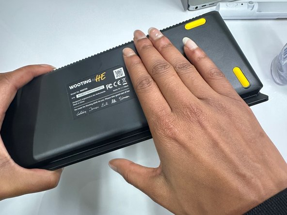

    • Flip the keyboard over.
    • Tap it and let all the dirt fall off.

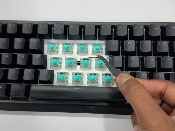

  4. How to Deep Clean a Mechanical Keyboard: crwdns2935265:04crwdnd2935265:01crwdnd2935265:03crwdne2935265:0 How to Deep Clean a Mechanical Keyboard: crwdns2935265:04crwdnd2935265:02crwdnd2935265:03crwdne2935265:0 How to Deep Clean a Mechanical Keyboard: crwdns2935265:04crwdnd2935265:03crwdnd2935265:03crwdne2935265:0

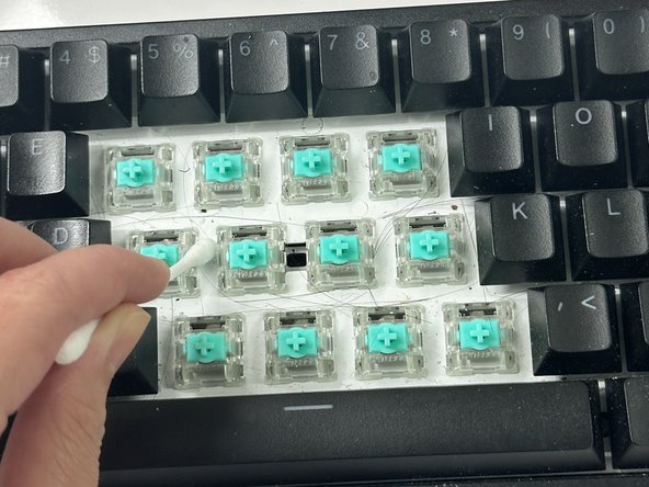

    • Scrub the rows with a dry toothbrush gently.
    • Use tweezer to get gunk out of hard to reach areas.
    • Scrub away any left over dirt that is still visible.
    • Use a cotton swab dipped in isopropyl alcohol for maximize cleanliness.
  5. How to Deep Clean a Mechanical Keyboard: crwdns2935265:05crwdnd2935265:01crwdnd2935265:01crwdne2935265:0
    • Use a can of compress air to further clean the keyboard.
    • Use this in tight areas such as in between key switches.

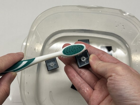

  6. How to Deep Clean a Mechanical Keyboard: crwdns2935265:06crwdnd2935265:01crwdnd2935265:02crwdne2935265:0 How to Deep Clean a Mechanical Keyboard: crwdns2935265:06crwdnd2935265:02crwdnd2935265:02crwdne2935265:0

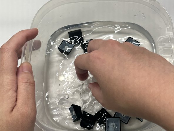

    • Fill the bowl with lukewarm water and add soap.
    • Use the toothbrush to gently scrub the keys.
    • Scrub all sides to ensure absolute cleanliness.
  7. How to Deep Clean a Mechanical Keyboard: crwdns2935265:07crwdnd2935265:01crwdnd2935265:02crwdne2935265:0 How to Deep Clean a Mechanical Keyboard: crwdns2935265:07crwdnd2935265:02crwdnd2935265:02crwdne2935265:0
    • Soak the keys in the soap bath for 5 minutes.
    • Rinse the keys with lukewarm water.
    • Make sure there is no soap left.

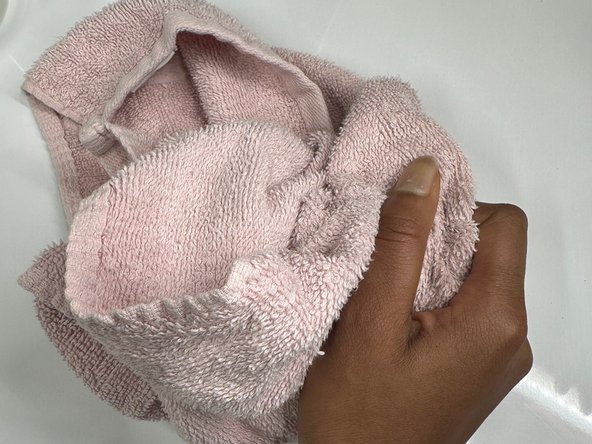

  8. How to Deep Clean a Mechanical Keyboard: crwdns2935265:08crwdnd2935265:01crwdnd2935265:03crwdne2935265:0 How to Deep Clean a Mechanical Keyboard: crwdns2935265:08crwdnd2935265:02crwdnd2935265:03crwdne2935265:0 How to Deep Clean a Mechanical Keyboard: crwdns2935265:08crwdnd2935265:03crwdnd2935265:03crwdne2935265:0

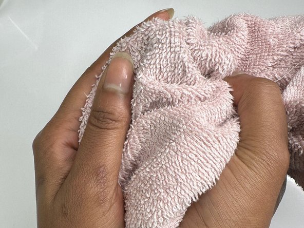

    • Lay the keys letters-side up on the towel.
    • Let them completely dry.
    • Gather the towel corners and make a sack.
    • Shake the keys vigorously to ensure faster dry time.

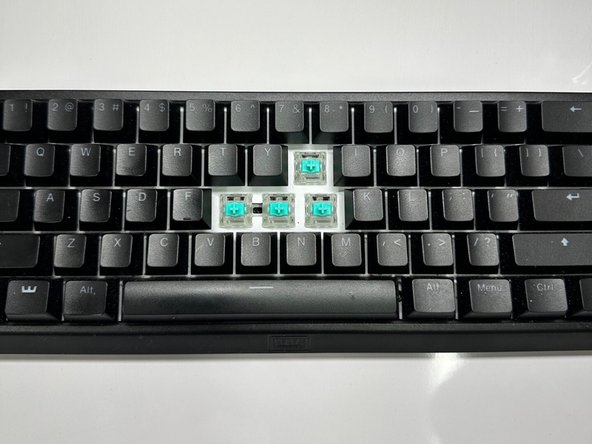

  9. How to Deep Clean a Mechanical Keyboard: crwdns2935265:09crwdnd2935265:01crwdnd2935265:03crwdne2935265:0 How to Deep Clean a Mechanical Keyboard: crwdns2935265:09crwdnd2935265:02crwdnd2935265:03crwdne2935265:0 How to Deep Clean a Mechanical Keyboard: crwdns2935265:09crwdnd2935265:03crwdnd2935265:03crwdne2935265:0
    • Use Step 1 to re-assemble the keyboard.
    • Test the keys to check for faultiness.
