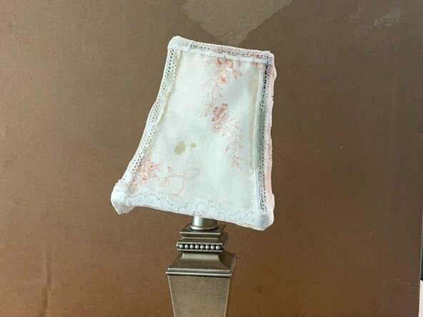

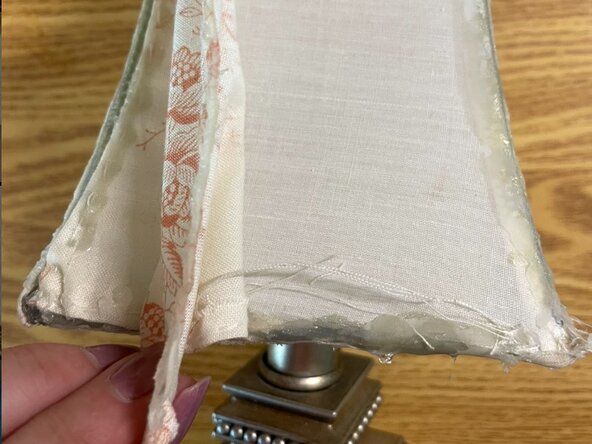

    • Disassemble the old shade by hand if any is present.
    • If you think you might damage the lamp in any way, take your time and feel free to use pliers or other tools.
    • Try to keep the fabric you're removing in decent shape! You will use it as a pattern in step 4.
    • Remove the exterior fabric. If the lamp is lined, keep the existing lining.
    • If the lining is damaged beyond saving, remove it, but you will have to add a new lining using steps 4-7.

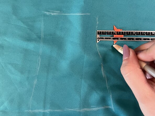

    • Lay the old shade on the fabric and use fabric chalk to trace an outline of it.
    • Pin the two pieces of fabric together if the old panel is moving too much to trace.
    • If you don’t have an old shade to trace, use your lamp’s frame to sketch a rough outline. Cut your pattern a little larger than needed—you can always trim the excess later.
    • Use a ruler to trace a line 1 inch outside your outline—this will be your seam allowance.
    • Making the pattern slightly larger will give you extra fabric to work with and make sewing the shade easier later.
    • To shape the corners, place your ruler so it extends diagonally outward from the corner toward the center of the shade. Mark a dot at the edge, then connect that dot to the seam allowance lines on each side.

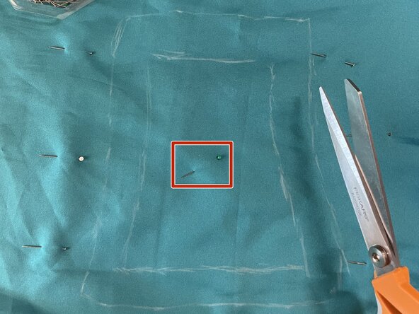

    • Cut out the first sketched shape, then place it over another section of fabric to use as a pattern for the next piece.
    • Cut on the seam allowance line for each piece, not the inner line.
    • Pin the layers together to keep them from shifting while you cut. Repeat this process until you have all the shade pieces you need.

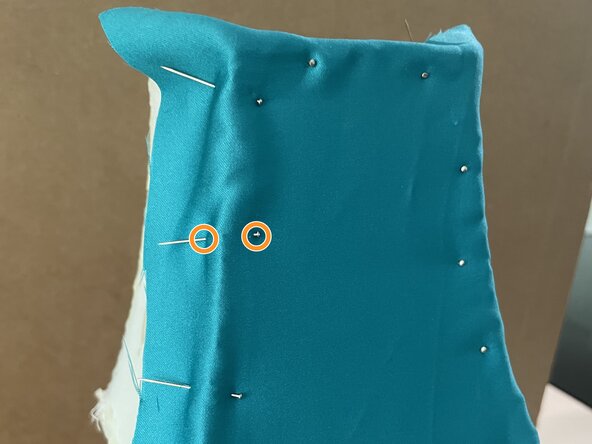

    • Drape one fabric piece over a side of your lamp, right side facing out and centered.
    • "Right side" means the unmarked outward facing side. "Wrong side" is the chalk-marked underside that won't be seen once sewn on.
    • Pin it in place through both the fabric and lining, keeping the pins as close to the metal frame as possible.
    • Add pins as needed so the fabric is smooth and taut, but not stretched.

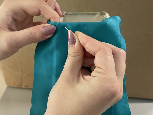

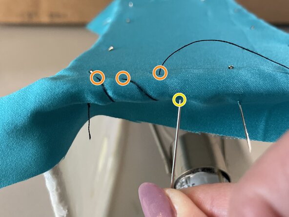

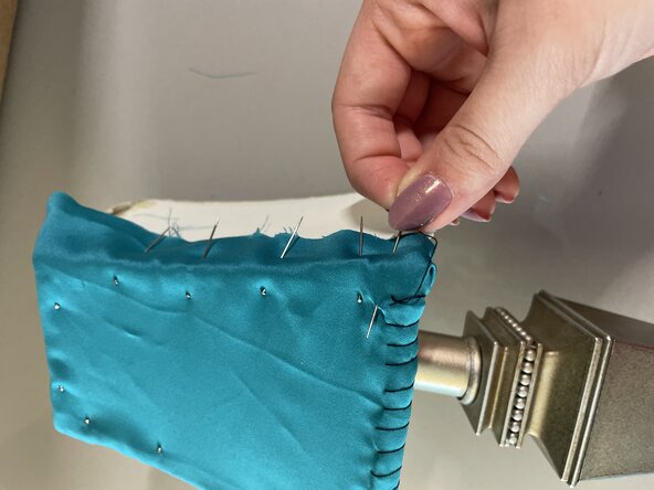

    • Sew the fabric onto the frame with the whipstitch method.
    • Cut the thread to be around 18 inches and make a sturdy knot on one end. Thread the needle.
    • Insert the needle from the underside of the shade to the top, placing each stitch as close to the metal frame as possible. Keep your stitches small so they’ll be fully hidden once the trim is applied.
    • It can be hard to push a needle through the lining fabric and new exterior fabric all at once- use a thimble to protect your fingers if the needle is hard to push
    • Push the needle through and pull the thread until it is snug but not stretching or puckering the fabric. The thread should be coming out on the face of the shade above the metal bar.
    • Insert your needle underneath the bar and through to the top once more.
    • Continue this pattern until you reach the end of your thread or you finish stitching. If you run out of thread and need more, make sure to tie off with a knot on the underside of the lampshade before repeating the above bullet points.
    • Repeat whipstitches around the shade on the bottom, sides, and top of the lampshade fabric and remove pins as you go. Complete step 7 and return to step 6 to repeat the instructions for each side of your shade until it is completely covered.

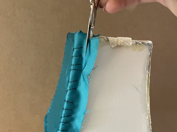

    • Use sewing scissors to trim the excess fabric from the edges. Get close to the stitches, but be careful not to cut one!
    • This will make repeating step 6 on all sides easier.
    • Trim any excess thread tails from the knot ends, on the inside of the shade, but do not cut the knots off.

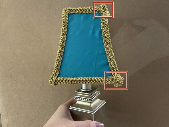

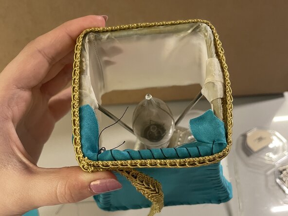

    • Measure out the necessary lengths of trim.
    • Cut the top and bottom trim long enough to wrap completely around the lamp, with the ends meeting at one corner. For the side trims, leave about 1 inch of extra length on both the top and bottom edges so you can fold and finish them neatly.
    • Heat the hot glue gun and use it to glue the top and bottom trims first.
    • Careful! It's hot and it's sticky. Use caution to not burn yourself.
    • Apply a thin line of glue horizontally over your stitches. Continue gluing along the edge until the end of the trim meets the starting point.
    • Press the trim onto the glue so it fully covers the stitches. Hold it in place for a few seconds, or use clips if you want to avoid burning your fingers.
    • If you apply too much glue, it may leak out of the side of the trim and be visible on your fabric.
  9. How to Create and Replace a Lampshade: crwdns2935265:09crwdnd2935265:01crwdnd2935265:01crwdne2935265:0
    • Start attaching the side trims.
    • Apply hot glue to the inside of the trim, then wrap it over the bottom edge of the frame so it grips onto the inner lip.
    • Press firmly to secure it in place.
    • Glue the side trim over the bottom trim and continue upward, covering the side stitches and overlapping the top trim. Wrap the top edge of the trim around the inner lip of the frame so it grips securely.
    • This overlap creates a clean finish by hiding the starting and ending points of the top and bottom trims.
    • Repeat this process for each side of the lamp.
