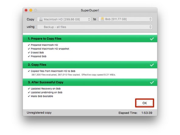

  13. How to Clone an Existing Drive: crwdns2935265:013crwdnd2935265:01crwdnd2935265:03crwdne2935265:0 How to Clone an Existing Drive: crwdns2935265:013crwdnd2935265:02crwdnd2935265:03crwdne2935265:0 How to Clone an Existing Drive: crwdns2935265:013crwdnd2935265:03crwdnd2935265:03crwdne2935265:0
    • Wait for the drive to copy (this could take several hours if you have a lot on your hard drive).
    • When prompted for registration by SuperDuper!, either choose "Register" to purchase the software or "Later" to register later.
    • After the copy is complete, click "Ok" and quit SuperDuper!
