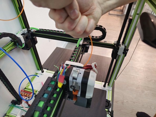

    • Load the last filament used before the jam into the printer at normal printing temperature.
    • Below are the temperature ranges for the three most common filament types:
    • PLA: 180-210C
    • PETG: 230-250C
    • ABS: 240-255C

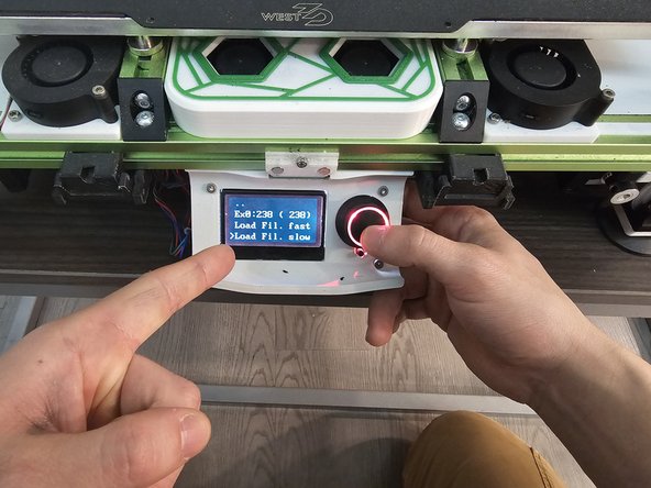

    • Extrude 5-10 mm at printing temp of plastic and then set hotend temp to 0/room temp.
    • Caution: Do not touch the hotend.
    • Wait for hot end temp to drop to room temp.

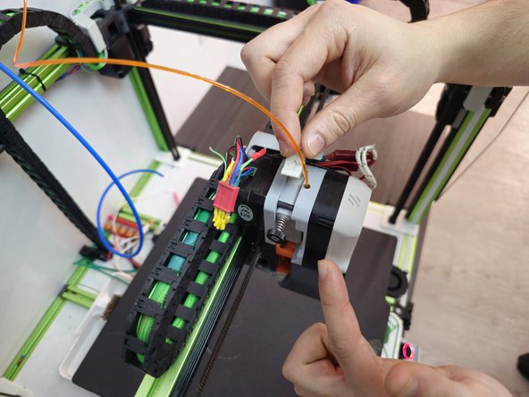

    • Remove all tension on extruder arm (the part that clamps to the filament to feed into printer).

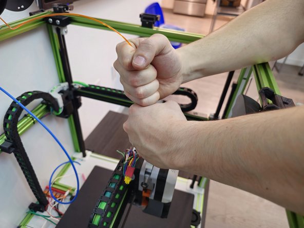

    • Pull te filament out of the hotend.
    • This may require some force.
    • This is commonly referred to as a “cold pull” and the goal is to remove debris that may be stuck in the nozzle.
    • Repeat the previous steps one to two times.

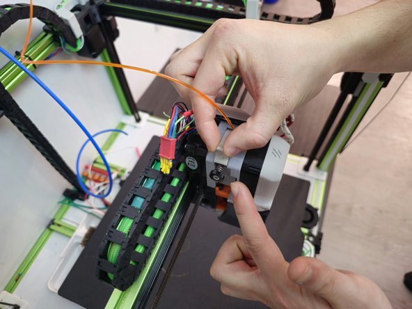

    • Retension the extruder arm and set the hotend to the printing temp of material.
    • Extrude the material and note the behavior of the plastic as it exits the hotend.
    • Material should flow relatively straight down. Sharp curling as it exits the hotend may indicate that the jam has not been cleared.
