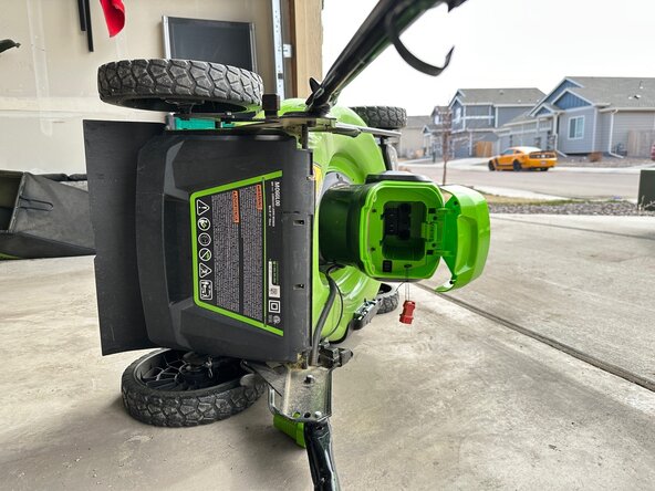

    • Remove battery and safety key.
    • Position the lawnmower on its side. Ensure the working surface is level and firm.
