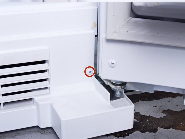

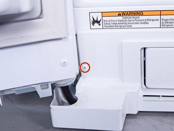

  5. How to Clean the Condenser Coils in your Whirlpool Refrigerator, Unfasten the front panel: crwdns2935265:05crwdnd2935265:01crwdnd2935265:03crwdne2935265:0 How to Clean the Condenser Coils in your Whirlpool Refrigerator, Unfasten the front panel: crwdns2935265:05crwdnd2935265:02crwdnd2935265:03crwdne2935265:0 How to Clean the Condenser Coils in your Whirlpool Refrigerator, Unfasten the front panel: crwdns2935265:05crwdnd2935265:03crwdnd2935265:03crwdne2935265:0
    • Remove the screw(s) securing the front panel.
  6. How to Clean the Condenser Coils in your Whirlpool Refrigerator, Remove the front panel: crwdns2935265:06crwdnd2935265:01crwdnd2935265:03crwdne2935265:0 How to Clean the Condenser Coils in your Whirlpool Refrigerator, Remove the front panel: crwdns2935265:06crwdnd2935265:02crwdnd2935265:03crwdne2935265:0 How to Clean the Condenser Coils in your Whirlpool Refrigerator, Remove the front panel: crwdns2935265:06crwdnd2935265:03crwdnd2935265:03crwdne2935265:0
    • Pull the front panel straight off the chassis and remove it.
    • You may have to slightly open the water filter door to remove the front panel completely.

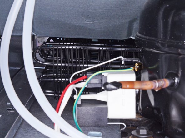

  7. How to Clean the Condenser Coils in your Whirlpool Refrigerator, Vacuum the condenser coils: crwdns2935265:07crwdnd2935265:01crwdnd2935265:02crwdne2935265:0 How to Clean the Condenser Coils in your Whirlpool Refrigerator, Vacuum the condenser coils: crwdns2935265:07crwdnd2935265:02crwdnd2935265:02crwdne2935265:0
    • Vacuum any dust or debris clinging to the black condenser coils.

Thanks for this, step 5 helped out a lot. I do have to say it is very frustrating trying to clean the coils on this model. The coils have that ‘V’ pattern all the way back which makes it really difficult to get a brush through. You almost need some type of access through the side to do this properly.
Kurt R - crwdns2934203:0crwdne2934203:0
A genius idea to make sure the appliance has a shorter life, make sure there is no way to clean the coils. Whirlpool why dont you make a video showing how to clean the coils!!! LOL
Gary Bostow - crwdns2934203:0crwdne2934203:0
Leaf blower works great!!!
