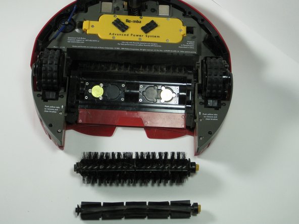

  7. How to Clean iRobot Roomba 4100 Brushes, Flexible Rubber Brush: crwdns2935265:07crwdnd2935265:01crwdnd2935265:01crwdne2935265:0
    • Set the brush guard aside.
    • The flexible rubber brush is the smooth, all-rubber brush that is closest to the yellow battery.
  8. How to Clean iRobot Roomba 4100 Brushes: crwdns2935265:08crwdnd2935265:01crwdnd2935265:02crwdne2935265:0 How to Clean iRobot Roomba 4100 Brushes: crwdns2935265:08crwdnd2935265:02crwdnd2935265:02crwdne2935265:0
    • Remove the flexible rubber brush by grabbing it and pulling it up and out of the Roomba.
    • For reassembly, orient the Roomba with the battery closest to you:
    • First, insert the black end of the flexible rubber brush into the black square opening on the right side.
    • Second, lay the flexible rubber brush back into place.

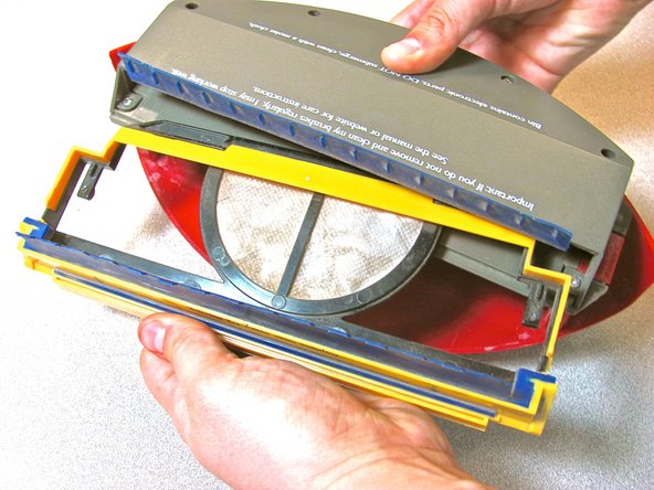

  11. How to Clean iRobot Roomba 4100 Brushes: crwdns2935265:011crwdnd2935265:01crwdnd2935265:03crwdne2935265:0 How to Clean iRobot Roomba 4100 Brushes: crwdns2935265:011crwdnd2935265:02crwdnd2935265:03crwdne2935265:0 How to Clean iRobot Roomba 4100 Brushes: crwdns2935265:011crwdnd2935265:03crwdnd2935265:03crwdne2935265:0
    • Flip the back piece over in your hand.
    • Using your other hand, grab the yellow tab and pull it away from the back piece.

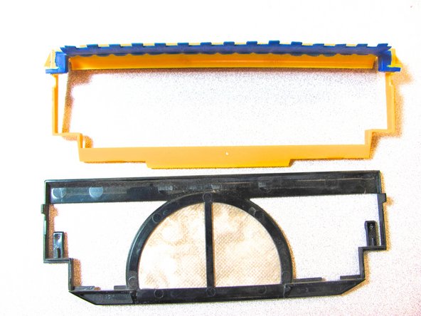

  12. How to Clean iRobot Roomba 4100 Brushes: crwdns2935265:012crwdnd2935265:01crwdnd2935265:03crwdne2935265:0 How to Clean iRobot Roomba 4100 Brushes: crwdns2935265:012crwdnd2935265:02crwdnd2935265:03crwdne2935265:0 How to Clean iRobot Roomba 4100 Brushes: crwdns2935265:012crwdnd2935265:03crwdnd2935265:03crwdne2935265:0
    • Pinch the black plastic of the filter and pull it away from the yellow filter holder.
  13. How to Clean iRobot Roomba 4100 Brushes, How to Clean iRobot Roomba 4100 Brushes: crwdns2935265:013crwdnd2935265:01crwdnd2935265:01crwdne2935265:0
    • Remove the particle bin from the back of the Roomba.

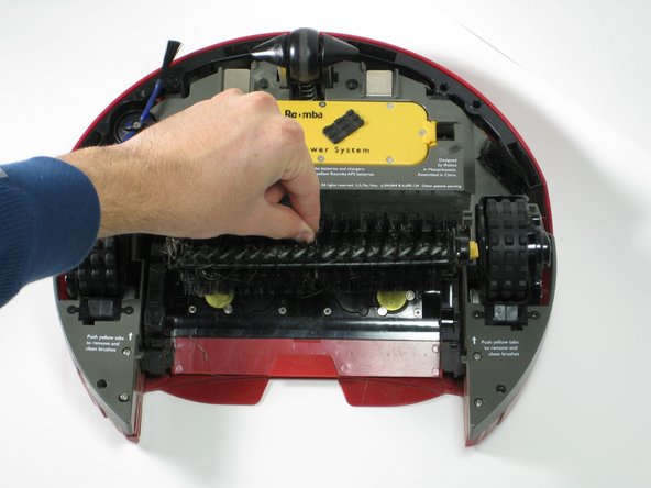

    • Pop out the two yellow tabs to remove the brush cover.
  15. How to Clean iRobot Roomba 4100 Brushes: crwdns2935265:015crwdnd2935265:01crwdnd2935265:03crwdne2935265:0 How to Clean iRobot Roomba 4100 Brushes: crwdns2935265:015crwdnd2935265:02crwdnd2935265:03crwdne2935265:0 How to Clean iRobot Roomba 4100 Brushes: crwdns2935265:015crwdnd2935265:03crwdnd2935265:03crwdne2935265:0
    • Remove the two brushes from the iRobot Roomba 1400.
    • The brushes will easily pop in and out when cleaning them.
    • Completely remove any debris or tangled hair around the brushes when cleaning.
