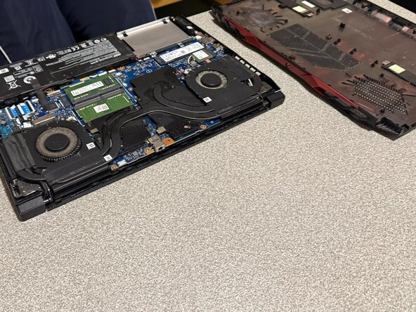

    • Remove all the screws from the bottom cover using a Phillips screwdriver.
  5. How to Clean an Acer Nitro 5 AN515-55-55M1 Fan: crwdns2935265:05crwdnd2935265:01crwdnd2935265:02crwdne2935265:0 How to Clean an Acer Nitro 5 AN515-55-55M1 Fan: crwdns2935265:05crwdnd2935265:02crwdnd2935265:02crwdne2935265:0
    • Carefully pop the panel off with your fingers or a spudger.
  6. How to Clean an Acer Nitro 5 AN515-55-55M1 Fan: crwdns2935265:06crwdnd2935265:01crwdnd2935265:01crwdne2935265:0
    • Use short compressed air bursts to blow out dust or a small brush to loosen clogged dirt.
  7. How to Clean an Acer Nitro 5 AN515-55-55M1 Fan: crwdns2935265:07crwdnd2935265:01crwdnd2935265:01crwdne2935265:0
    • Wipe away any remaining dust around the fan and heat sink with a microfiber cloth.
    • Do not wet the cloth as it can damage the laptop components.
  8. How to Clean an Acer Nitro 5 AN515-55-55M1 Fan: crwdns2935265:08crwdnd2935265:01crwdnd2935265:01crwdne2935265:0
    • Make sure everything is clean before reassembling the laptop.
    • Make sure all of the dust and debris is gone before reassembly.
