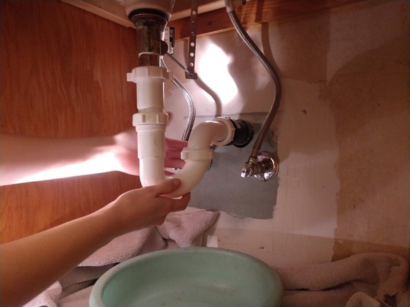

    • Place towels around the area.
    • Place a bucket or bowl under the P-trap.
  3. How to Clean a PVC P-Trap: crwdns2935265:03crwdnd2935265:01crwdnd2935265:03crwdne2935265:0 How to Clean a PVC P-Trap: crwdns2935265:03crwdnd2935265:02crwdnd2935265:03crwdne2935265:0 How to Clean a PVC P-Trap: crwdns2935265:03crwdnd2935265:03crwdnd2935265:03crwdne2935265:0

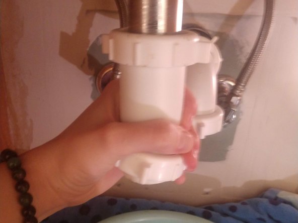

    • Loosen the coupling nuts from the pipe above and below the drain using a wrench.
  4. How to Clean a PVC P-Trap: crwdns2935265:04crwdnd2935265:01crwdnd2935265:03crwdne2935265:0 How to Clean a PVC P-Trap: crwdns2935265:04crwdnd2935265:02crwdnd2935265:03crwdne2935265:0 How to Clean a PVC P-Trap: crwdns2935265:04crwdnd2935265:03crwdnd2935265:03crwdne2935265:0

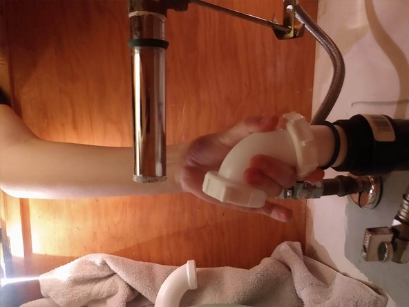

    • Loosen the nuts on the upper and lower pipe and disconnect the the P-trap.
    • Remove the U shape from the piping, and dump any water into bowl.
    • Pull the PVC pipe that is connected to the wall out horizontally.
    • Pull the PVC pipe closest to the drain in a downward motion.

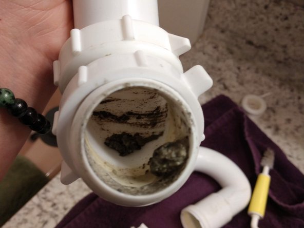

    • Empty any water into a bucket.
    • Clear out the interior of the PVC pipe using a bottle brush or wire, spinning and moving the brush through the pipe.
    • Remove any soap scum.
    • This may appear black and sludge-like.
