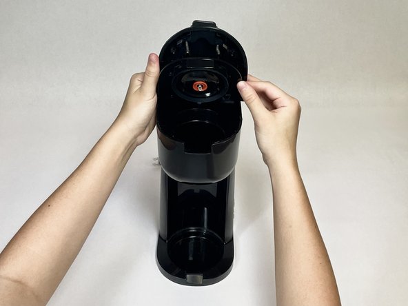

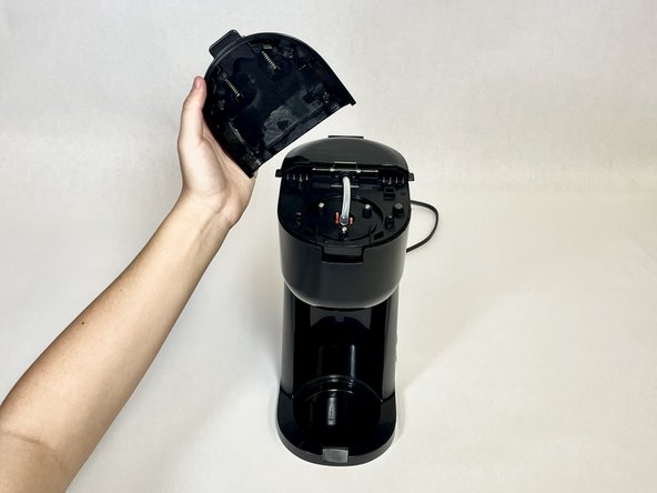

    • Open the top of the coffee maker.
  2. How to Clean a Mainstays Coffee Maker Water Tube: crwdns2935265:02crwdnd2935265:01crwdnd2935265:02crwdne2935265:0 How to Clean a Mainstays Coffee Maker Water Tube: crwdns2935265:02crwdnd2935265:02crwdnd2935265:02crwdne2935265:0

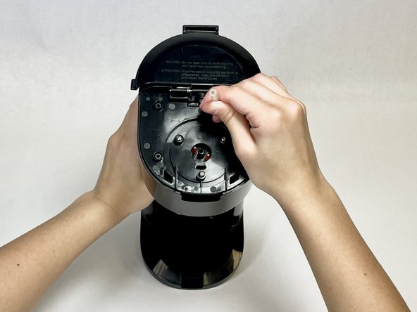

    • Use a Phillips screwdriver to remove the four 6 mm screws surrounding the puncturing needle.

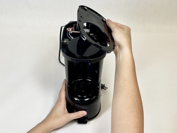

  3. How to Clean a Mainstays Coffee Maker Water Tube: crwdns2935265:03crwdnd2935265:01crwdnd2935265:03crwdne2935265:0 How to Clean a Mainstays Coffee Maker Water Tube: crwdns2935265:03crwdnd2935265:02crwdnd2935265:03crwdne2935265:0 How to Clean a Mainstays Coffee Maker Water Tube: crwdns2935265:03crwdnd2935265:03crwdnd2935265:03crwdne2935265:0
    • Press down on the brew chamber release button and remove the backing piece.

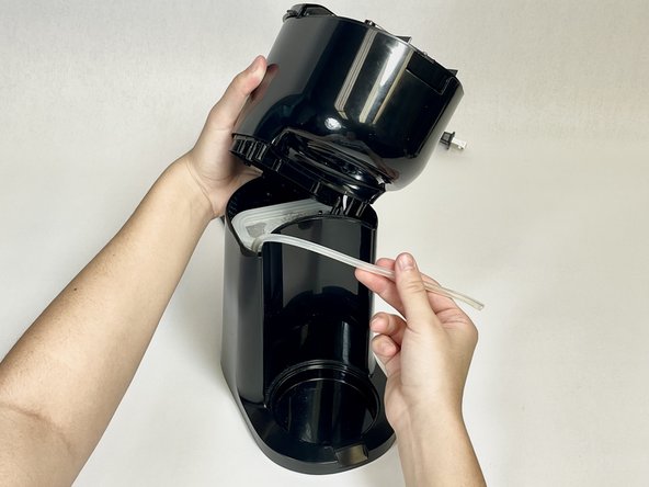

  4. How to Clean a Mainstays Coffee Maker Water Tube: crwdns2935265:04crwdnd2935265:01crwdnd2935265:03crwdne2935265:0 How to Clean a Mainstays Coffee Maker Water Tube: crwdns2935265:04crwdnd2935265:02crwdnd2935265:03crwdne2935265:0 How to Clean a Mainstays Coffee Maker Water Tube: crwdns2935265:04crwdnd2935265:03crwdnd2935265:03crwdne2935265:0
    • Disconnect the water tube from where it is connected to the needle.

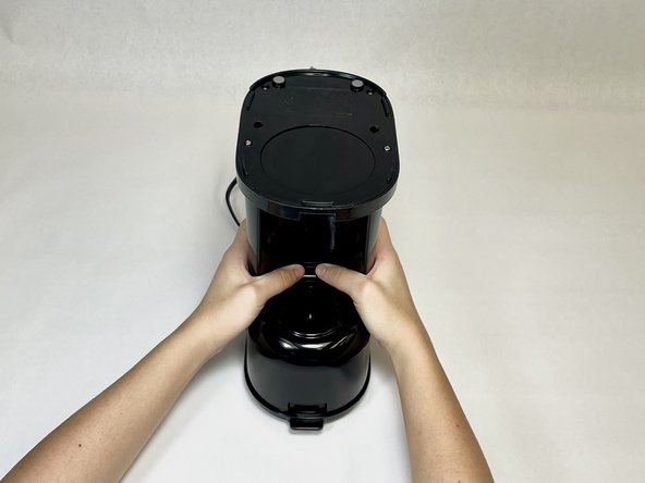

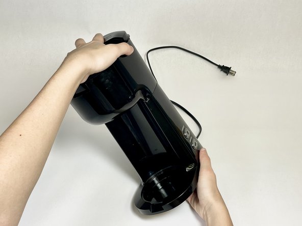

    • Flip the coffee maker upside down.
  6. How to Clean a Mainstays Coffee Maker Water Tube: crwdns2935265:06crwdnd2935265:01crwdnd2935265:02crwdne2935265:0 How to Clean a Mainstays Coffee Maker Water Tube: crwdns2935265:06crwdnd2935265:02crwdnd2935265:02crwdne2935265:0

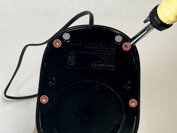

    • Use a Phillips screwdriver to remove the four 7 mm screws on the base of the coffee maker.
  7. How to Clean a Mainstays Coffee Maker Water Tube: crwdns2935265:07crwdnd2935265:01crwdnd2935265:03crwdne2935265:0 How to Clean a Mainstays Coffee Maker Water Tube: crwdns2935265:07crwdnd2935265:02crwdnd2935265:03crwdne2935265:0 How to Clean a Mainstays Coffee Maker Water Tube: crwdns2935265:07crwdnd2935265:03crwdnd2935265:03crwdne2935265:0
    • Remove the base.

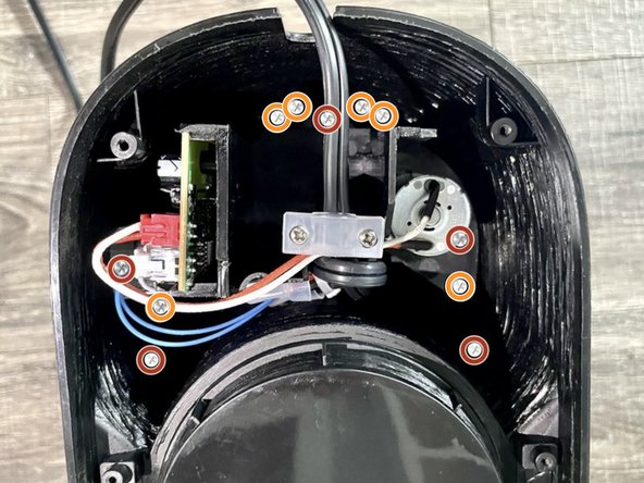

  8. How to Clean a Mainstays Coffee Maker Water Tube: crwdns2935265:08crwdnd2935265:01crwdnd2935265:02crwdne2935265:0 How to Clean a Mainstays Coffee Maker Water Tube: crwdns2935265:08crwdnd2935265:02crwdnd2935265:02crwdne2935265:0
    • Use an 8" Phillips screwdriver to remove the five internal 14 mm screws from within the coffee maker.
    • Use an 8" Phillips screwdriver to remove the six internal 7 mm screws from within the coffee maker.
    • The second image shows the approximate placement of the screws; you may have to reach inside and move wires to locate and access all eleven screws.

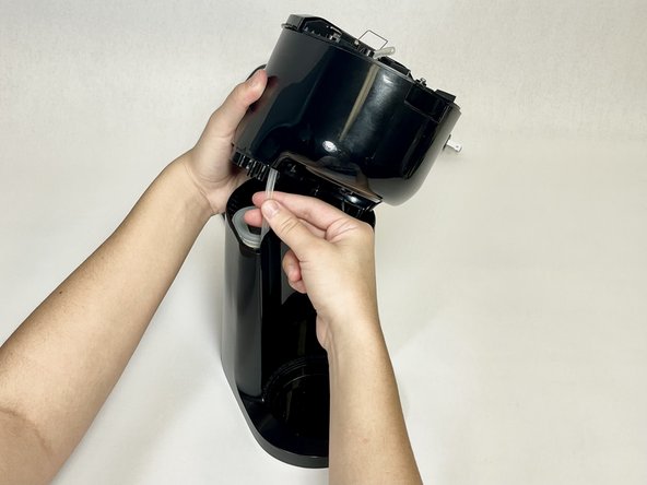

  10. How to Clean a Mainstays Coffee Maker Water Tube: crwdns2935265:010crwdnd2935265:01crwdnd2935265:03crwdne2935265:0 How to Clean a Mainstays Coffee Maker Water Tube: crwdns2935265:010crwdnd2935265:02crwdnd2935265:03crwdne2935265:0 How to Clean a Mainstays Coffee Maker Water Tube: crwdns2935265:010crwdnd2935265:03crwdnd2935265:03crwdne2935265:0

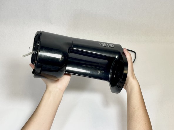

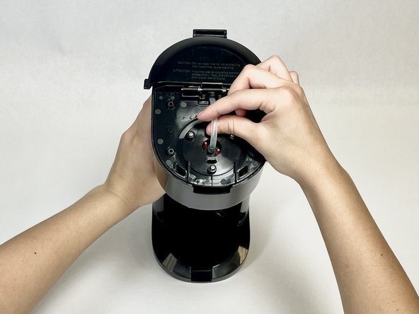

    • Pull the disconnected end of the water tube out of the top of the coffee maker.

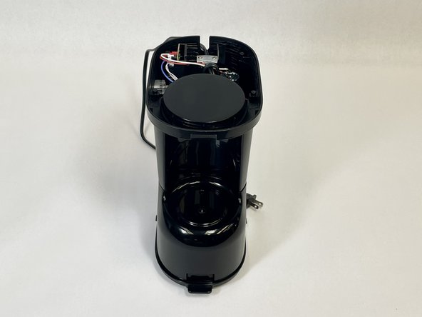

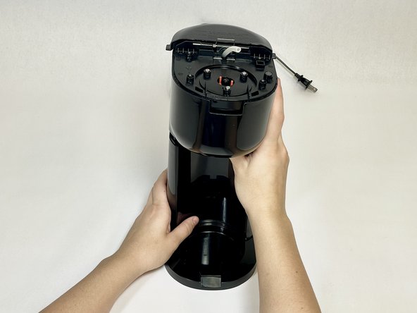

    • Move the top of the coffee maker out of the way so that you can reach into the base.
    • You may wish to put something under the top to support it.

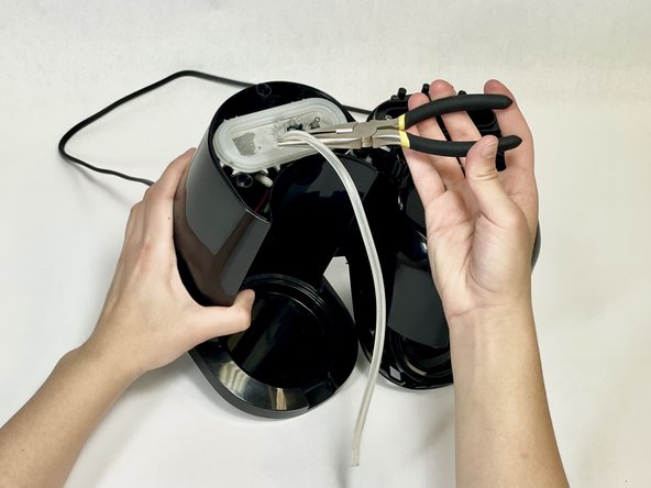

  12. How to Clean a Mainstays Coffee Maker Water Tube: crwdns2935265:012crwdnd2935265:01crwdnd2935265:03crwdne2935265:0 How to Clean a Mainstays Coffee Maker Water Tube: crwdns2935265:012crwdnd2935265:02crwdnd2935265:03crwdne2935265:0 How to Clean a Mainstays Coffee Maker Water Tube: crwdns2935265:012crwdnd2935265:03crwdnd2935265:03crwdne2935265:0

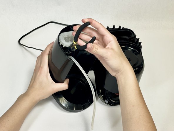

    • Identify where the water tube is connected at the other end.
    • Use pliers or your hand to disconnect it.
    • If you choose to use pliers, take caution not to puncture the tube.
  13. How to Clean a Mainstays Coffee Maker Water Tube: crwdns2935265:013crwdnd2935265:01crwdnd2935265:03crwdne2935265:0 How to Clean a Mainstays Coffee Maker Water Tube: crwdns2935265:013crwdnd2935265:02crwdnd2935265:03crwdne2935265:0 How to Clean a Mainstays Coffee Maker Water Tube: crwdns2935265:013crwdnd2935265:03crwdnd2935265:03crwdne2935265:0

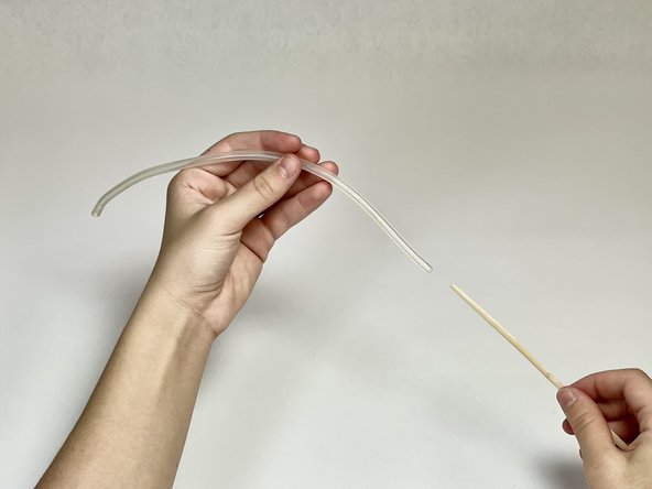

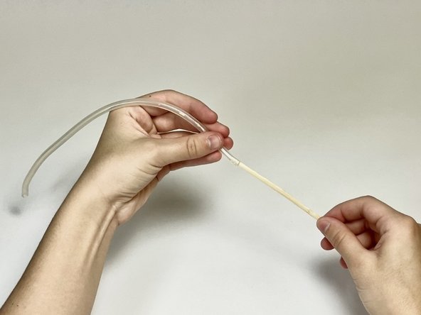

    • Locate any blockages in the water tube and use your chosen tool (chenille stick, wooden dowel, toothpick, etc.) to push them out.
    • If the tube looks cloudy, use a chenille stick to break up the buildup.
  14. How to Clean a Mainstays Coffee Maker Water Tube: crwdns2935265:014crwdnd2935265:01crwdnd2935265:01crwdne2935265:0
    • Rinse any remaining debris out of the tube.
    • Depending on what tool you chose to use in the previous step, particles from said tool may need to be rinsed out as well.
