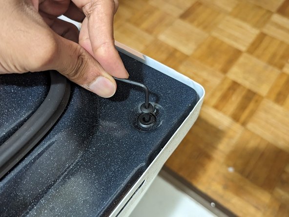

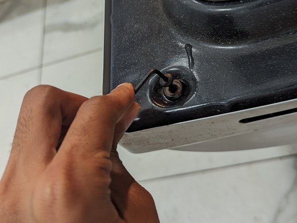

    • Open the oven door.
    • Use the the 3/32" Allen wrench to remove the two 8mm x 2mm M2 hex screws.
    • When both screws are removed, the door will separate. Make sure to hold it so it doesn't fall.

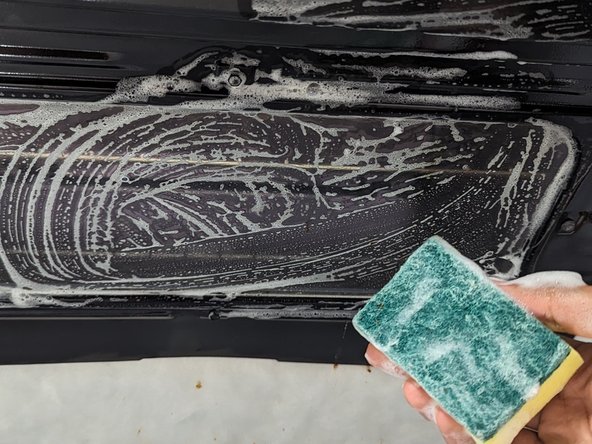

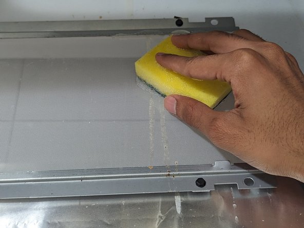

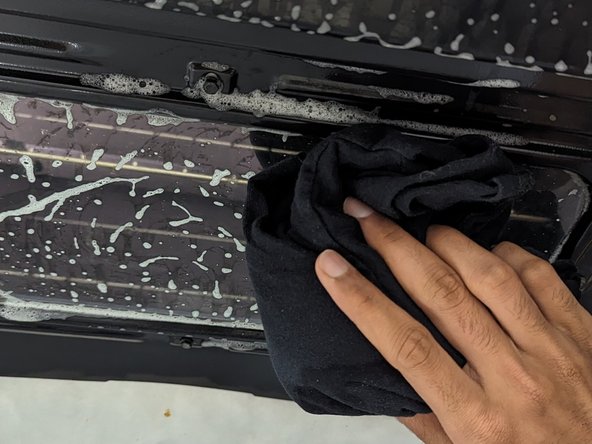

    • The first glass panel is located on the bottom part as shown in the image.
    • Dip the soft sponge in the soapy water and gently rub the glass until there is no grease or spots.
    • Use a clean cloth to wipe the glass off so there are no streaks.

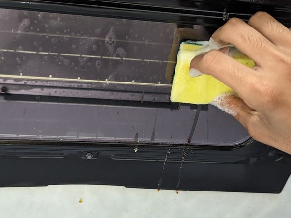

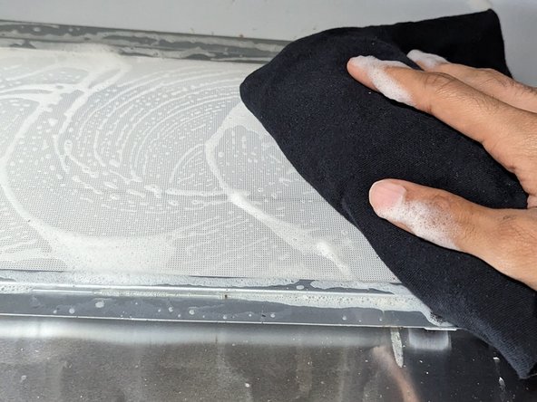

    • The second glass panel is located on the top.
    • Use the sponge to clean the glass with a soap solution and soft clean cloth to wipe the glass off.
