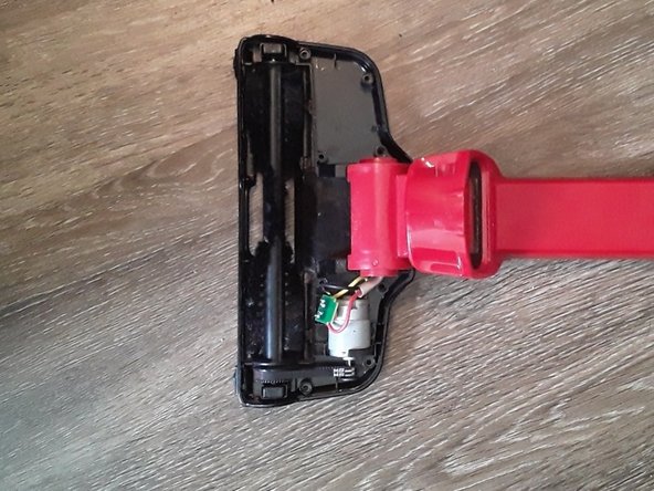

    • Use a Phillips head screwdriver to remove eight screws.
  3. How to Clean a Dirt Devil Vacuum Cleaner Roller Brush: crwdns2935265:03crwdnd2935265:01crwdnd2935265:01crwdne2935265:0
    • Disassemble the vacuum head and pop out your roller brush.

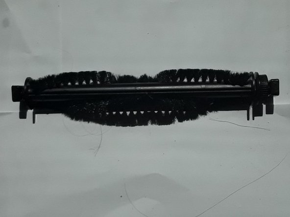

  4. How to Clean a Dirt Devil Vacuum Cleaner Roller Brush: crwdns2935265:04crwdnd2935265:01crwdnd2935265:01crwdne2935265:0
    • Cut the ends with scissors.
    • Cover the floor with papers to prevent debris and hair from falling on the ground.
  5. How to Clean a Dirt Devil Vacuum Cleaner Roller Brush: crwdns2935265:05crwdnd2935265:01crwdnd2935265:01crwdne2935265:0
    • Use a brush to clean the roller brush.

    • Put the rectangular part on both sides.
  7. How to Clean a Dirt Devil Vacuum Cleaner Roller Brush: crwdns2935265:07crwdnd2935265:01crwdnd2935265:02crwdne2935265:0 How to Clean a Dirt Devil Vacuum Cleaner Roller Brush: crwdns2935265:07crwdnd2935265:02crwdnd2935265:02crwdne2935265:0
    • Check if the belt is attached.
    • Check if the motor part is well inserted with the belt attached to the roller brush.
    • Make sure the shape of the motor fits to prevent it from falling.

Might be helpful if you showed where all 8 screws are seeing how I can only find 6 and cannot get it open!
Crystal - crwdns2934203:0crwdne2934203:0
in the front there are to wheels, pop them out and you will see the other 2 screws
Mario Lore -
There must be different versions. Mine has eight very obvious screws and looks like the one in the guide. The front was still stuck, and I thought there might be screws under the wheels, but there were not. There were four very stubborn plastic clips at the front. I ended up running a prying tool between the two parts and getting the clips free.
Obviously, the comment I'm replying to was from a long time ago, but maybe I can help someone else.
Christopher Pedersen -
my power express lite only has 6 screws as well. I cannot get it open, I'm afraid it will break if I keep prying.
