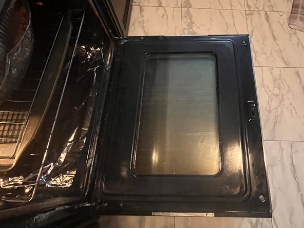

    • Open the oven door until it lays flat.

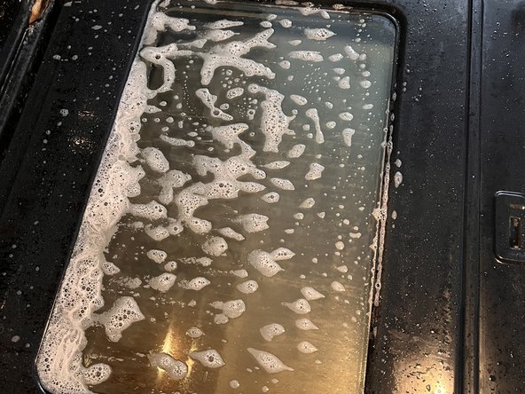

  3. How to Clean a Clouded Glass Oven Door: crwdns2935265:03crwdnd2935265:01crwdnd2935265:03crwdne2935265:0 How to Clean a Clouded Glass Oven Door: crwdns2935265:03crwdnd2935265:02crwdnd2935265:03crwdne2935265:0 How to Clean a Clouded Glass Oven Door: crwdns2935265:03crwdnd2935265:03crwdnd2935265:03crwdne2935265:0

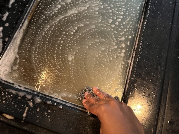

    • Pour the mix on the open oven glass door, making sure to cover the entire area.
    • Leave it for about 45 minutes
    • You might notice the mixture bubbling and rising. Wait until it simmers down but continues to bubble.

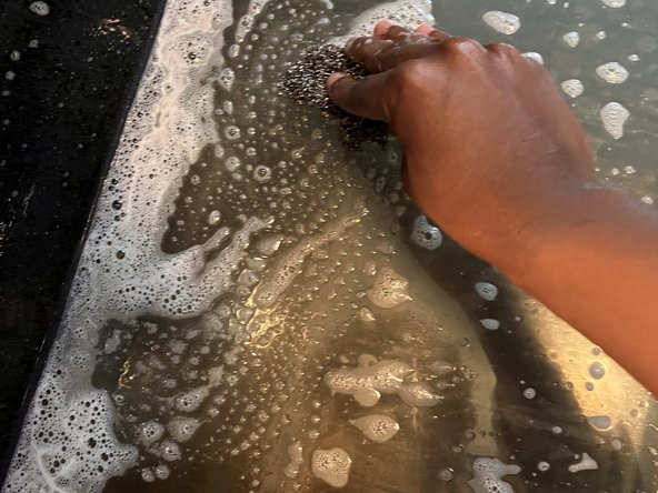

  4. How to Clean a Clouded Glass Oven Door: crwdns2935265:04crwdnd2935265:01crwdnd2935265:03crwdne2935265:0 How to Clean a Clouded Glass Oven Door: crwdns2935265:04crwdnd2935265:02crwdnd2935265:03crwdne2935265:0 How to Clean a Clouded Glass Oven Door: crwdns2935265:04crwdnd2935265:03crwdnd2935265:03crwdne2935265:0
    • 30 minutes - 1 hour later, use a stainless steel sponge to scrub the glass door. The mix aids in loosening deep stains.
    • Keep scrubbing until the surface feels clean and the stains are gone.
    • If your arm is getting tried from the intense scrubbing, take a break!

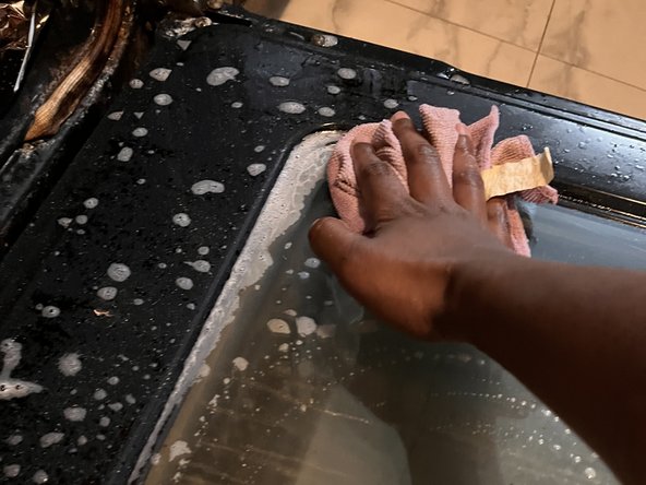

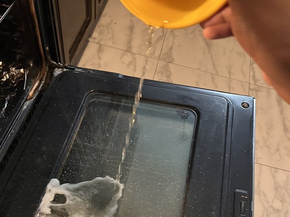

  5. How to Clean a Clouded Glass Oven Door: crwdns2935265:05crwdnd2935265:01crwdnd2935265:03crwdne2935265:0 How to Clean a Clouded Glass Oven Door: crwdns2935265:05crwdnd2935265:02crwdnd2935265:03crwdne2935265:0 How to Clean a Clouded Glass Oven Door: crwdns2935265:05crwdnd2935265:03crwdnd2935265:03crwdne2935265:0
    • Once the stains are gone, use a towel to clean off the residue and remaining mixture.
    • Rinse the residue off the towel and repeat until the door is entirely clean of dirt and mixture residue.

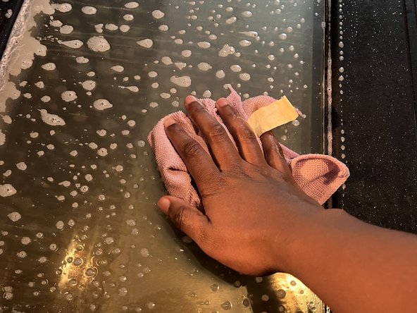

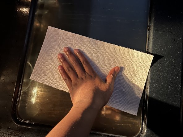

  6. How to Clean a Clouded Glass Oven Door: crwdns2935265:06crwdnd2935265:01crwdnd2935265:03crwdne2935265:0 How to Clean a Clouded Glass Oven Door: crwdns2935265:06crwdnd2935265:02crwdnd2935265:03crwdne2935265:0 How to Clean a Clouded Glass Oven Door: crwdns2935265:06crwdnd2935265:03crwdnd2935265:03crwdne2935265:0
    • Add soap and water to a sponge and gently clean the oven door.
    • Use a damp towel to wipe off the soap, then use a paper towel to thoroughly dry the oven glass door, ensuring there is no leftover water.
Enjoy you clean glass oven door!
