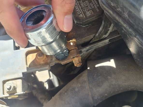

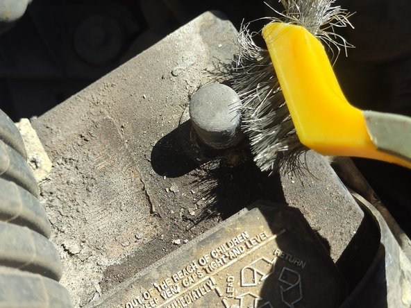

  3. How to Clean Your Car Battery Terminals: crwdns2935265:03crwdnd2935265:01crwdnd2935265:03crwdne2935265:0 How to Clean Your Car Battery Terminals: crwdns2935265:03crwdnd2935265:02crwdnd2935265:03crwdne2935265:0 How to Clean Your Car Battery Terminals: crwdns2935265:03crwdnd2935265:03crwdnd2935265:03crwdne2935265:0
    • Spray the battery cleaner on the terminals and wait a few minutes. Use the wire brush or battery terminal brush to thoroughly scrub corrosion and debris from the metal until the terminals are clean and shiny.
    • Clean inside the battery cable heads which connect to the battery terminals as well.
    • Pay special attention to any visible corrosion or white or greenish deposits. Remove any stubborn corrosion or buildup.

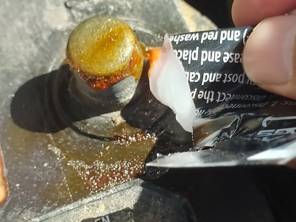

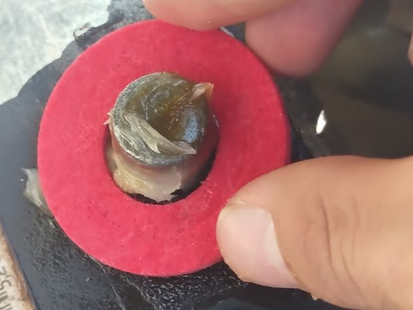

  4. How to Clean Your Car Battery Terminals: crwdns2935265:04crwdnd2935265:01crwdnd2935265:03crwdne2935265:0 How to Clean Your Car Battery Terminals: crwdns2935265:04crwdnd2935265:02crwdnd2935265:03crwdne2935265:0 How to Clean Your Car Battery Terminals: crwdns2935265:04crwdnd2935265:03crwdnd2935265:03crwdne2935265:0
    • Spray CPC on the battery terminals and battery cable heads.
    • DO NOT ingest or get it into your eyes.
    • Apply dielectric grease to battery terminals generously.
    • Coat the washers in dielectric grease if there is any left.
    • Slip washers onto the battery terminals.

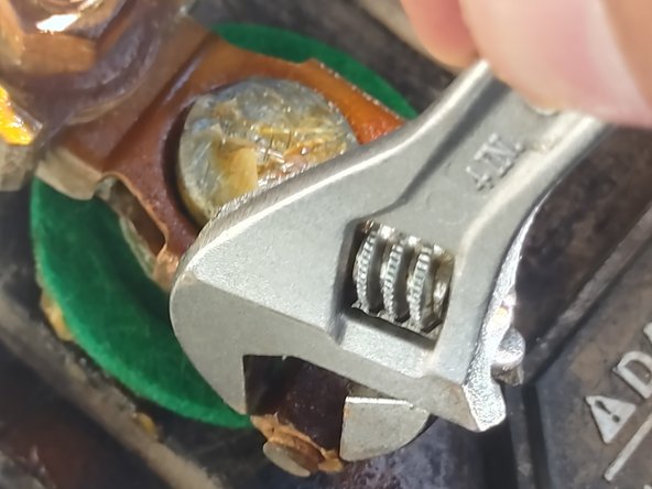

  5. How to Clean Your Car Battery Terminals: crwdns2935265:05crwdnd2935265:01crwdnd2935265:02crwdne2935265:0 How to Clean Your Car Battery Terminals: crwdns2935265:05crwdnd2935265:02crwdnd2935265:02crwdne2935265:0
    • Use an adjustable wrench to reconnect the positive (+) cable to the positive (+) battery terminal and tighten it securely.
    • Use an adjustable wrench to reconnect the negative (-) cable to the negative (-) battery terminal and tighten it securely.

  2. Apply Terminal Protection (OPTIONAL):
    • Apply a thin layer of battery terminal grease or petroleum jelly to both the positive and negative terminals. This helps prevent corrosion on the terminals and ensures good electrical contact.
    • After application of grease, slide on anti corrosion washers over battery terminals.
